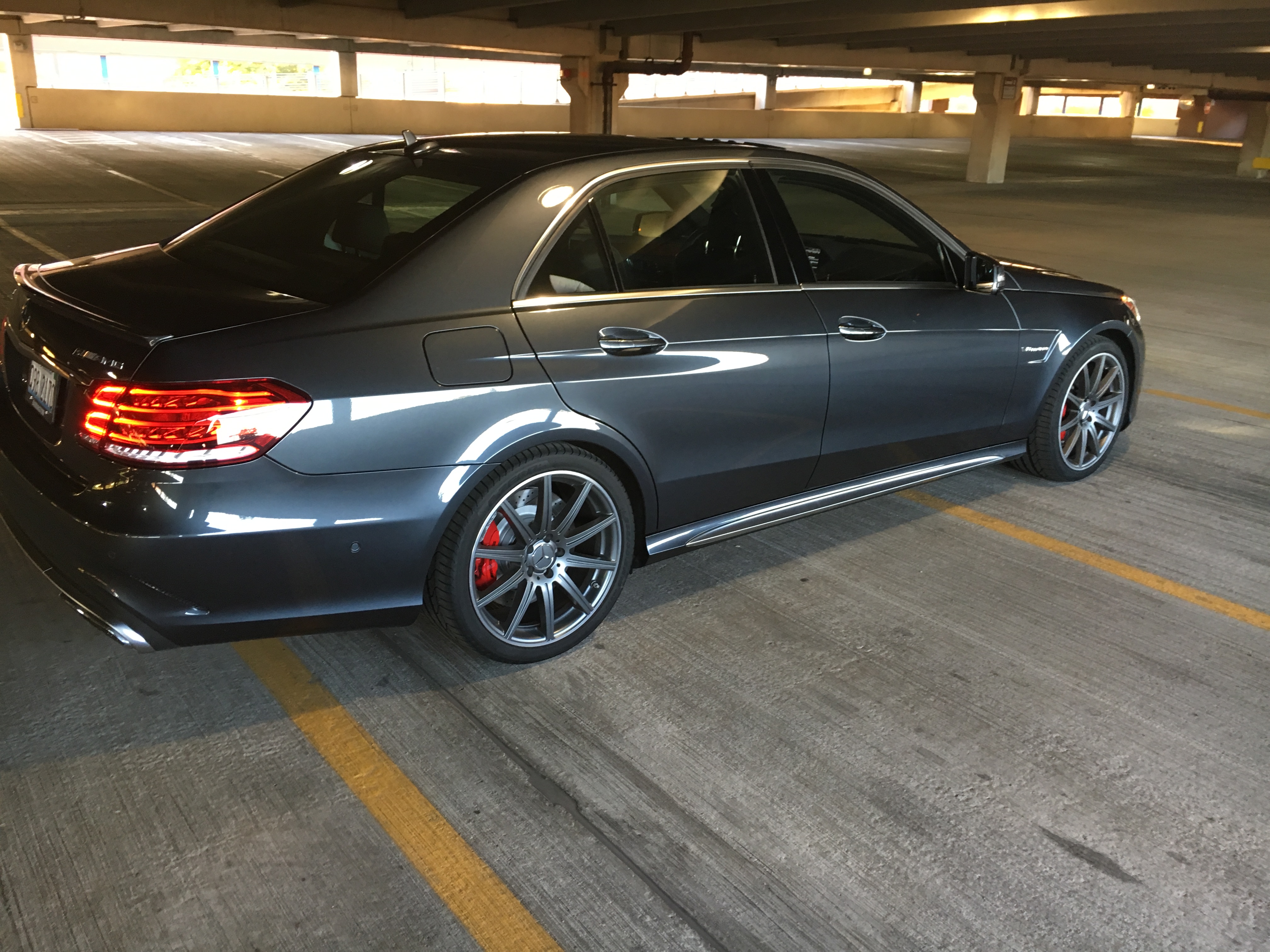

any pics of your e63s, beast of a car

Morph - sorry man been swamped lately with work and fam stuff and slow to get back here... so here's a couple pics of my 15' E63 S (just because you asked
Great car of course and scarry fast and huge size, its really amazing, but I still love driving my C32 such a fun car.....going to get the bent rod situation addressed by doing an engine swap with a SRT6 / M112k motor with 90k miles which will hopefully be done in Feb.
Funny but even with a bent rod I still drive the c32 and with Continental DWS tires on it the car drives awesome in Chicago winter and starts up every time even in -10F weather like we had last week. Great cars those C32s..... to me its worth every penny for the engine swap to get her back to normal!!!!
happy holidays, merry xmas and happy new year.
