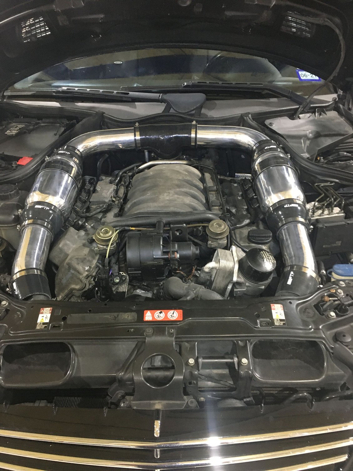

Any C55 members have FTP or Needswing intakes, with dyno results? I just installed a FTP, it weighs in at 11lbs, stock air box was 8ish I think. FTP uses the tiny spectra air filters. Will test the intake air temps later today to compare with the set up on my 210 E55. My custom intake weighs 5lbs with the mass airflow still attached.
On the hottest day of the year, my intake temps cruising were 12° above ambient. I know C55s don’t have the room to run the same type of filter I run. But I am sure that is a better way to make an intake for C55s.

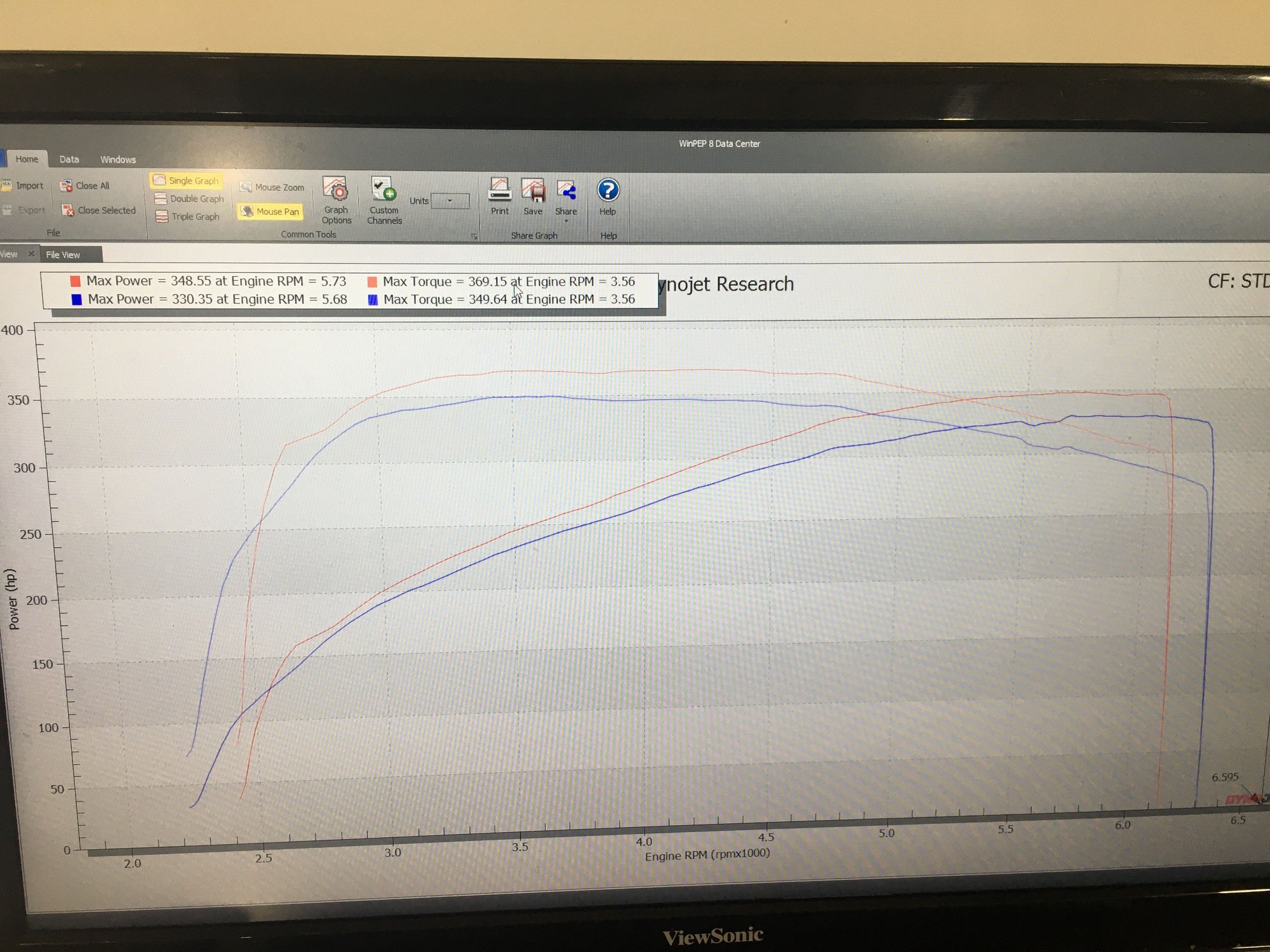

Its on the dyno pic, 330whp with headers and a tune to 348whp with the intake. Also gained 20lb ft of torque.

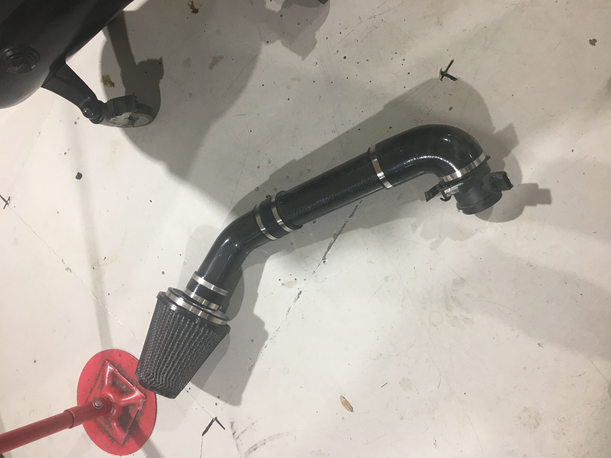

I just wanted this info out there, because i feel like for C55 owners the dual intakes are junk. We arent dynoing this car but I will be recording the IATs compared to me E55. I built my intake for 350$ super easy.

It did get retuned. It leaned the car out to 13.3 AFR. It also has the elbow mod from Speed43. I haven’t cut out the square grating in the MAF. Going to try and dyno it this week with the flex fuel system I have now. My 2000 e55 made 350whp with tune, headers and e70

Data.
102° Round Rock Texas 4:25pm
Let both cars my E55 custom intake, and C55 with FTP intake idle to 140° IAT
Started out my drive cruising at 50 mph
C55 stayed around 117° to 118°
E55 stayed around 109° to 111°
WOT
C55 would drop down to 113°
E55 would drop down to 107°
After test drive let both cars idle for 1min
C55 went up to 135°
E55 went up to 124°
Would be nice to see someone test Needswings intake or test the factory air box, and Speed43 modified air box.
Hope this helps anyone with a C55
We did not get to dyno this C55

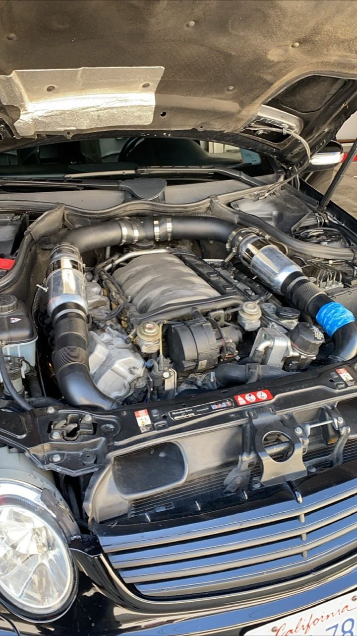

Awesome info on the IAT’s, I could test mine as well and report back, although I don’t think I’ll be able to replicate the Texas heat! I have the stock intake w/AEM dry flow like stated above and the MAF screen deleted.
Part of the aftermarket dual intake designs that seem inefficient to me, is the fact that they are metal and sitting right above header space on both sides. This seems like without a thermal barrier of some kind they won’t stay as cool as the stock intake just based on material/position alone.

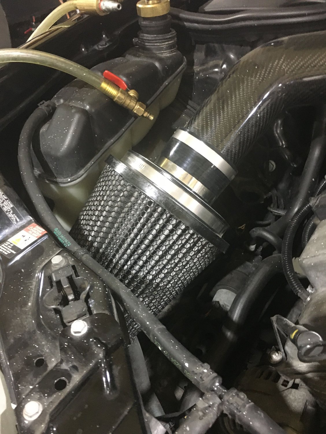

3.5in carbon fiber, first set up was AEM filter, then a larger AFE blue filter, now its a Rotofab zl1 6in air filter and K tuned velocity stack.
