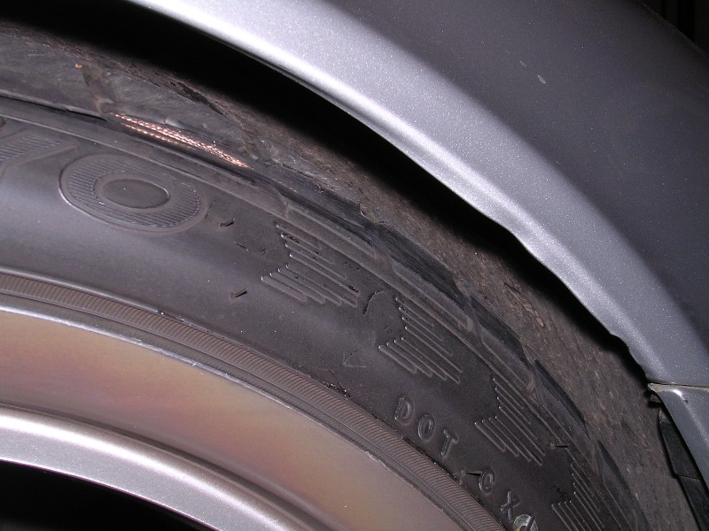

All fenders have a 90 degree or U channel bend to them to provide additonal strength to the fender's edge. Simple engineering. The rear of a C32 has an upward bend of about 30 degrees in a U channel design. The front has a simple 90 degree bend without the U channel, which is inherently weaker. The C32 has the same shape front fender as the other W203 sedans. Fender rolling is not done by MB on AMG stock cars. There is no need given the stock wheel/tire fitment. The standard fender can accomodate the wheel/tire size.
Fender rolling is required when you want to fit a much larger wheel/tire combo. The fender lip is pounded or rolled tight against itself reducing the U channel gap or bending the 90 degree edge up. In the process, the rolled area may also be pulled out towards the outside providing more interior space within the wheel well, effectively altering the shape of the fender itself.
There is a difference between factory rolling (which doesn't exist) or rolling that is done by a special division of a manufacturer, like AMG in Germany, who will customize a car to an owners desires. If a customer wants huge wheels/tires on their AMG car, as delivered or modified by AMG at their Germany location, AMG may "roll" their fenders to accomodate the request. The same with Brabus and any other aftermarket tuner wanting to provide much larger rolling stock.
Here is some proof that rolling does not exist on AMG cars delivered stock here in the States, and the poor design and quality of a MB front fender:
Attached Thumbnails Saw a C32 today with 18" Babraus rims 235/265 tires-dscn0538.jpg
ouch, i have a feeling my tires and fenders are gonna look like that if i ever go to the track without having them rolled.

The tolerances of the W203 are not as good as other european or Japanese marques. The passenger side of my car is .125" off compared to the driver's side from the hub mounting surface to the outer fender. Only happened to the passenger side. 8.5" front wheel, ET32, 235/40, 1.75" drop. 13.25" is just too low during 100% compression on my car.
With a broom stick, hold the stick vertical against the lower tire with your foot and the upper fender lip with your hand at the center of the wheel. Measure both sides of the vehicle and report if you'd like for comparison. With 8.5" wheels and an offset of 30 or 32, you may find that the tire's sidewall sticks out beyond the fender. This damage won't happen with the stock 15" ride height. Note how wimpy the angle material is. You can pull on the fender and move it considerably due to thin metal as well. As for the stock paint quality, although sprayed very well, consistant and little orange peel, just show your paint a rock and it will chip much easier than earlier MB or other manufacturer's paint. Same for the density of the windshield.
