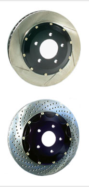

Wow, that was an amazing post amg2go, thanks for all the info. The previous owner of my C43 said he had the floating rotors put in when he replaced factory, but wasn't really sure what the benefit was, or at least he couldn't describe it to me. Seems something as easy as saying they weigh less shouldn't be too difficult. Makes me wonder if they are truly the better design, anyway to visible inspect with the wheels on?

No problem. On a floating hub the center section is physically only connected to the rest of the rotor by small screws... usually a different color even. On a standard rotor its all cast. Like these two. On the left are two floating rotors.
