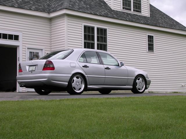

Lowered the car...finally w/pics
Took a little longer than I thought it would First time messing with a benz suspension. All done though. H&R springs with #2 pads front and rear. I'm going to replace the rear pads this weekend with #3 or #4. The car bottoms out alot with two people in the back seat. I usually have a couple people back there on weekends so it's not practical this low.
Attached Thumbnails Lowered the car...finally w/pics-1c43.jpg   Lowered the car...finally w/pics-2c43.jpg   Lowered the car...finally w/pics-3c43.jpg   Lowered the car...finally w/pics-4c43.jpg

As I'm sure your all sooooo concerned....I fixed the rubbing issue.
Ended up being from the body shop that just fixed my pass. rear quarter. The damage was minor but they must have had to re-shape the fender a tiny bit. When looking down the side of each rear quarter you could see that the repaired side sloped in about 1/4 inch towards the back of the tire. I made my own fender roller thing out of a wooden poll and some other crap. Covered the end with a rage and used some moderate/light pressure and rolled the fender edge out to where it should be. Measured both sides and they are even with no rubbing any more.
#3 or #4 pads are still going on the rear though......

Good luck with the H&R's I hate and I'm taking them off.My car rubs with the 18" mono's and #4 pads all around.However your car does look good with the drop and probably won't be as affected with rubbing issues once you use #4 pads with the stck 17" rims!

I went through a lot of springs/pads and finally found the Vogtland/#4 combo to be perfect for me with the 18" Carlsson's. Not sure if I have a good pic of the ride height... will post if I find one.

Spring pads are on their way bro. And for comparison sake, here is the Vogtland/Koni setup with #4 on all four corners:

Stance looks good, real good. I would hang on to those wheels. I had the same set for my 99' C230K. Never installed them and sold them when the car was totaled. Wish I hadn't........
