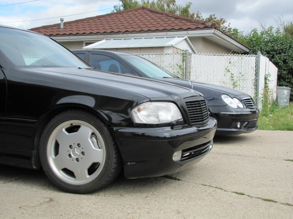

Some pictures of the two AMGs, and glimpses of the other cars in my stable too!
started tear down for paint-823ea61a-2395-461d-b5e5-9bd6b3987ebd-13669-0000165ca47f9203.jpg
started tear down for paint-711ac5f5-edac-45e0-a67f-94bca4b6c9b7-13669-0000165cbb52172f.jpg
started tear down for paint-9beb39a3-8be6-4d88-ba4d-e1c99e503fef-13669-0000165cc840f8d4.jpg
started tear down for paint-268bdc6c-013d-401e-91b8-dc34f1fe2aa9-13669-0000165ca97eeca6.jpg
started tear down for paint-24fc8d04-cc0c-4ffd-b583-47ffb10dea3a-13669-0000165cb6de5a14.jpg
started tear down for paint-9be27318-2ae8-4dba-a71d-e9aa8d8b0dfc-13669-0000165cc4200412.jpg
started tear down for paint-7a683333-9d58-4922-8ae3-ef51668e2734-13669-0000165cadd01a02.jpg
started tear down for paint-4e63a0a6-e354-4f79-beac-3ad61834e52d-13669-0000165cbf9dd596.jpg
The C43 now belongs to my parents, but I still think of it as mine! Today all I managed to do was top up the ATF, found out two older MAFs don't work very well so need cleaning, and tidied up an exhaust pipe clamp. Managed to lose three of the four screws that hold the plastic undertray in place so I need to hunt down replacements.
To do still: get that undertray in place, clean the original and the other MAF that came with the 55 motor, swap the C32/55 calipers from side to side for the proper piston orientation, use new brake lines and then bleed. Then I'll start getting the 55 motor ready for the swap, should be in October. Hope it stays relatively warm when my buddy and I do that...I also have another set of the 5.5 badges ready to go onto the C43 when the swap is done. I figure it's not a true W202 C55, so the trunk badge will stay C43, but under the hood it'll be 55 motor, so the fender badges will testify to that!
More pix when the 'proper' 18" tires get mounted on the 18" Monoblocks. Should be cool. In all likelihood the 17" Monoblocks with non-stagger winter tires will make their way onto my Audi Avant, with the bolt holes suitably drilled out for VAG standard 14mm diameter bolts....

Likes: 36
why does that black c43 have a more vicious look than your C55?
is it because w202 looks better than w203
about your c32 calipers are you going to disasemble calipers and move parts from left caliper to right and the same from the other one?

No caliper disassembly, just going to swap them side to side, with the custom lines and fittings I've come up with, then bleed with the calipers off the car, so that the bleeder valves point upwards.

In the pic above, are those the original Stock calipers painted or are those dual piston calipers from another MB?
The two cars next to each other really makes the C43 look like a classic AMG MB and a keeper compared to the C55 even though I do like both cars.

Yeah, the 202 body style looks great in AMG guise, especially with the C43 specific bumpers and skirts. Very classic, but not really old like 124s. The tech was telling me the 202 was still built like the 124s, pretty tough. But my car is showing its age. The KMacs make it squeak too. Boo.
Anyway, yes, I put C32/55 calipers on it last year. Some better pix here:
https://mbworld.org/forums/4819060-post428.html
But I'm not 100% happy with it, as I want to swap the calipers from side to side for the proper piston stagger orientation. Right now they are mounted to allow the bleeding to occur fine, with the bleeders pointed upwards. To get the proper piston orientation, I'm going to need to bleed with the calipers off the car.
