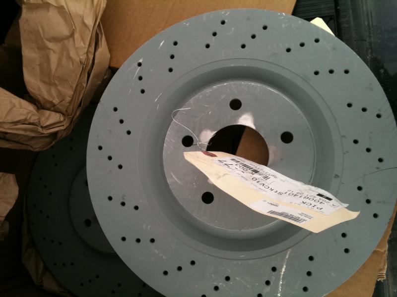

Nah, I bought them from bimmerspecialist.com. No HWA stamp, just the Mercedes start and part number.
No engine builder plaque either. I was under the impression that only started in '03 or '04? The engine I have is from an '02, so it should have that slightly higher compression ratio I believe.
I have just a stock crank pulley, just going to put that on. Currently assessing what other new parts to throw onto the motor. With the relatively low miles, it probably doesn't need the oil cooler seals or the timing cover gasket, but I will probably do them anyway. They are relatively cheap (if you buy them from the right place, ie. NOT the dealer!), and as you said, they are much easier to replace with the engine out of the car. Probably get a new idler pulley at the minimum, I'm going to double check the other pulleys first. The idler seems a bit rough to spin.

these c32 rotors are not as sexy as the c43 rotors with the HWA stamp!
c32 rotors feels like they are cheaper in quality not only the price being cheaper!
Yeah, do some of the replacements on certain parts when your engine is out of the car, not inside in the bay.

Don't like them. I prefer the real two piece rotor with the hat even if they cost double or triple the cost of the C32's

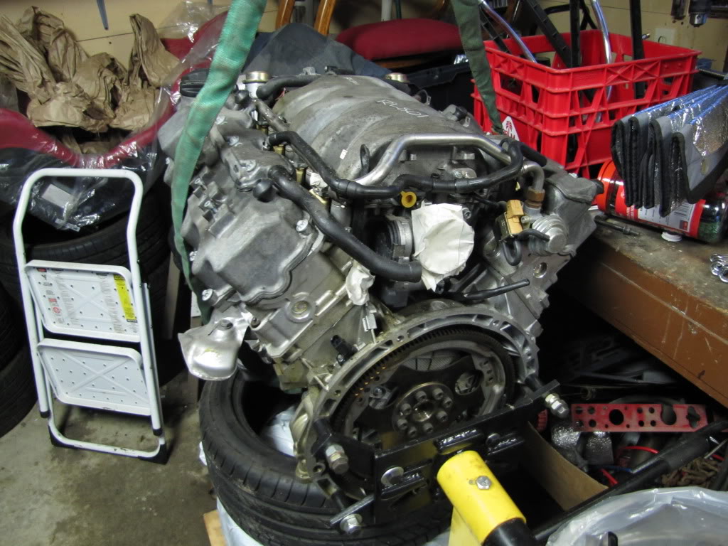

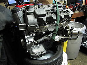

Hi Saab,
On the first engine picture, what is the think bolted on the top front of the engine (round holding bracket and electric wires coming out on the left side?? It don't exist on the 43 motor.... only the round alu bracket

vee don't have that part on our european c43's.
upper round bracket is empty on my car.
part got something to do with US import regulations.

The 'thingy' at the top of the motor, near the front of the car in the V-bank, I believe it's the secondary air pump or some sort of emissions crap. Well, at least now I have two...
So if this is a secondary air pump it could be for US (N. American) cars only Thanks for the info

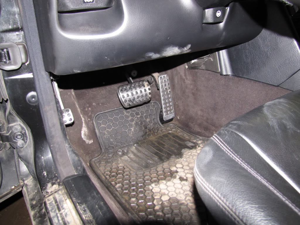

now you need a good interior clean up to remove all that white stuff on your panel and drivers seat!

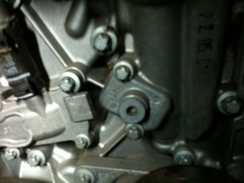

Can you snap a sclose up shot for me of the timing case oil cover port, it should be near the belt tensioner.
You know the cover that fits to one of those 2 different squared timing cover gaskets sold on autohausaz.
I wanna check if I have that cover on my engine.

That's winter roads for ya!
I've actually found a spray product in the shops here - 'salt remover' - just for this purpose.
Here's a pic of the small test port on the timing cover.

Yeah I believe I have that testport.
I found out I have the crappy rectangular squared gasket with no centre rubber!
# 112 184 0161, sheize verdamt!
The revised gasket that came on later m113 engines, can it be retrofitted to an early manufactured engine instead of the old style gasket above?
What do mean about this, salt remover detergent on spray cans?

Unfortunately, I don't know if you can retrofit the different gasket. I didn't look closely, but it's either a change on the timing cover casting, or a change on the test port casting. Either way, I guess you could swap the pieces, but swapping the test port casting would be much easier than the timing cover.

About the test port metal cover, autohaus sells only 1 version of this cover, both version gaskets must fit the metal cover.
The rectangular squared gasket without centre piece rubber can't seal the oil very much?
That's why the reliesed version #2

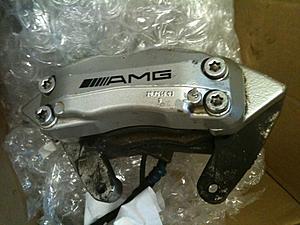

Last piece of the brake puzzle arrived via the FedEx truck just now.
Gonna try and find some time on the weekend to test fit with the 3mm spacers and both 17" and 18" Monoblocks.

no fresh paint on these used calipers?
needs cleaning n peeling then a fresh paintjob.
let me know how your install went.
also check if your stock or SS braided brakelines are long enuff to fit and mount your new calipers

I'll clean them up, but I don't think I'll paint them again. We'll see though, I might change my mind. If I paint them, that means I need to get AMG stickers too! I'm told the C43 lines should be fine. I picked up a set of Stoptech stainless lines, so it should be all good I'm hoping. I'm sure I'll have to trim the backing plate though, but that's not a big deal. I removed them entirely on my other cars when I put big brakes on them.

what's a backing plate?
is it the rear side of the caliper bracket, you need to trim?
stock c43 brakelines are long and good enuff to use on the new calipers?
well I had my Goodridge SS lines installed last year and they were longer than stock brake lines.
The wireloom connected to the cluster for the brakepad wear sensors warning light is it adaptable to the new c32 break pad wear sensors?
Only thing to do is to buy c32 brake pad wear sensors and connect them to the c43 wireloom?

The backing plate is another name for the dust shield.
I have no personal experience (yet) about whether the lines will be long enough or the wear sensors will be fine - but - the Swedish dude with the C43T (S500R?) who did the swap told me it would be all good, and I just needed the 3mm spacer to clear everything.

yeah my stupeed, backing plate = dust shield.
you say it needs some cutting or bending?
about the pad sensors, they are different between both cars, so that means that maybe the wireloom CONNECTED TO THE CLUSTER and the other end connections are different on c32 than
c43?

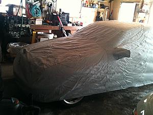

Picked up a genuine Mercedes car cover for when the car is going to sit for long periods of time, ie. when I'm driving the S2000 in the summer.
It's minus friggin' cold right now, so plans for test fitting the C32 brake components are likely going to be put on hold for a little while. Bleah. I hate winter.
I dunno if it will be possible to use the C32 pad sensor harness. The guy I bought the calipers from said they were installed on a '90s E something, so I guess it's a W124. When they removed the calipers, they just cut the lines and the harness. So while I have the sensor end of the harness, it's been hacked of. I'll have to see what I can do...just need some time to mock things up.
you going to buy a new wire harness suitable for c32 wear sensors, or you going to test and fit the c32 wear sensors to your existing c43 wire harness with somekind of home made thingie?

I think I will try the C32 sensors in the existing harness, and see what's what.
I don't see why it shouldn't work if you can get it connected correctly
