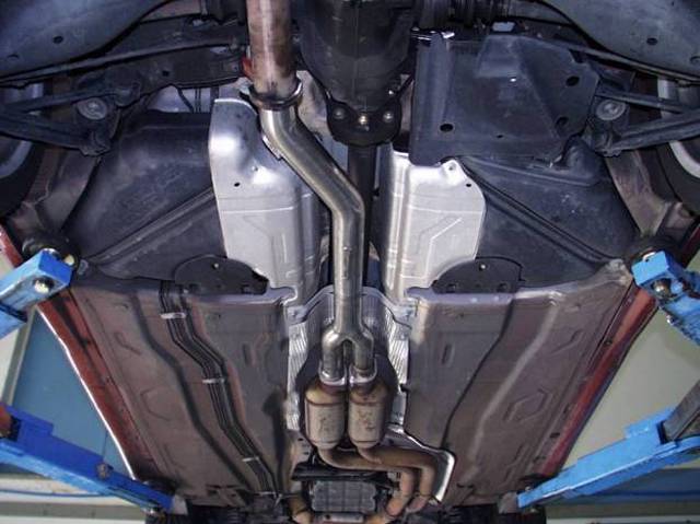

Something like this set-up where the y pipe is after the secondary cats? This way probably makes less noise, more emission friendly (?) and needs no cutting. Some hi-flow primary and secondary (if needed) cats is a nice way to free up some extra horses
Attached Thumbnails Question of cat location for Kleemann header owners-c55_ypipe.jpg
That pic is how mine is setup as well.
