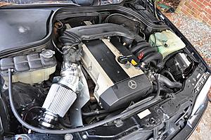

Lookin good. I have a very similar setup, except I have the filter where the air box used to be and a breather tube down to the foglight to make it a quasi-ram setup. I was reluctant to put the filter down there for fear that it would just gather all the gunk from the road and fog light.
You can see my half-*** heat shielding in the picture.
I do have to ask though, what is the MAF mod you speak of?
