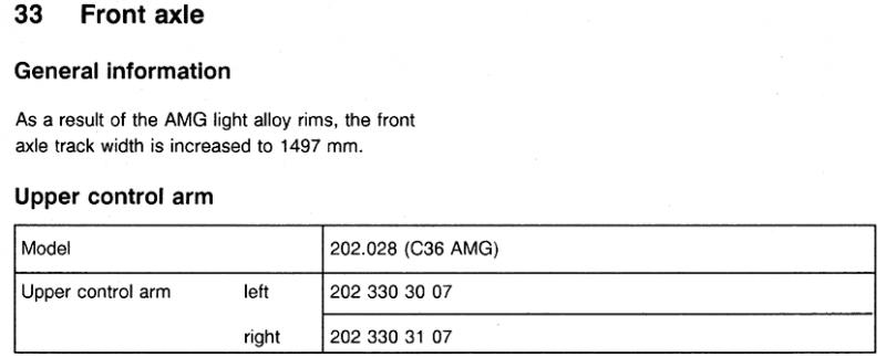

Any one knows if the upper control arm on the 202 AMG C36 the same as the one used in regular w202s? i have this document but it doesnt say for sure, seems to me its an AMG specific part
Attachment 226064
Check the EPC...

The EPC has the info you are looking for.
The old part number for both the C36 and C43 has been replaced
The elegance version has been replaced with A2103302507
The sport version has been replaced by A2083302407
The control arm is the same between the C36 and the C43 the only difference is the elegance vs the sport version, the difference is the bushings. All C36 and C43's came with the sport version, the elegance version was for the regular 202's.
