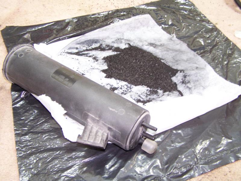

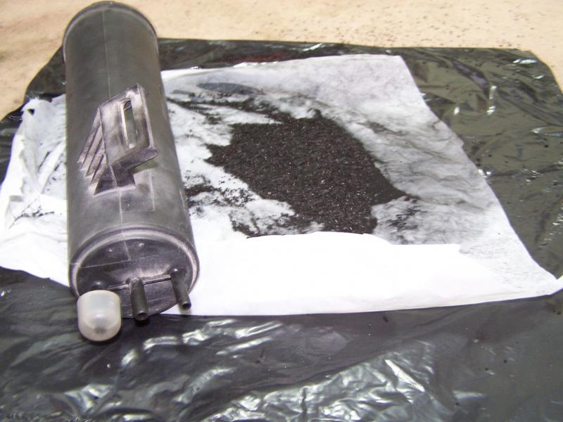

Removed the Charcoal filter hour ago,, wooooow,, see how that damn concrete blocked the filter.....,,
i believe i should to get new one urgently......

Had feeling that Evil mysteries little missing power & not suitable idle from that damn Charcoal canister filter..., i was right & pulled the trigger and
replaced the Charcoal filter,, no any idle missed, power is incredible, happy with waking the beast again from that longy longy sick,, i didn’t find the
Charcoal filter for W202,, the stealership said its not available & needs 20-25 days to arrived,, for that i put a new one from W203........"-"

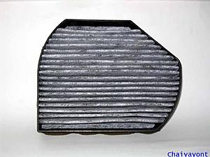

When you feel the A/C air goes weak & sometimes bad smell flows around, that means "Cabin Dust filter" should to be replaced.......
http://w202cabindustfilter.homestead.com/

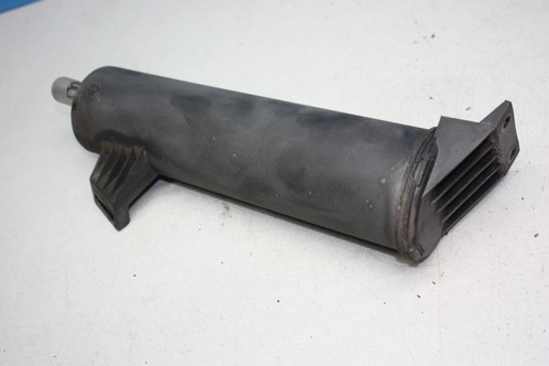

1) Euro version comes with-out Accumulator control

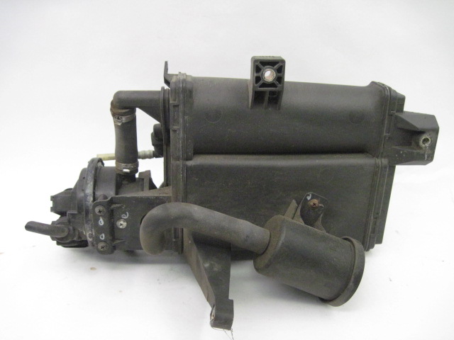

2) U.S version comes with an Accumulator control
*Important to confirm which one or shape you have....??
