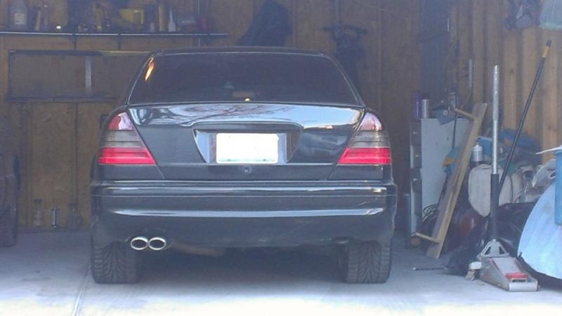

Picture of the 275's..
lookin' dope man
i think you have the fattest rear tires on this forum?
i hope you didn't have to beat up your rear panels to make your rear tires run freely?

Originally Posted by kowalski
lookin' dope man
Thanks. I did have to use a hammer to hit the corners from the inside panel. Not much hitting, but I also had to grind the metal down a bit. Than I under coated it and looks like new. Now I could never go back to any tires that are not 275's.
