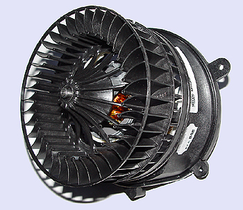

This fan motor got internal brushes & bearing, when one of these goes away, it will starts to hesitate,
you have to pull it out and check them, or you can get a new fan with motor assembly...

When blower works by hitting or pump it, means brushes are gone,
if blower shaking when its cold, means motor bearing goes away,
if it starts then stops with every "2-3" seconds, means motor armature die, which symptom you have..??
