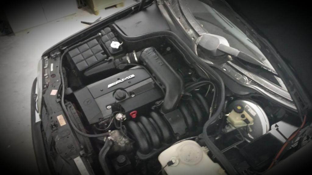

I did mine in a satin finish black with a little metal flake.
Be careful though when it comes to removing the paint. Some of these valve covers are made of aluminum, others are made of magnesium... which can combust... especially if you chose to sand blast them. Luckily, I did not. But the magnesium is also very very soft, and they are prone to warping and cracking. The paint on mine was not that great of a job because I decided to hold out to do a quality prep and spray for when I can get an aluminum cover to replace it.

Oh, I would have raised some serious hell. Material or not, they should have inspected it to determine what the material was BEFORE they blasted it. You can't just ***** nilly start blasting parts and hope that the material is harder than your medium, especially as a business that specializes in media blasting!
Looks like yours was Magnesium too, and they used sand on it. They're lucky that it didn't burst into flames. Magnesium is way too soft for them to blast like that. I put a divot in mine just from using too high of an air pressure to dry it off after cleaning it.
