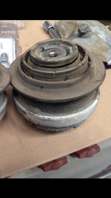

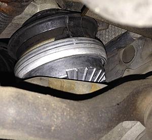

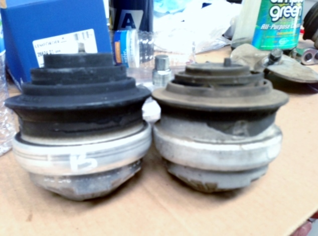

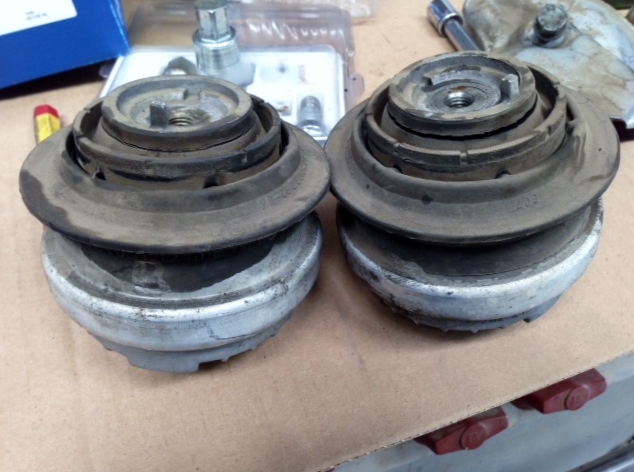

Had my engine mounts replaced use the Lemfoerder from autohaus part #2662401. I noticed steering vibration minimized and the car feels jolty. The old mount was so bad and cracked it was about half inch shorter compared to the new mounts..My new found mech from CL had to raise the engine to get the new mounts in.

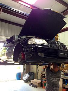

FYI..If you live in sac or central valley and need suspension work done pm me I
found a dude on CL legit & does clean work. Family used to own a suspension shop the dude enjoys what he does, he treated my car like it was his. The best part was he charges reasonable. I had him installed my euro springs and front shocks then he had time to install my engine mounts...I guess you can say I'm very happy

147,712 miles to be exact..well I noticed minize vibration on steering wheel and car is jolty. Also I'll check later but before the install I use to notice movement when I turn on the car and when you brake suddenly slight thud movement of the engine
No..you'll have to use the old bolts. There's two bolts one on top and bottom.

You can always ask the dealer or an indie shop to check your mounts. But, the signs were there for me the thud sounds when I brake real hard feels like the engine moved forward and leaks from the mounts. You could also check by having someone press the gas pedal while it's in parked, watch the engine movement when the gas pedal is pressed if you see large movements the mounts are going out and need to replaced. Hope this helps..
