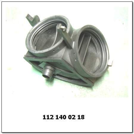

Do you mean this elbow..?

Old Jun 6, 2014 | 06:59 AM
88260EEE's Avatar
Joined: Mar 2014
Posts: 157
From: Boston ma
1998 C43, 05 Mini Cooper s
Yup

What happened to that elbow.., legs broken...??

Elbow is ok the gaskets are shot and the clip for the MAF broke and I keep getting P0100 code

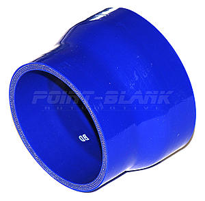

If you don't want to bring another one, you can put small reducer coupler 3.5">>>3.2"...
