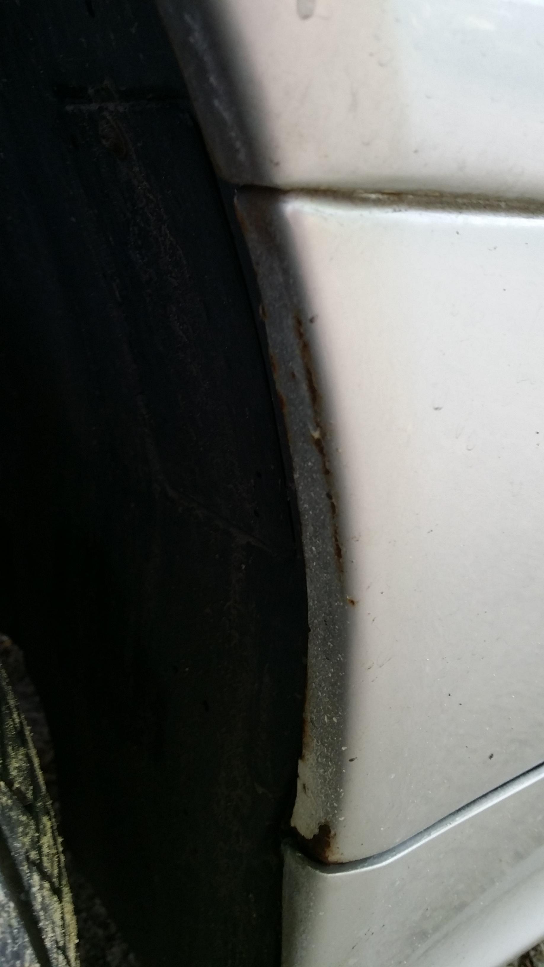

Where is the rust on the wheel wells? I advise you to scour the car for more rust. Check the running boards, under the car, especially the jack points (take the little flaps off the side skirts), and anywhere else you can look. My front two jack points on my 43 are completely rusted out, and I had an LCA snap on my C36 due to rust. Not fun.

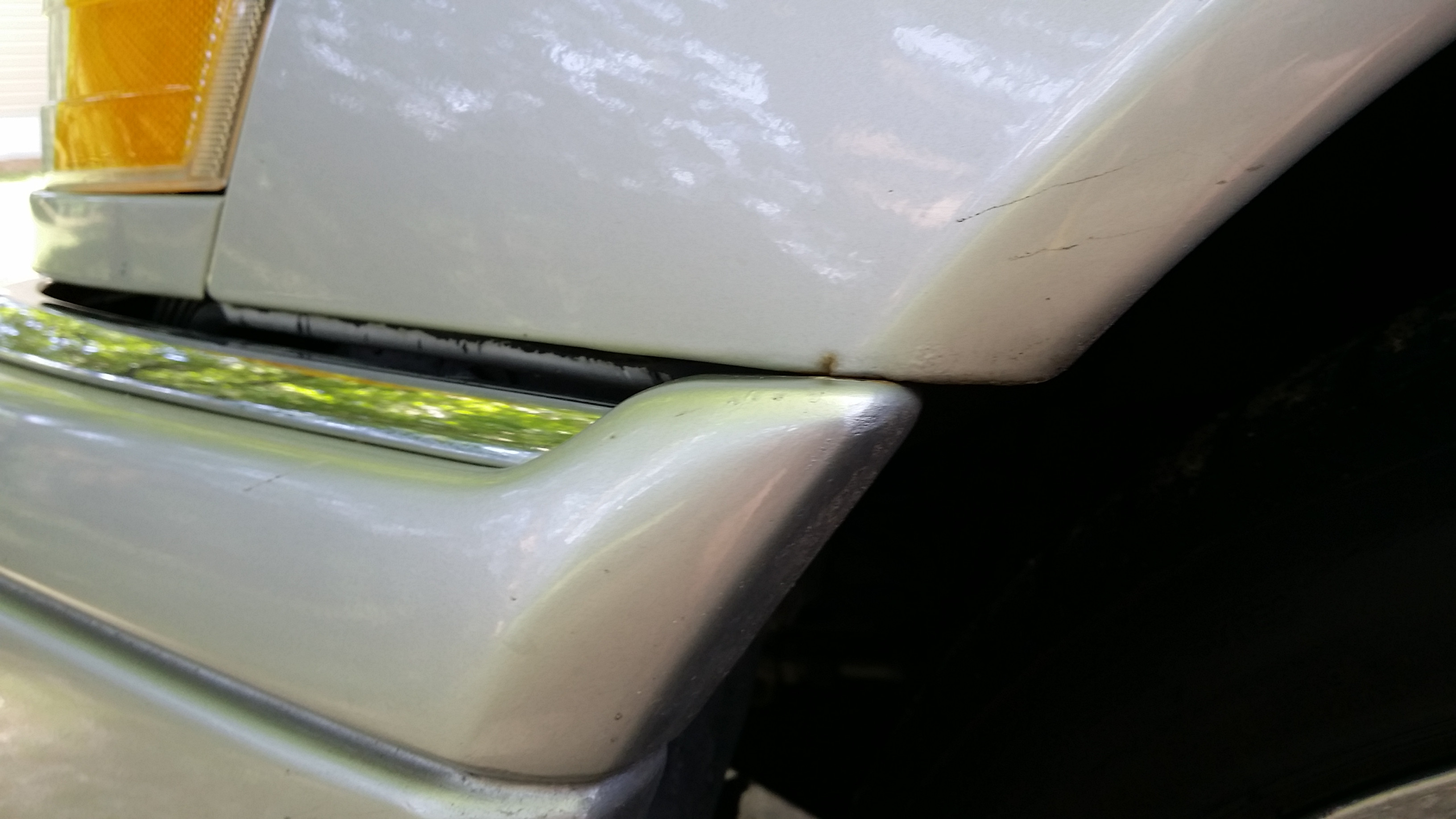

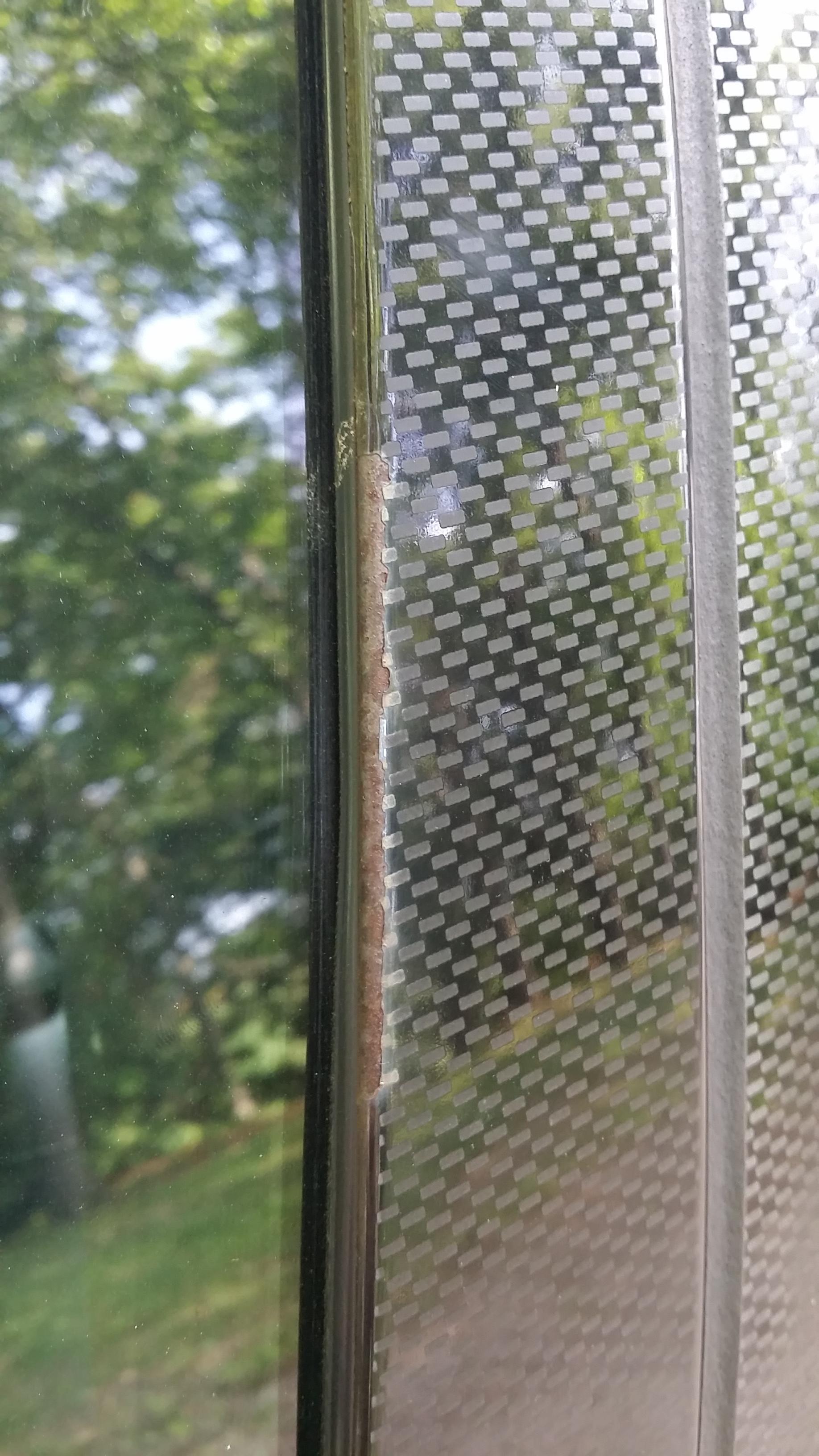

The rust was mostly on the drivers side front wheel well near the bottom where it joins the bumper/side skirts. I will be heading back out there Saturday to have another look and I've also scheduled a PPI. Costing me around $125 but definitely seems like it will be worth it. I got burned on a couple things with that c230 so this will give me some peace of mind even if I don't buy it.

good points on the rust. you wanna make sure there's no outrageous frame or body rust.
my 98 C43 came from Michigan and the front drivers fender had a rust hole the whole way through it and was in awful shape. However I crawled under the car and found no more rust anywhere else on it. No idea why that one fender rusted so bad. I found a used black fender from a C230 on craigslist for $80, swapped it myself. Good as new after a polish.

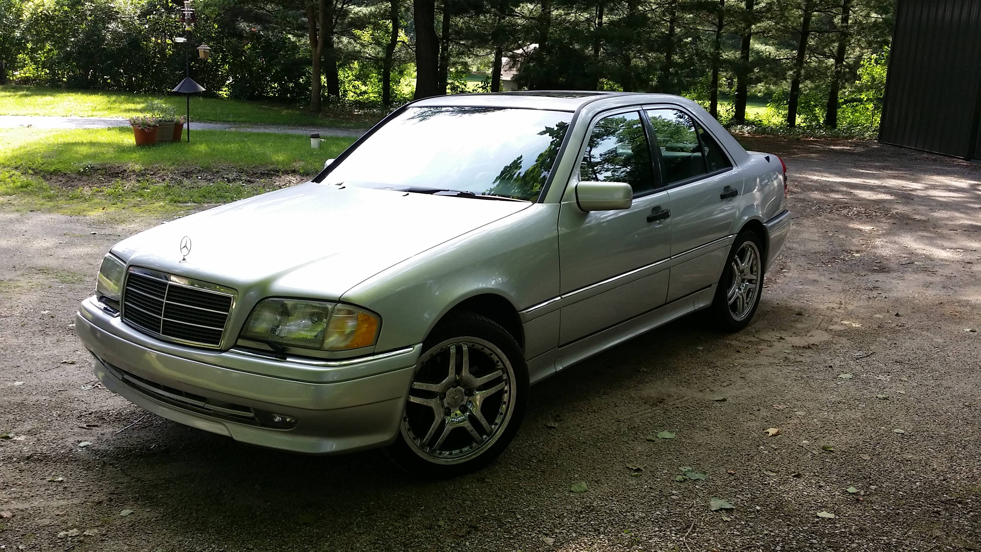

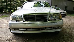

Ok well it seems that most of the information you guys have given me previously is useless unfortunately...
I picked up the car and noticed it was listed as a 1996... I must have misheard when I spoke with them previously but I looked up the vin and found out it's most certainly a 96...
I also realized after more driving that I'm not sure why it felt loose... the vehicle was amazing to drive but it is still having that idling problem, along with a check engine light which I didn't notice before. I'm sure I'll get more info on that at the mechanic tomorrow morning. What's weird is when the vehicle starts, it's low-less than 500 rpm for a few seconds-then shoots up to 1k plus, the evens out around 500 again. It fluctuates somewhat randomly in that range for a minute or so, then levels out and seems pretty normal. Didn't notice any hesitation when shifting gears.
I've also got a bunch of pictures. I'm not a fan of the wheels... He has the stock wheels in the back, which I will most likely go with. Also a few pictures of the cosmetic issues... front bumper seems like it was detached and not put back on very well... A couple small rust spots... and some of the carbon fiber looking wrap on the B pillar is coming off...
I'll most likely be updating after the mechanic tomorrow afternoon.

I'd pass with all those issues plus the rust.
