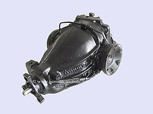

Can anyone shed some light on which models of cars had interchangeable differentials with ours?

(01/04) R170 SLK32 AMG..

That is only one?

You can find it in some version of U.S W210 E280/W210 E300TD,
i'm using a smaller ASD/LSD pumpkin from W201 190E 2.5 or W124 300CE/D, since 2 years without any issues..

I may create issues with the tq my car puts out- although I would expect any should be overbuilt enough to be ok.
I'm likely to buy the wavetrac?
