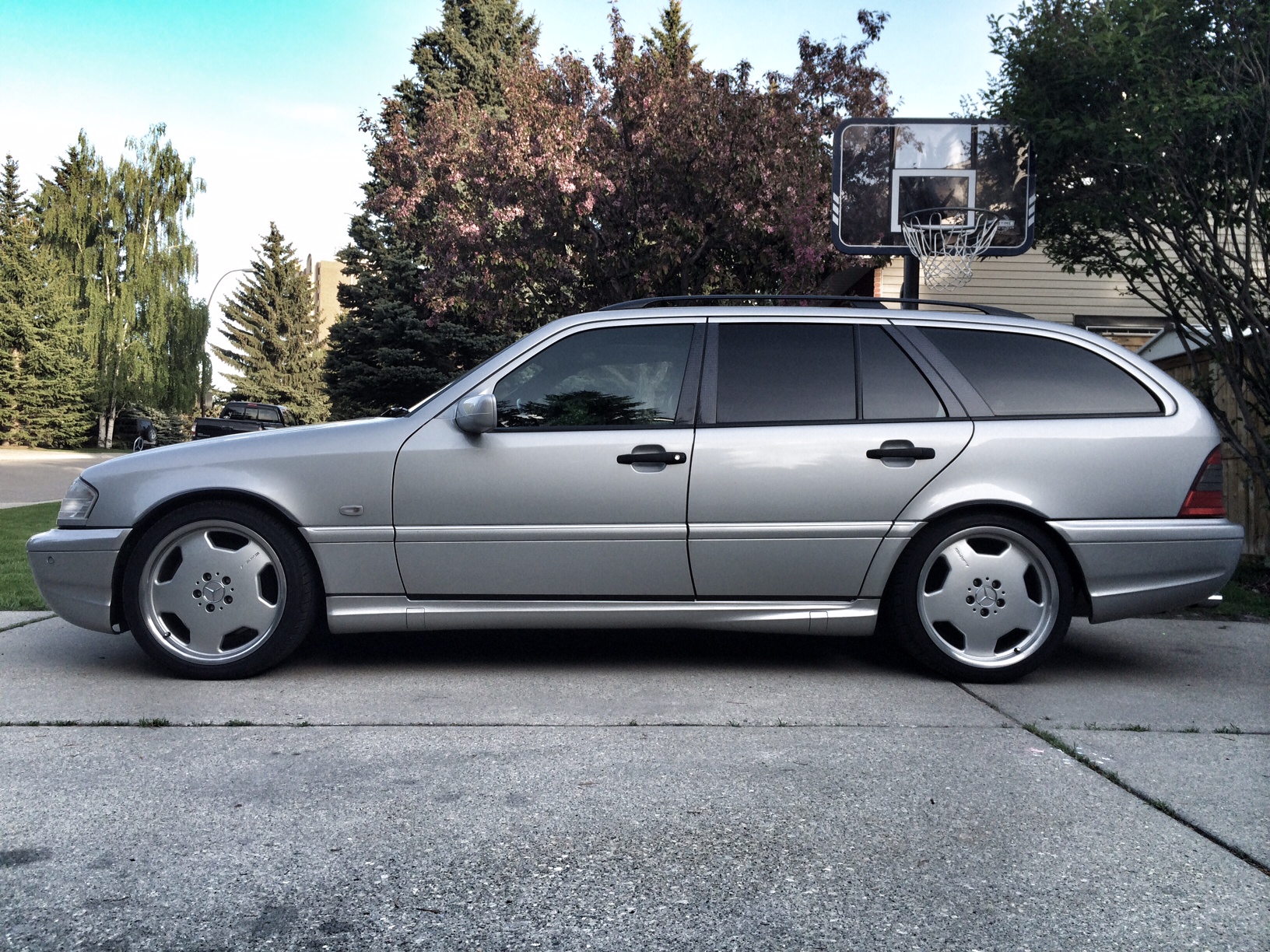

I was fortunate to score a couple of great vehicles recently:
- '99 C43t (55,000miles/90,000km's)
- '99 E55 (100,000miles/160,000km's)...has hail damage, included 2 sets of factory 18" monoblocks, some recent service recorsd and is a very strong runner that will be the "parts" car
(see pics attached)
The plan is to do the motor swap over the winter.
I don't want to keep the e55 around for too long as it's taking up space, but don't want to miss anything important before it gets sold for scrap.
- 5.4 motor/computer/trans
- front brakes/calipers (OE rotors are almost new and are needed for the c43t)
- climate control display (the display in the c43t doesn't always work)
Does anyone have any suggestions as to what I should remove from the e55 before I get rid of it? Any cool things that can be swapped over or should be kept as backup parts for the c43t?
So far I have only done the following on the c43t:
- 18x8/18x9 monoblocks
- Bridgestone RE970as 225/40 and 255/35 tires
- removed the dark tint on the rear windows
- added Llumar "Air 80" to all windows on the vehicles
- installed new air filters and cabin filter
Thanks in advance for the feedback.

that E55 is gorgeous! but that driver's door looks like it has some very serious rust issues going on underneath.
if it's really just some hail damage I would actually swap both engines. keep the 43 engine in the E55 and use the E55 as secondary car!

bumpers and side skirts - all the lights - all the seats - cluster with the eis and door locks - ME and TCU

Need to swap Engine only, but first, you have to check 2 things:-
1) what injectors on both Engines..
2) check if C43 gearbox is running good, without slipping or delay shifting, and important to check if there is oil sneaks to the TCU..

everything that separates it from a non-AMG model. every single piece. I bet bumpers and side skirts are hard to find, just like on the C43.
you can transplant the E55 cluster, steering wheel (with working buttons) and head unit (even if it has COMAND) into the C43 with minor modifications to the paneling.

From the E55 keep also the key(s), EIS, steering column lock and alarm module.
For a true E55 -> C43 swap, you'd need these swapped over so you can start the E55 engine with the E55 ECU without the need of remapping the C43 ECU.
Downside is that you won't be able to order a replacement key from the dealer anymore for the C43 since VIN numbers won't match.
