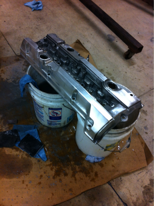

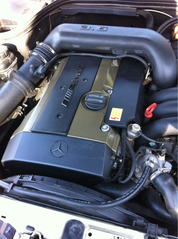

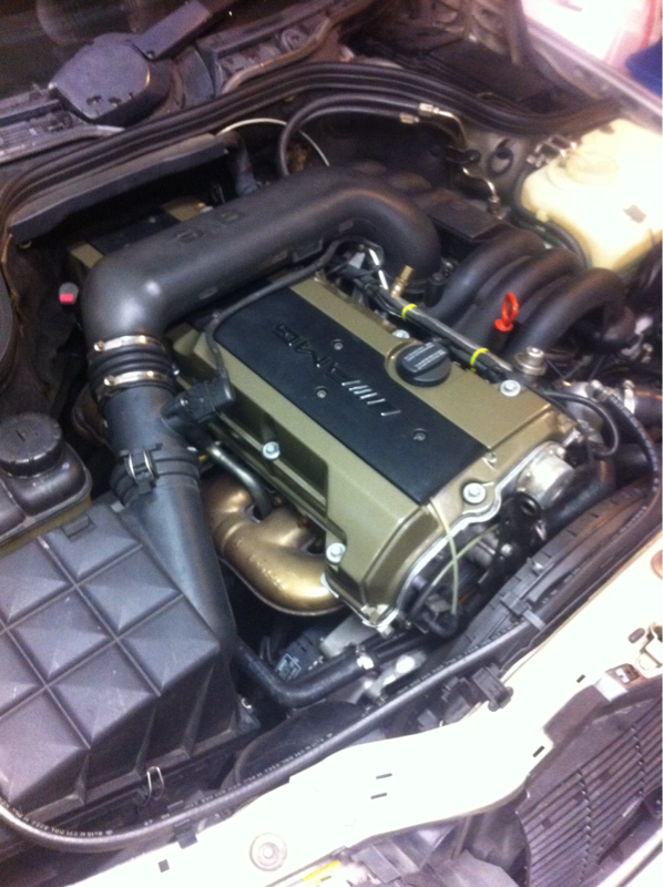

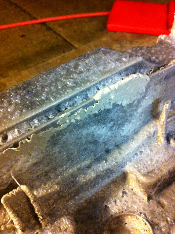

Just a heads up to the c36 guys. Since I've owned the car, all but one of the coil cover bolts has been stripped out. The same bolts that go through the coil cover hold down the coils to the engine.
From the junk yard cars I've looked at seems like rotten aluminum valve covers are more common than you might think and seems like a lot of used covers are stripped out. What happens is when the coils are not bolted down right they will shake, that slight shake over time will cause the ground posts on the valve cover to wear away. This leads to the death of the coil eventually. ( as well as over heating from being under the coil cover but that's another issue )
thankfully after market coils are cheap but to be warned they are cheaply made compared the the factory square Bosch. After buying after market STI I ended up buying a set of really nice Bosch coils again after one of the copper grounds pulled out of the coil while trying to remove it to swap valve covers. Used valve cover, used coils.. Few cans of stripper and paint.. Good as new

Lazy man route and went factory.. For the money just wasn't worth the time. For all that need them the part numbers are
104-150-00-66 for the "cap suppressor" (large plastic on front of valve cover.
104-159-04-25 for the cover that hides injectors. (I guess there is a couple different numbers for this cover depending on it's length from what the parts guy "durableswedish" was saying..

I also took the dremel and cut off the broken mounts on the cross over tube and cleaned that up too.
