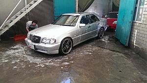

Hello everyone! good people help advice, took another kleemann headers e55 w210, and I want to convert to the Mercedes B202 C55, can I alter them, thanks in advance!
and whether the effect!

PJmak's Avatar
Joined: Sep 2007
Posts: 4,566
Likes: 421
Nice looking car.
What do you have done to it?
Old Mar 16, 2015 | 02:37 AM
Mazik's Avatar
Joined: Mar 2013
Posts: 71
AMG e55
Originally Posted by PJmak
Nice looking car.
Thank you, nothing special))
