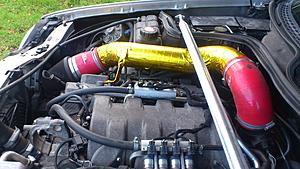

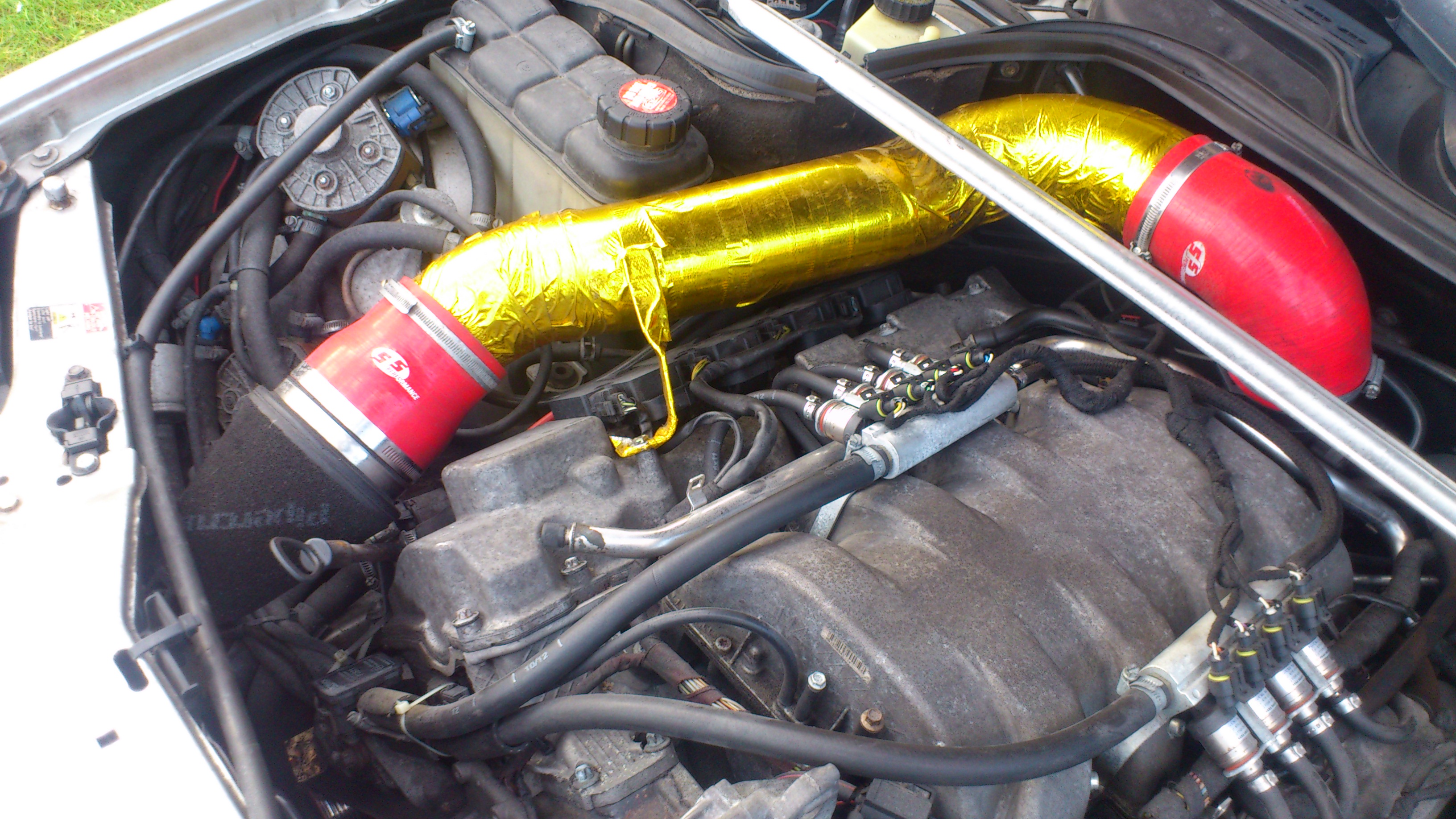

Hi Guys! A quick update..
My transmission gave up the ghost during last Autumn and I had it rebuilt over winter..
I was going to get a 55AMG transmission as I'm still running my 430 box, but after looking it over my builder decided I needed an upgrade of double side clutch packs with the maximum 6 pack (5 previous), new selector forks, Torrington bearings and thrusts together with a gearbox bearing and sprag. He also changed and modified my valve body as he said it's prone to fail in 2nd gear.. (I don't know exactly what was done).
He flushed everything out as bits of metal from the bearings contaminated the oil. He cut open and resealed my stall converter too.
While this was done I updated my cone filter for a larger diameter 4in (up from 3in) and did the connecting pipe in 3.5in before wrapping it again with gold DEI tape.
I also added Evans waterless coolant. This actually saved me towards the end of Autumn when on the highway my lightweight crank pulley broke and I lost my water pump (now running OEM). The temperature shot up and I drove for 2 miles in the red to get off at the next turning. The warning for engine oil too hot didn't come up which is why I drove on. Normally I'd never attempt this being an aluminium engine!..
I can't say I can feel the difference in pulleys. But at the time of my AMS pulley install I did notice my revs rise quicker. I'll look to find another or hopefully Weistec bring theirs out soon as they did email me to say spring 2016...
The results from these updates are very noticeable!.. My car pulls harder shifts quicker and slightly firmer with a slightly louder exhaust note. Driving normally around town the shifts are very smooth, to the point you don't notice them, you only hear the engine note change.. With my foot to the floor it feels like a manual gear change and sounds a bit like a more modern car with the ignition cutting for a split second.. Driving manually is so much more fun. I get a lot more engine braking and so have to learn how to drive my car again!
I may run my air filter 4in all the way to the firewall to see if any better? I've yet to run a new dyno but I'm loving it!...

Good Joooooob, looks Awesome..
just need to insulate the filter..
