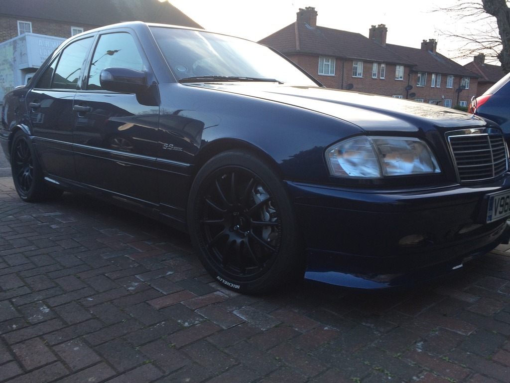

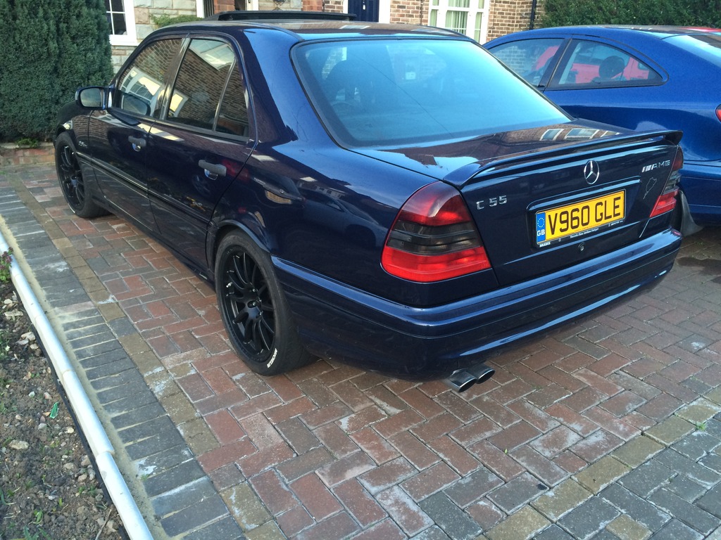

iam so glad I did the 55 engine

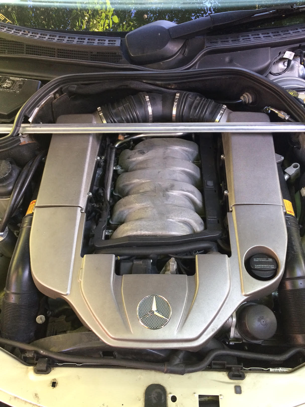

My SL55 intake on a w208 55 swap.
To make this work you will need to reverse the rubber couplings. You will need to trim the front cover as well.

Excellent job,
55K intakes are the best air upgrade for any M112/M113, IMO..
