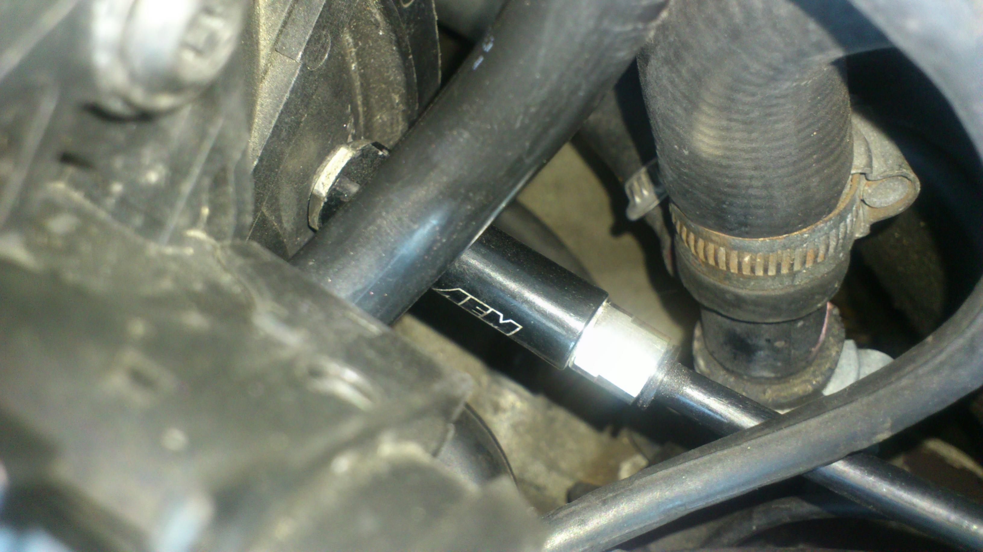

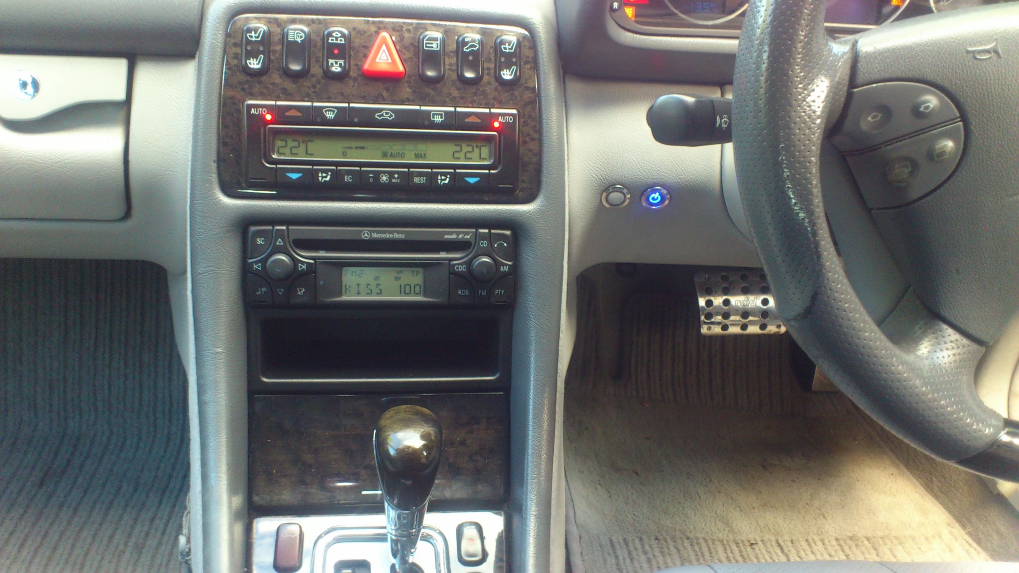

When my application was installed there wasn't a system for N/A (AEM make one now).
We removed the programmable box for an F/I unit and inserted a simple pressure switch. Of course it isn't that simple and dyno runs have to be made to get the precise amount of cocktail and injection nozzle needed. I also installed a separate on/off switch next to the steering wheel and an indicator light to light up when the cocktail is being pumped into the engine.
I'm running a 60% weight in meth Vs water as water is heavier (most use 50:50). I find this together with my tune agrees well with my car.
Other than my mods stated I haven't done anything else. These M113 units are quite tough!
You can readily pick one up now and so if anything breaks I have a base reference and can modify accordingly!

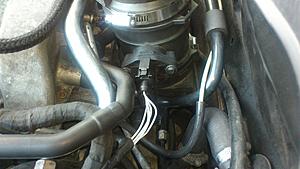

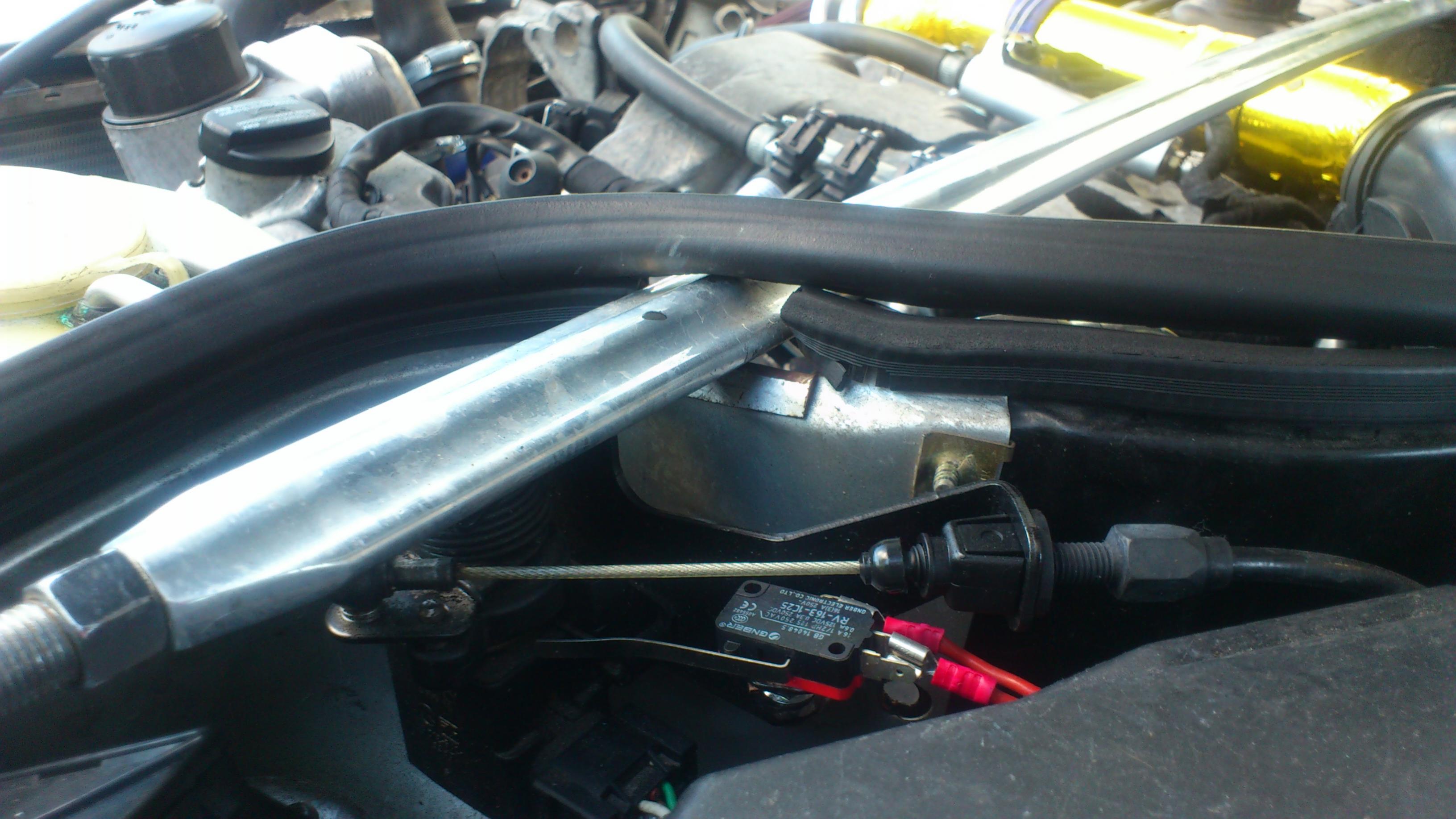

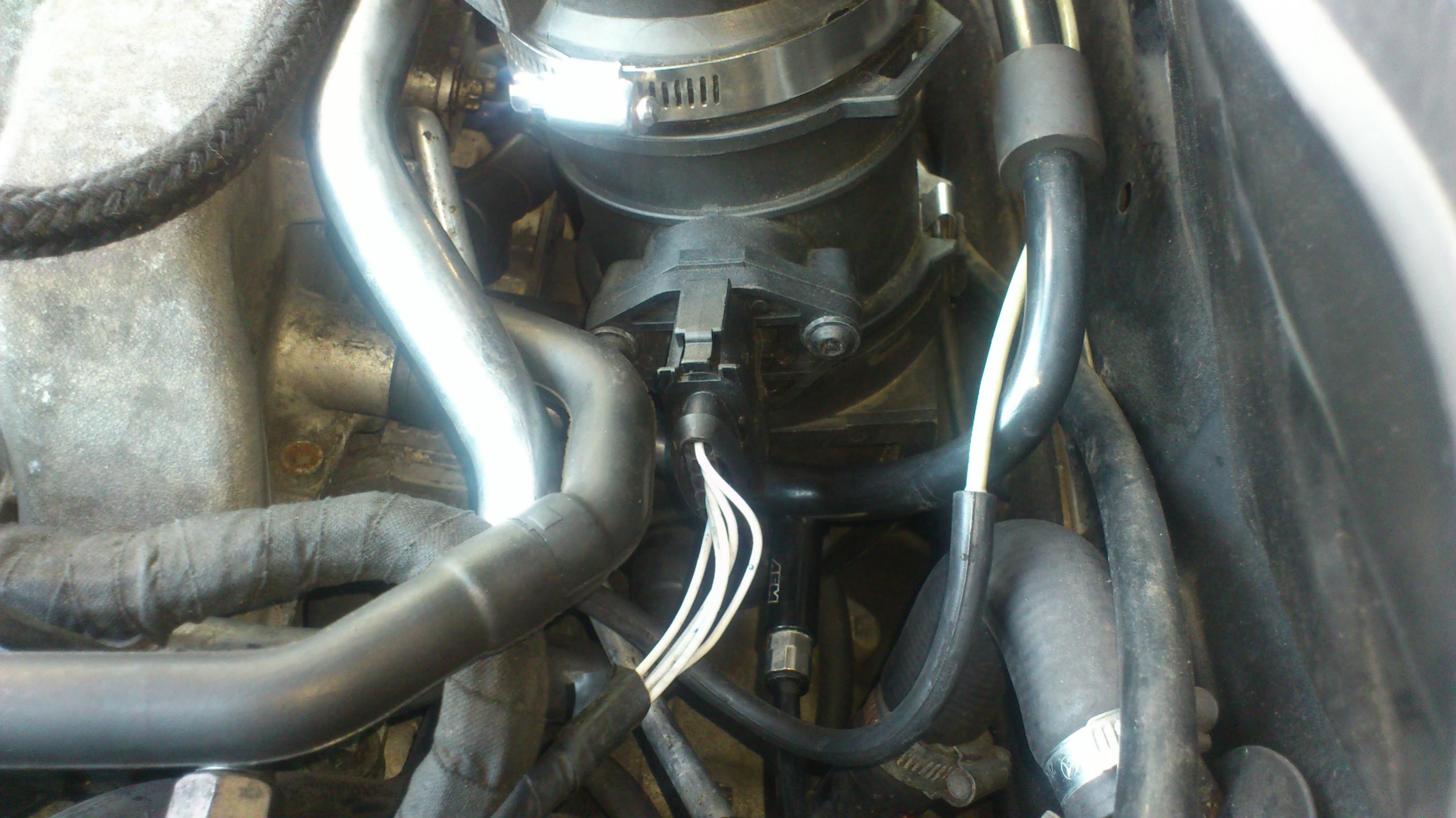

Pictures of my install:
Attached Thumbnails All 4.3 to 5.5 converts Sign In!!!!-dsc_0105.jpg   All 4.3 to 5.5 converts Sign In!!!!-dsc_0111.jpg   All 4.3 to 5.5 converts Sign In!!!!-dsc_0110.jpg   All 4.3 to 5.5 converts Sign In!!!!-dsc_0108.jpg   All 4.3 to 5.5 converts Sign In!!!!-dsc_0107.jpg

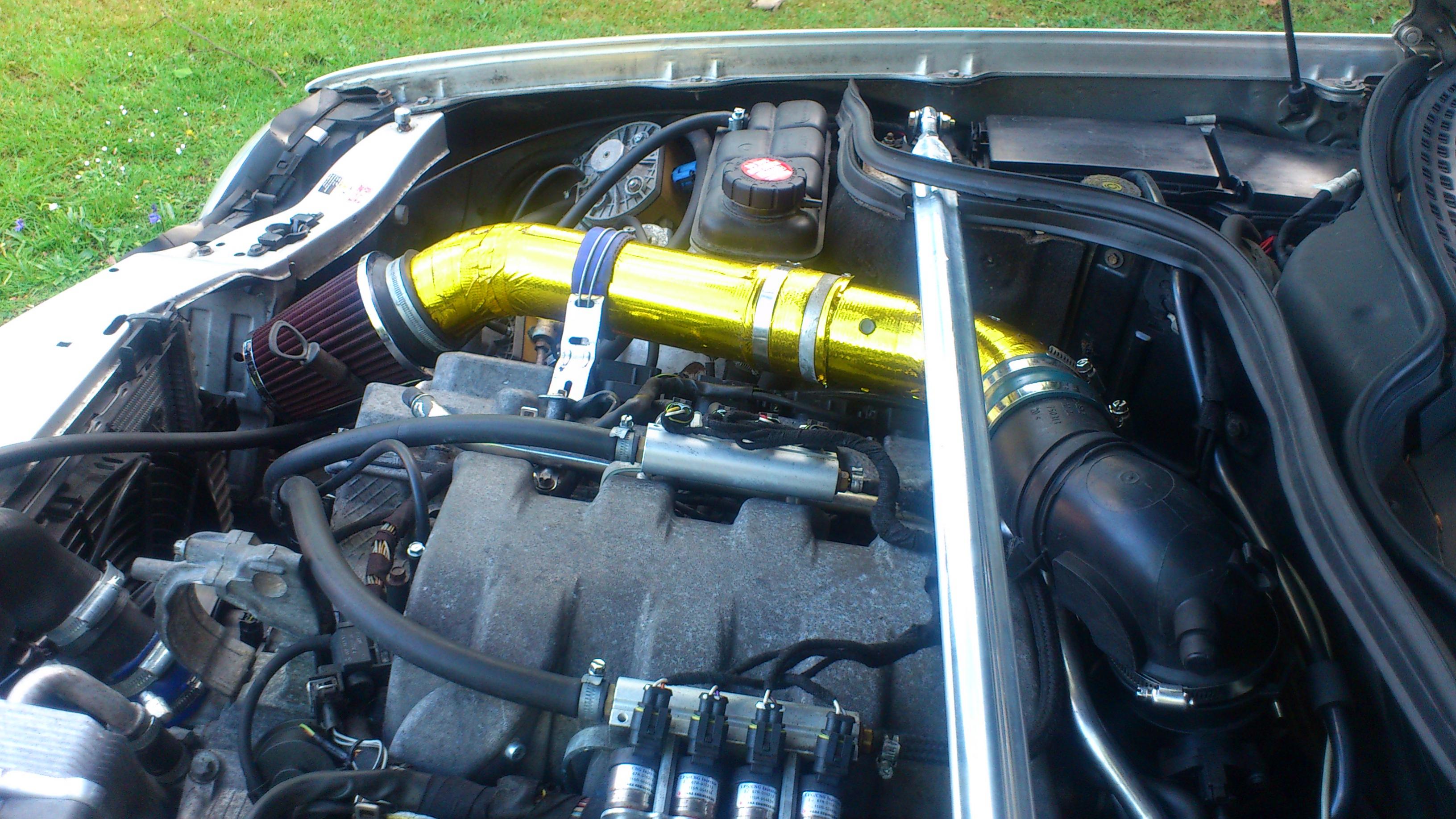

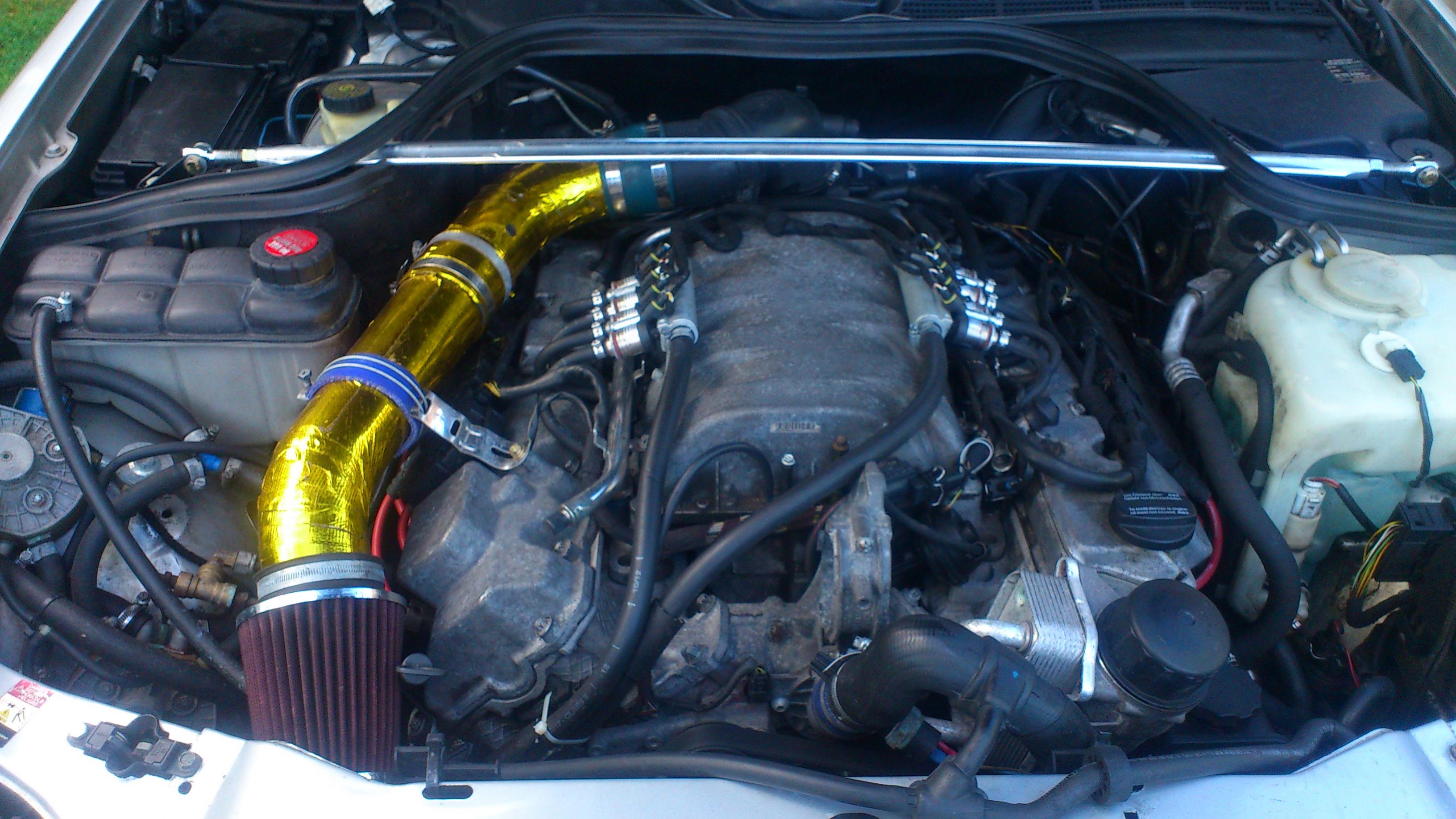

Couple more of my engine bay.
I've moved my radiator over a bit to enlarge the access area for air. I'm in the process of enlarging the piping to the air mass. Currently I'm looking at a vortex effect with 4in filter and pipe, coning down to 3.5in at the air mass. The DEI gold wrap heat resistant works well.
I thought about the SL conversion, but this should get just as much air in!
Attached Thumbnails All 4.3 to 5.5 converts Sign In!!!!-dsc_0106.jpg   All 4.3 to 5.5 converts Sign In!!!!-dsc_0109.jpg
