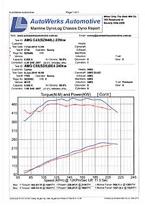

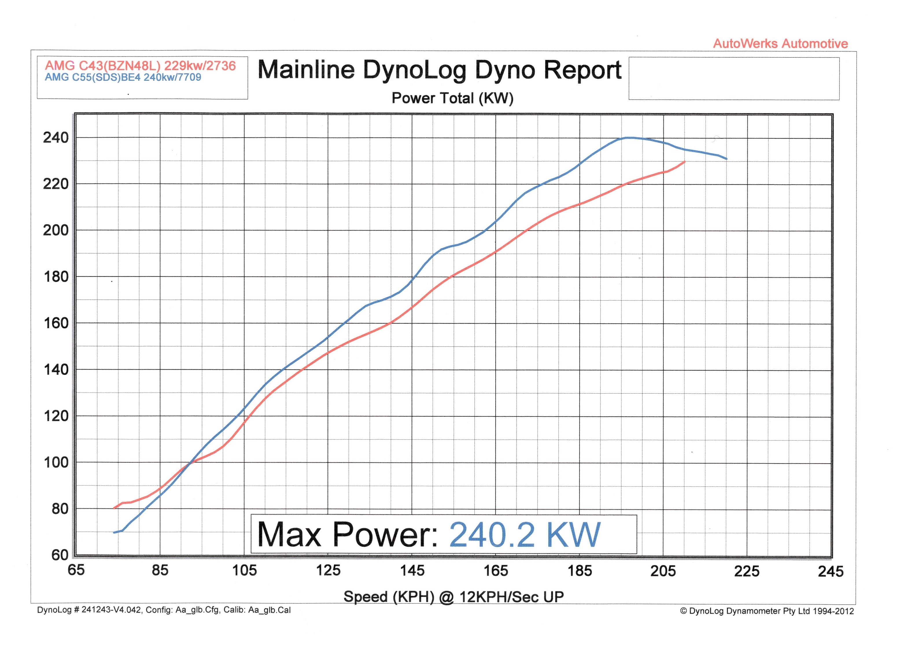

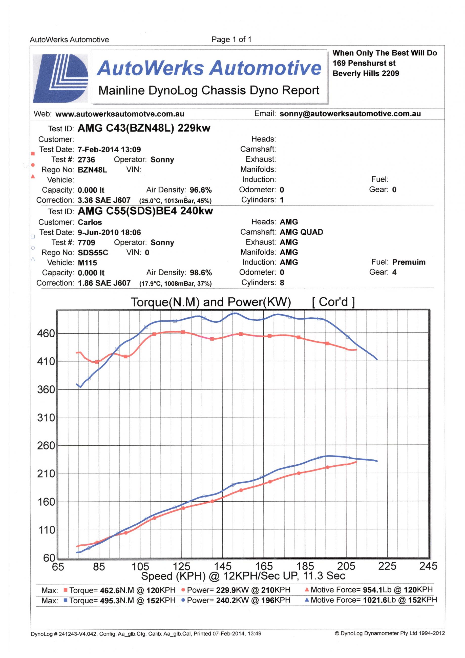

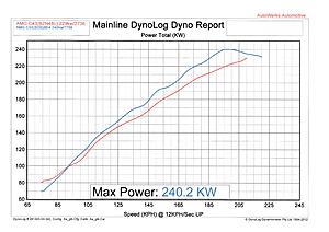

I've had the 5.4 conversion now for about 12 months. I rebuilt my engine before fitment, the only engine mods are PTE cams and ceramic coated pistons. For the rest of the car I have Bilstein B8's, W210 E55 18" wheels, Hedgehog Motorsport front LCA bushes, Deep transmission pan, 22mm rear sway bar and a custom radiator.
Unfortunately my car has developed an unhealthy appetite for rear thrust arm bushes since the engine conversion and I haven't discovered the reason yet so I haven't driven it for a few months......but hopefully I'll be driving it again soon
Here are some dyno sheets from just after the engine conversion. I should do another one now that the engine has run in fully. The blue line was an overlay from a tuned W203 C55 for comparison purposes.
Attached Thumbnails All 4.3 to 5.5 converts Sign In!!!!-image2015-04-07-114342-1.jpg   All 4.3 to 5.5 converts Sign In!!!!-image2015-04-07-114342-2.jpg   All 4.3 to 5.5 converts Sign In!!!!-resize.jpg
