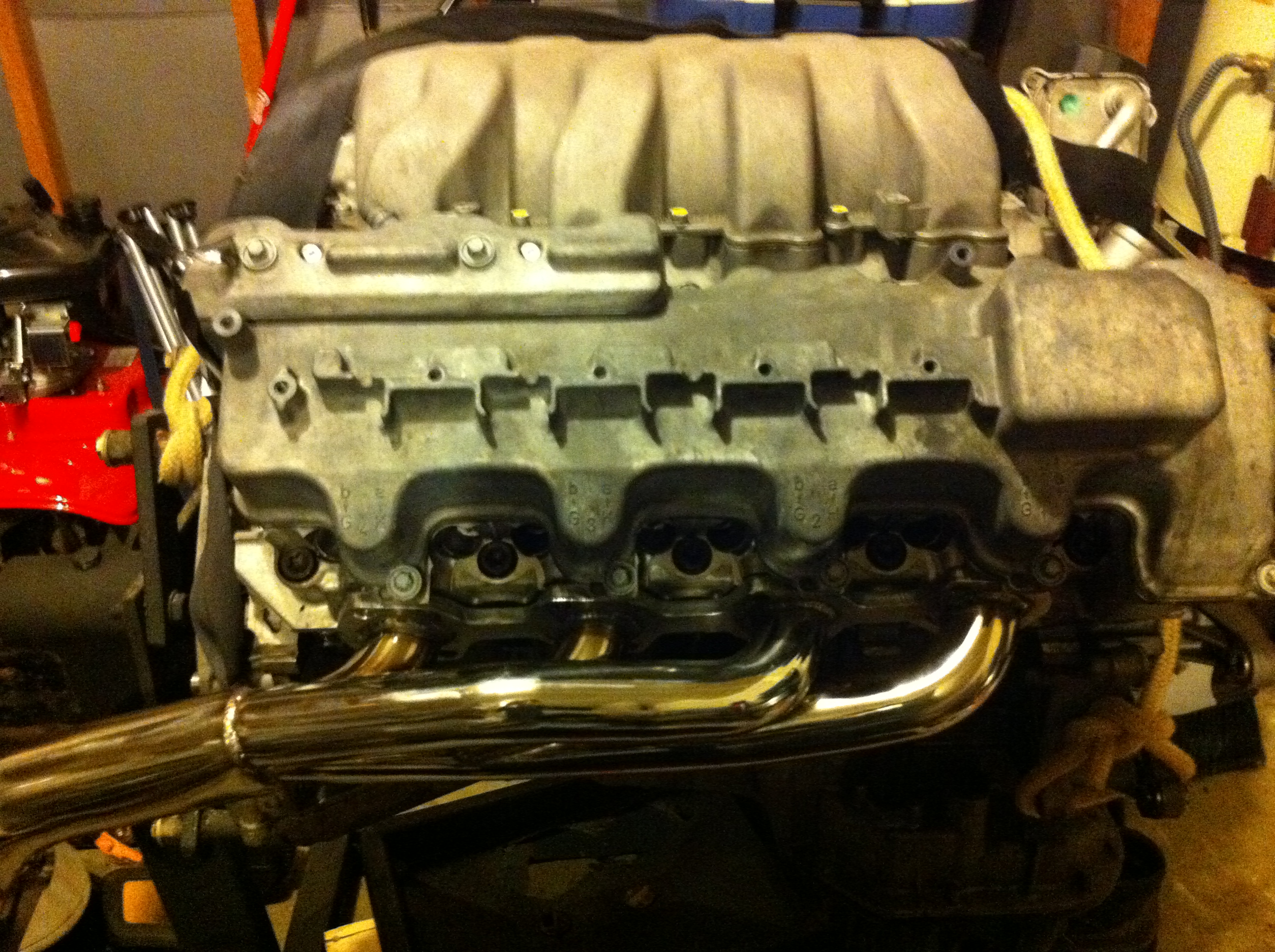

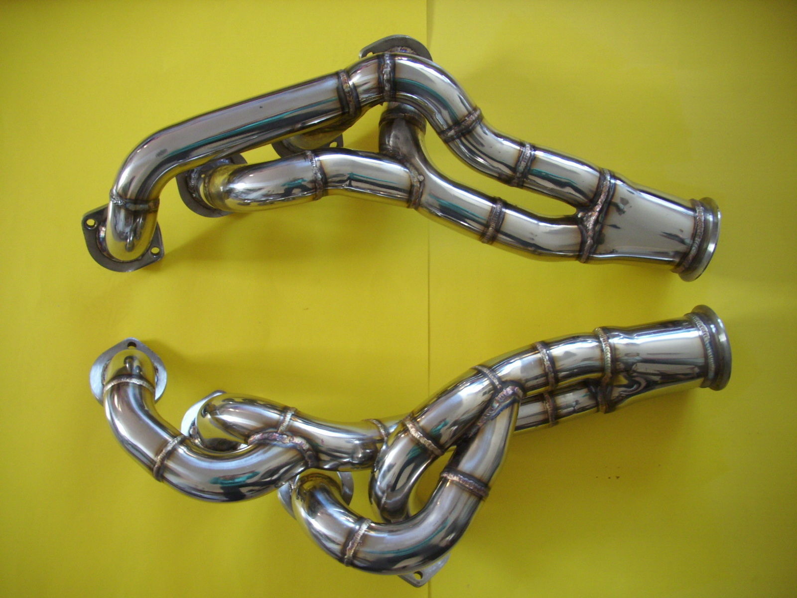

Also attached a picture of some German headers for our car (sorry, don't know brand) and a picture of my Kleemann's, but unfortunately not the side that is difficult.
