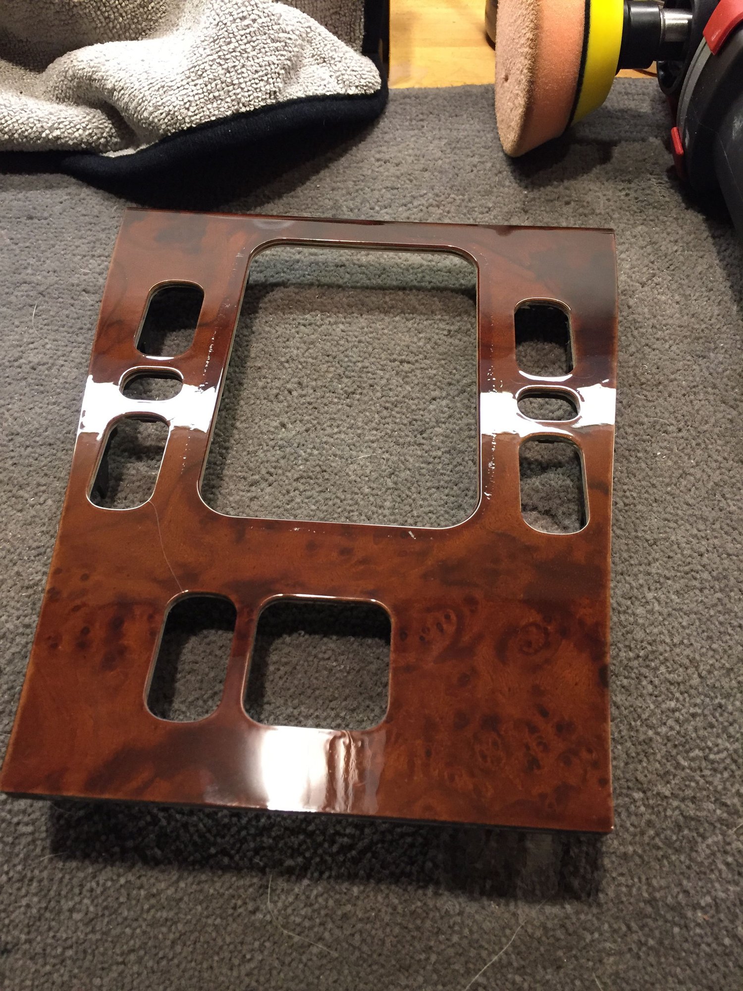

Hey guys, thought I'd share some photos of my recent projects. The interior trim was pretty beat up and I've been meaning to address this sooner.
As you can tell, there are some pretty visible scratches and swirls in all the trim components. I began with a light cut using Menzerna Final Finish and an orange pad on my Flex rotary polisher.
These are the results after my second cut. I could have used a slightly deeper cut to speed up working time, but it is better to begin with a lighter cut and work towards a deeper cutting polish to avoid cutting too deep.
All finished. There is one crack that I couldnt remove and also a few imperfections but most of those sit underneath the trim ring around the shifter. I threw a couple coats of Menzerna Powerlock sealant over the trim pieces to try and get some protection over it.

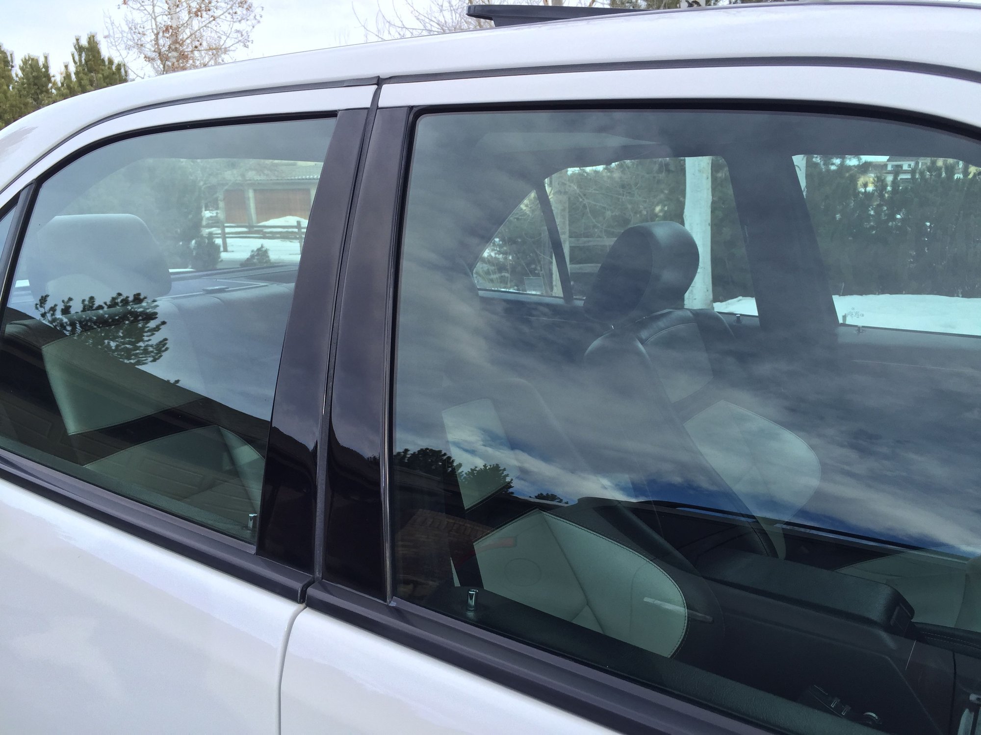

I decided to clean up the B pillars and window trim. The pillars original finish was fading and there appeared to be some overspray on both the pillars and window trims.
I ended up using some 3000 grit sandpaper and wet sanded everything down to remove all of the original finish, scratches and overspray that was present on the trim.
Here is everything all finished and looking fresh.
