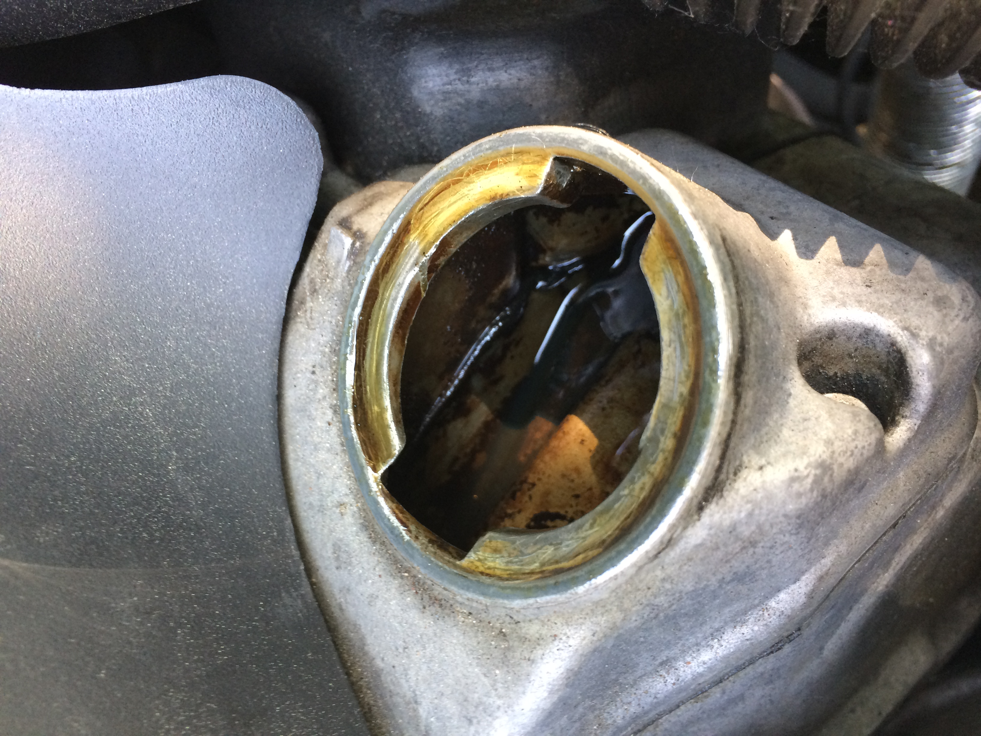

First up was the oil. I have no clue what the previous owner used for oil or what sort of time/mileage was on the oil, so I changed it out. They did use a fleece filter, which was nice. I put in Mobil1 0W40. Looking through the oil filler, I could see some gunk but it does not look like some pictures I have seen of the M113 gunked up. Before the change I ran BG EPR according to directions. I plan on doing another oil change in two weeks and doing BG EPR at that time as well. I don't have the oil filler extension, which is no big deal as the oil cap seems to fit fine without it. I think I might get a new one as a slight bit of oil seeps from the cap. Something I will keep an eye on.
I think the gunked oil varnish on the heads came from the lack of a gasket on the airbox to MAF. It was wide open and who knows how long the car was operated like that. I looked for the gasket, maybe it was stuck around the trans or something, but no luck. Took a bit to get the right part, but eventually I did though special order at my local dealer. Thread here, with pics:

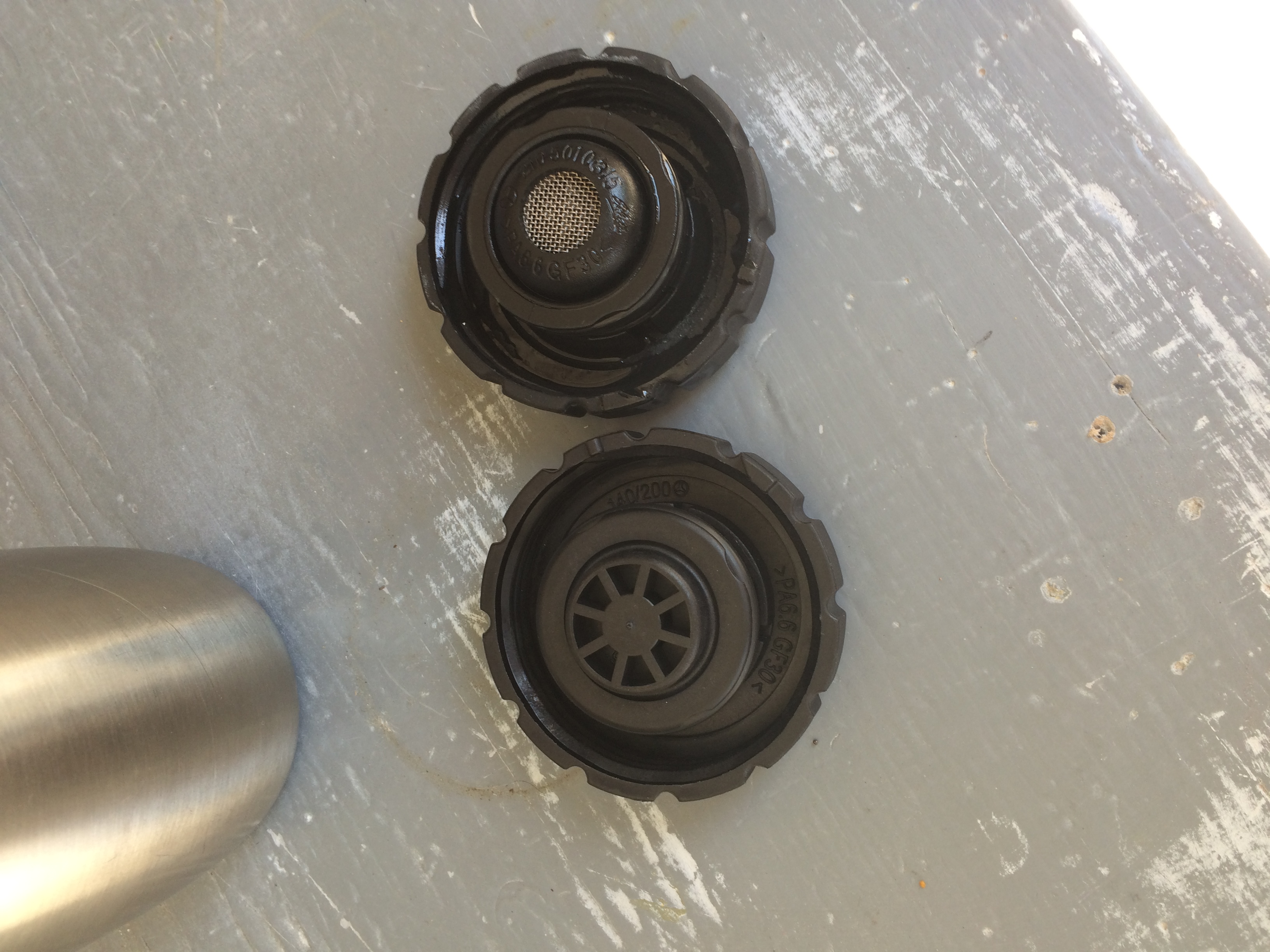

The next issue I am dealing with is coolant temps. I think it tends to run high, but I am not an expert and I could use help here. It likes to run close to the 3/4 tick mark. The electric cooling fans do come on, but I think they might not be pushing enough CFM and they do seem to only come on when the temp gauge shows really close to 3/4. They do not stay on very long and the temp doesn't actually change much. It does not go over 3/4 though and after moving the vehicle down the road, temps stabilize at 80C.
I noticed a lot of dry coolant on the top of the expansion tank, so I replaced the cap. Im not convinced this solved anything and the new cap doesn't seem to lock in place with that little tab so this is a bit bothersome. I did drive around with it today, but no conclusions. I noticed some moisture around the coolant neck, but this could be from when I wiped off the dry coolant. I will monitor this over the next few days. Thoughts on what I can do here? Ive heard of some mod for the cooling fans. Do I need a new expansion tank? Advice welcome, particularly before I start throwing darts at my online parts store

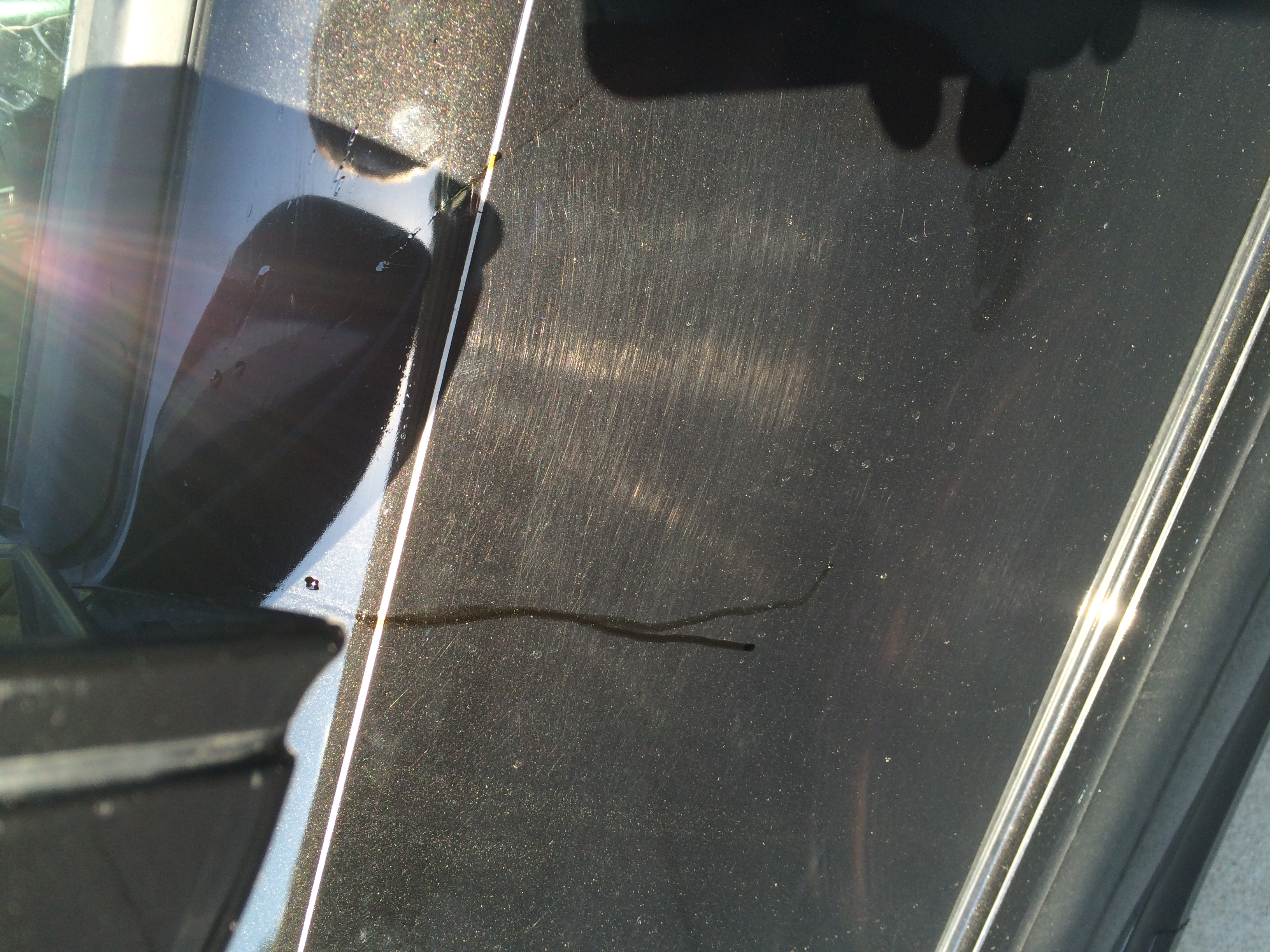

It looks like the liquid crystal in the driver's side mirror seeped through a crack in the bottom right corner and dripped on the paint. Ugh, not good for the paint. Im going to wash the car and assess what I can do, probably a light 3M rubbing compound will take care of the marring. Im going to remove the outer layer of glass and drain off the remaining fluid, which should leave a mirror just like the passenger side.
