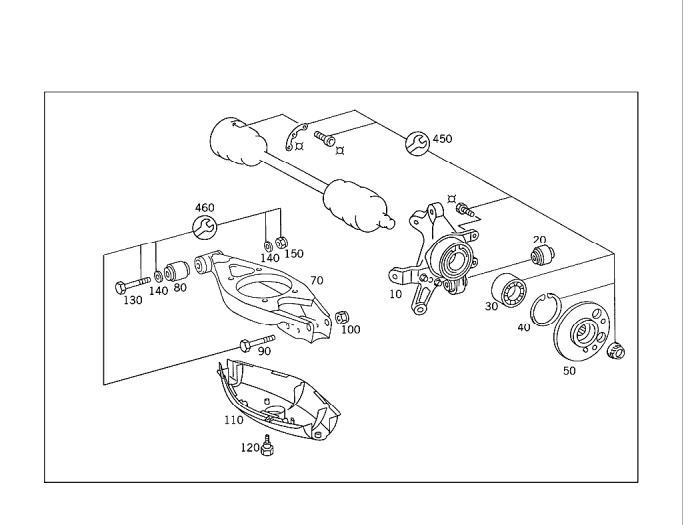

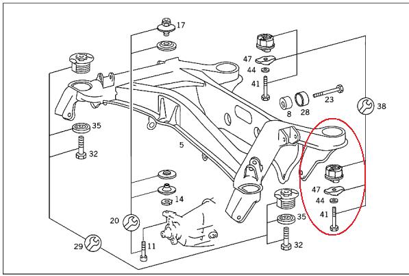

Old Nov 7, 2016 | 02:50 PM
fredtga's Avatar
Joined: Aug 2007
Posts: 344
From: Los Angeles, CA
w202
Subframe:
Forward bushings (#29 on image) (2x) : 1243500341
Rearward bushings(#38) (2x) : 2023503408
Differential bushings(#8) (2x) : 2023511142
Rear suspension:
Rear Outer in Rear Bearing Knuckle (#20) (2x) : 2203520227
Rear Inner at subframe in LCA (#80) (2x) : 2023520065 (these rarely go bad)
Attached Thumbnails C43 - bent subframe-subbush.jpg   C43 - bent subframe-suspension-wheel-bearing.gif

knuckle bush sits in the rear hub
it's called squeak bushing
