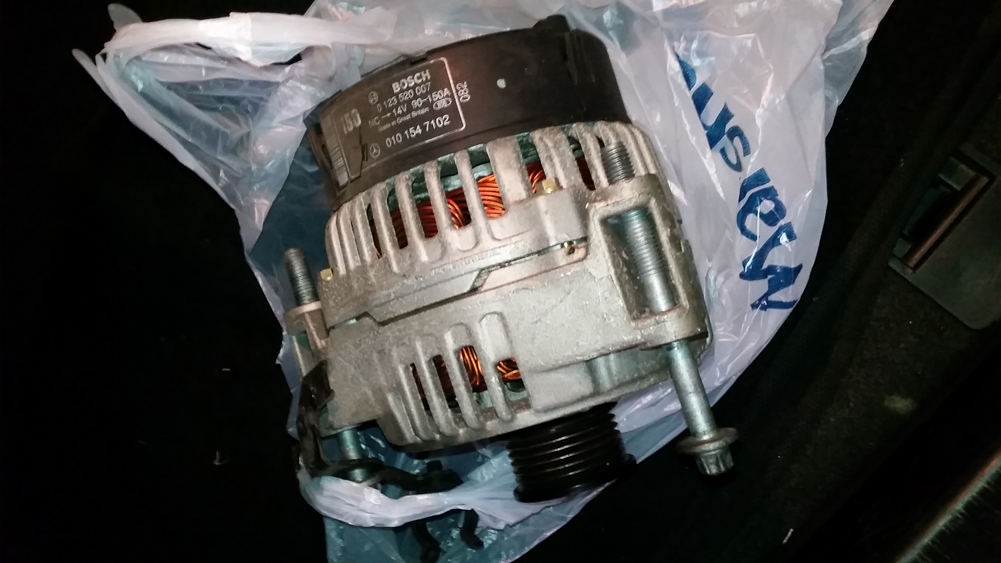

Yep hopefully.
Got the one off my parts car...looks almost new.
Old Dec 21, 2016 | 10:16 PM
  #50
sick430's Avatar
Joined: Sep 2006
Posts: 1,946
Likes: 21
From: So Cal
CLK Cabrio
yeah that one looks great! hope this fixes your problem.
