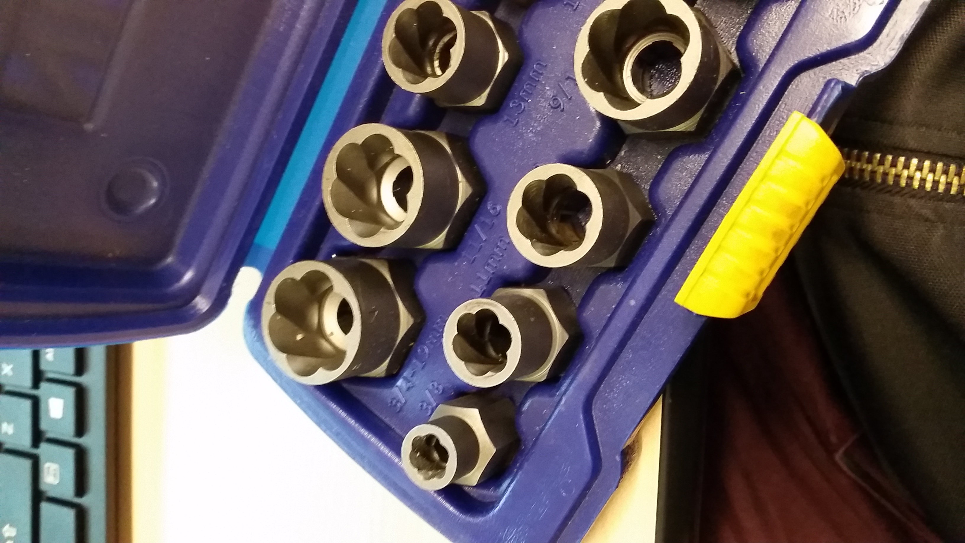

Hopefully ill be able to get the cps bolt out with this.
Good choice. Those extraction sockets are great!
