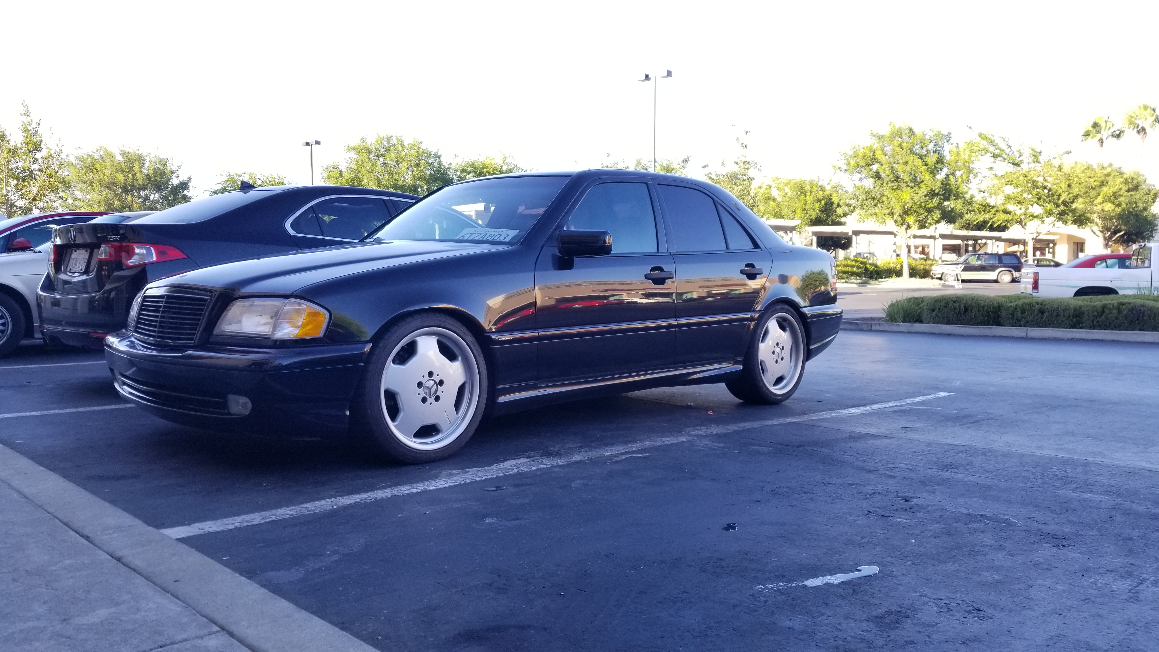

Pic of the car as it sits right now(I raised it)
Attached Thumbnails Been driving with the custom airbox setup-20170721_190014.jpg
