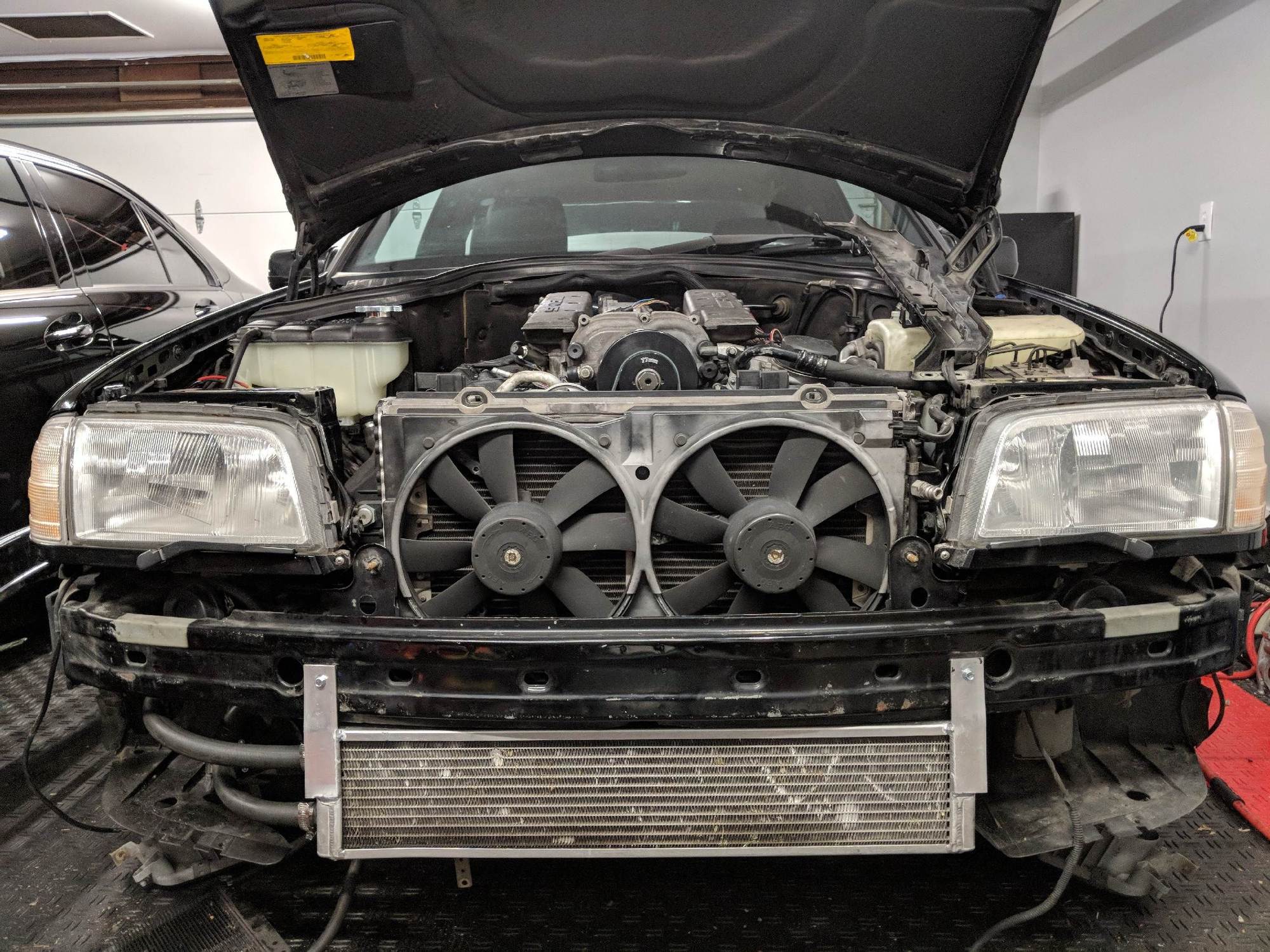

Im the guy from Facebook with M113k Swap. We still have a ways to go with the tuning. Just completed C32 brake swap

to answer your question, I am running it with the stock ME2.0 tuned by EUROCHARGED. Using a MAF. So I didn't swap the e55 ecu etc. But i am using the engine, with a custom oil pump setup and the trans (722.643)

I have a one piece billet block off in place of the bypass throttle body, also running a solid front pulley. So no regulation of boost is possible other than throttle input. Car is running and driving, getting few more things ironed out and custom exhaust built. Car drives great, shifts pretty hard ( likes spins the tires on a 1-2 shift with barley any throttle). Will have afr gauge on soon and will be able to figure out whats going on with the tune.
