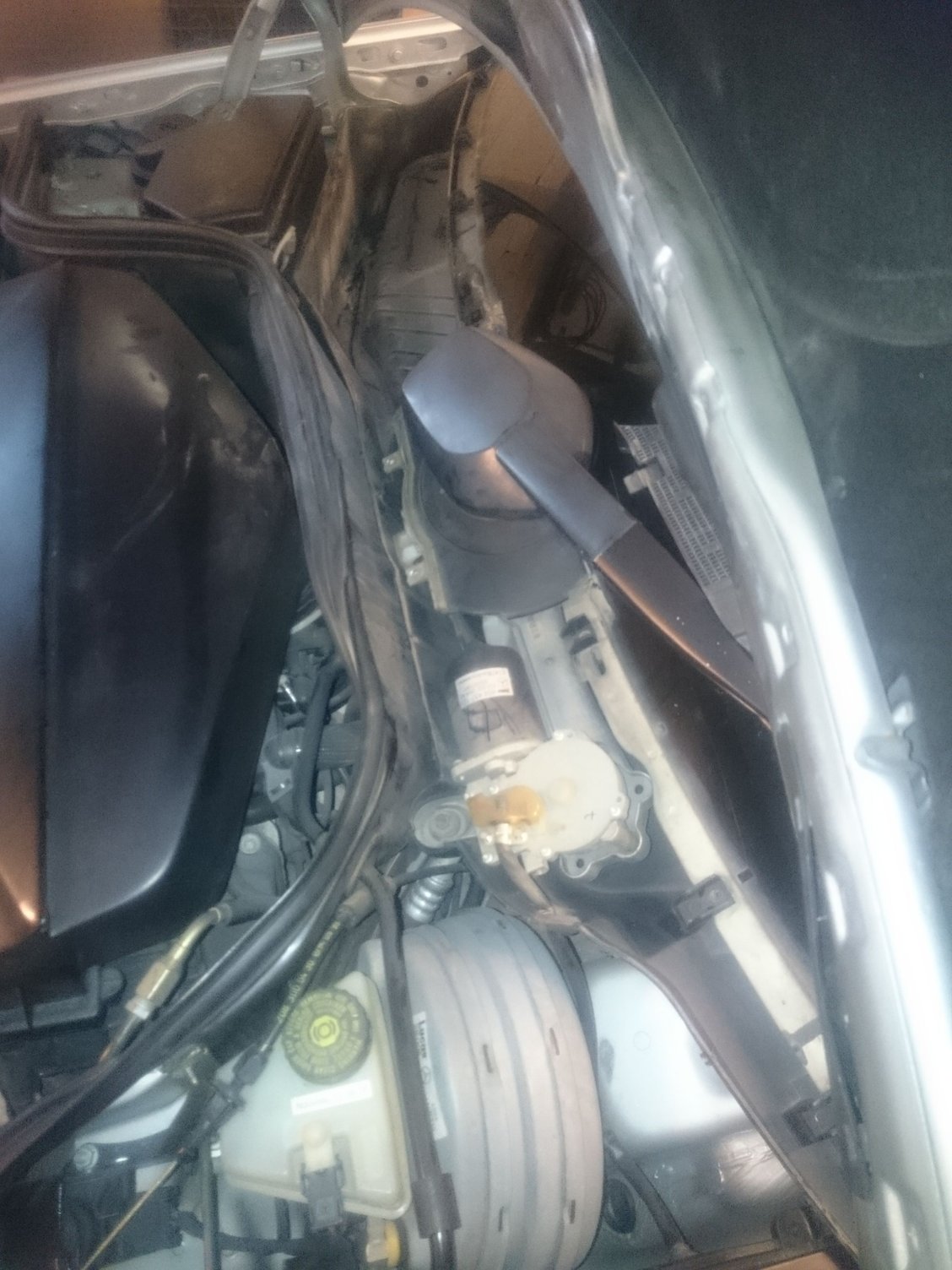

I removed all the lower windscreen trimmings so as to open all the area under the wiper and cabin air intake (see 1st photo). All the parts were then washed with some soapy water and a soft brush.

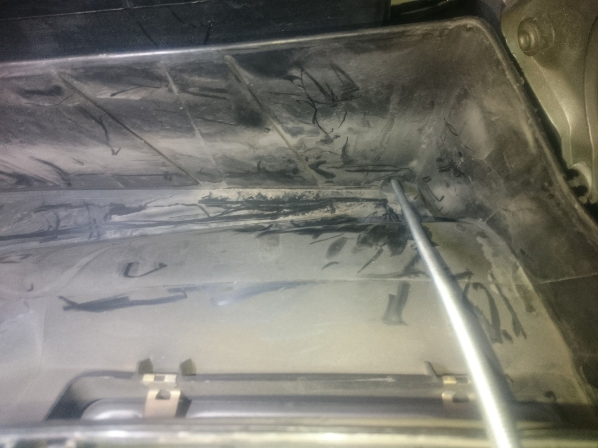

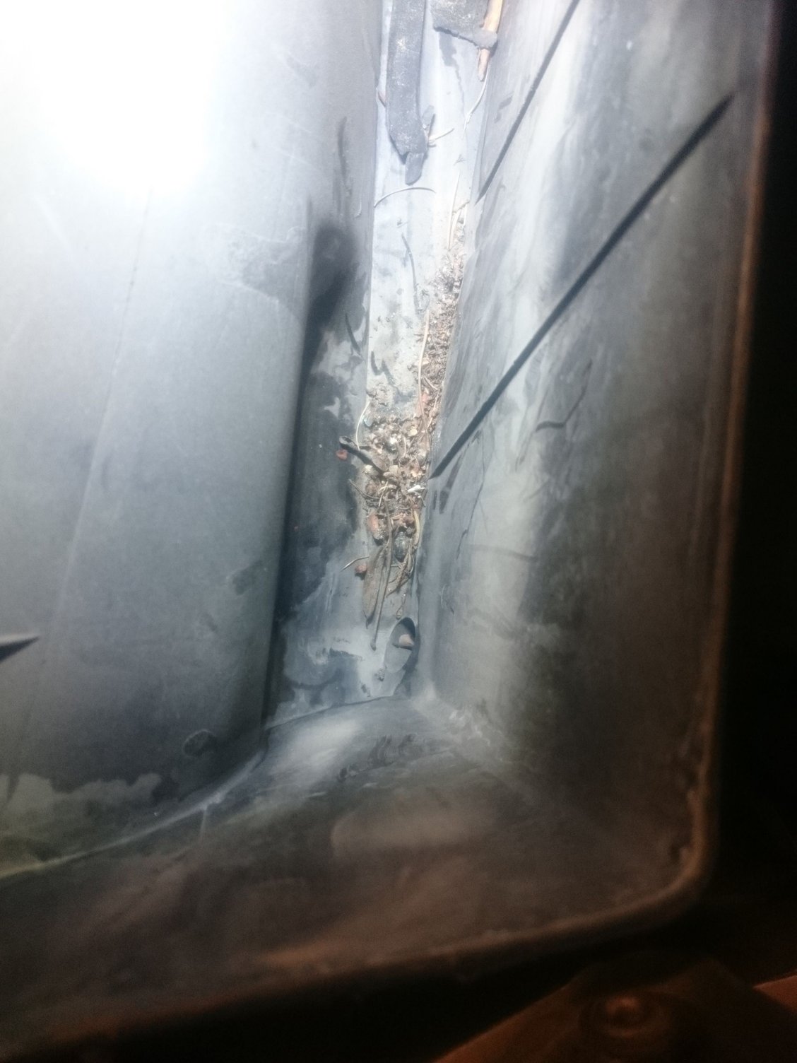

Looking down into the corner of the cavity, there was some small leaves and debris (2nd photo). That was quickly vacuumed out. Then onto the rubber drain with a flap on the outside to check it was dirt free. How to poke around down there? Easy, took my flexible transmission dip stick and pushed it in and out a couple of times to make sure all is clean (3rd photo). Perfect.

All the trimmings removed, then washed in soapy water before reassembling.
Some small debris and nothing major. The drain hole can be seen in the lower right of the trough. Guess that speaks for having the vehicle in a closed garage and not parked under trees
Transmission dip stick. Perfect poking tool. Just make sure you clean it before inserting in your transmission

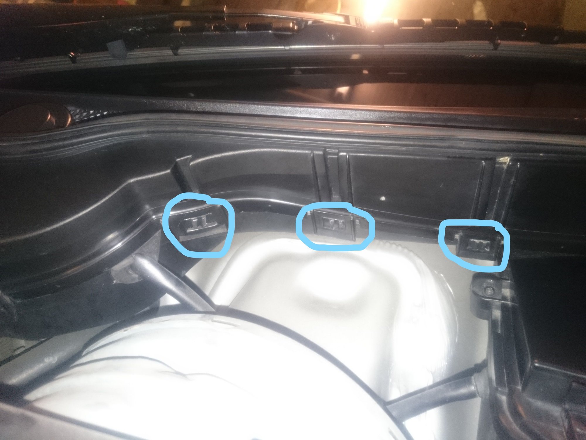

If you are talking of the holding clips along the edge of the cover on both sides like in the image below, yes I did. Gently prise them forward with your finger or flat head screwdriver to de-clip them.
Yes that's what I meant you had to pull the clips to remove both L - R side top covers to access debris in the box.
