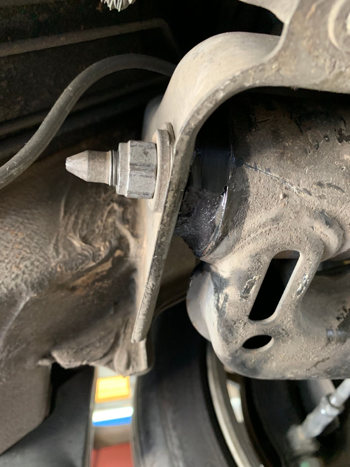

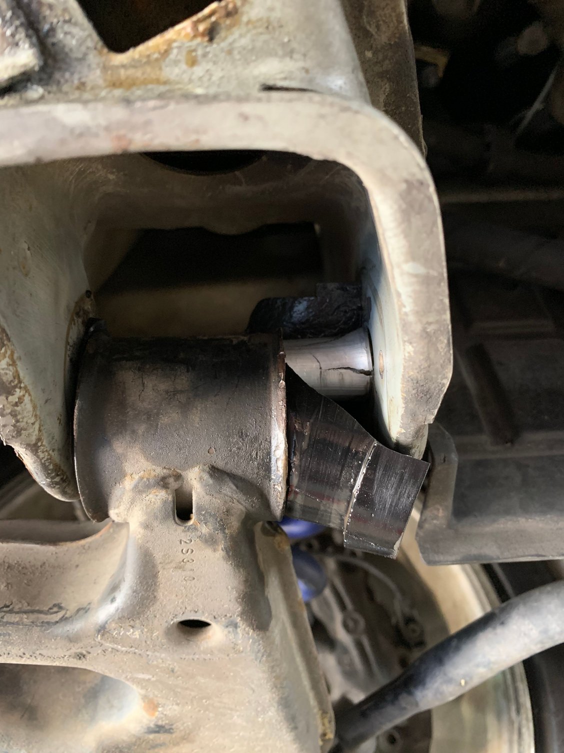

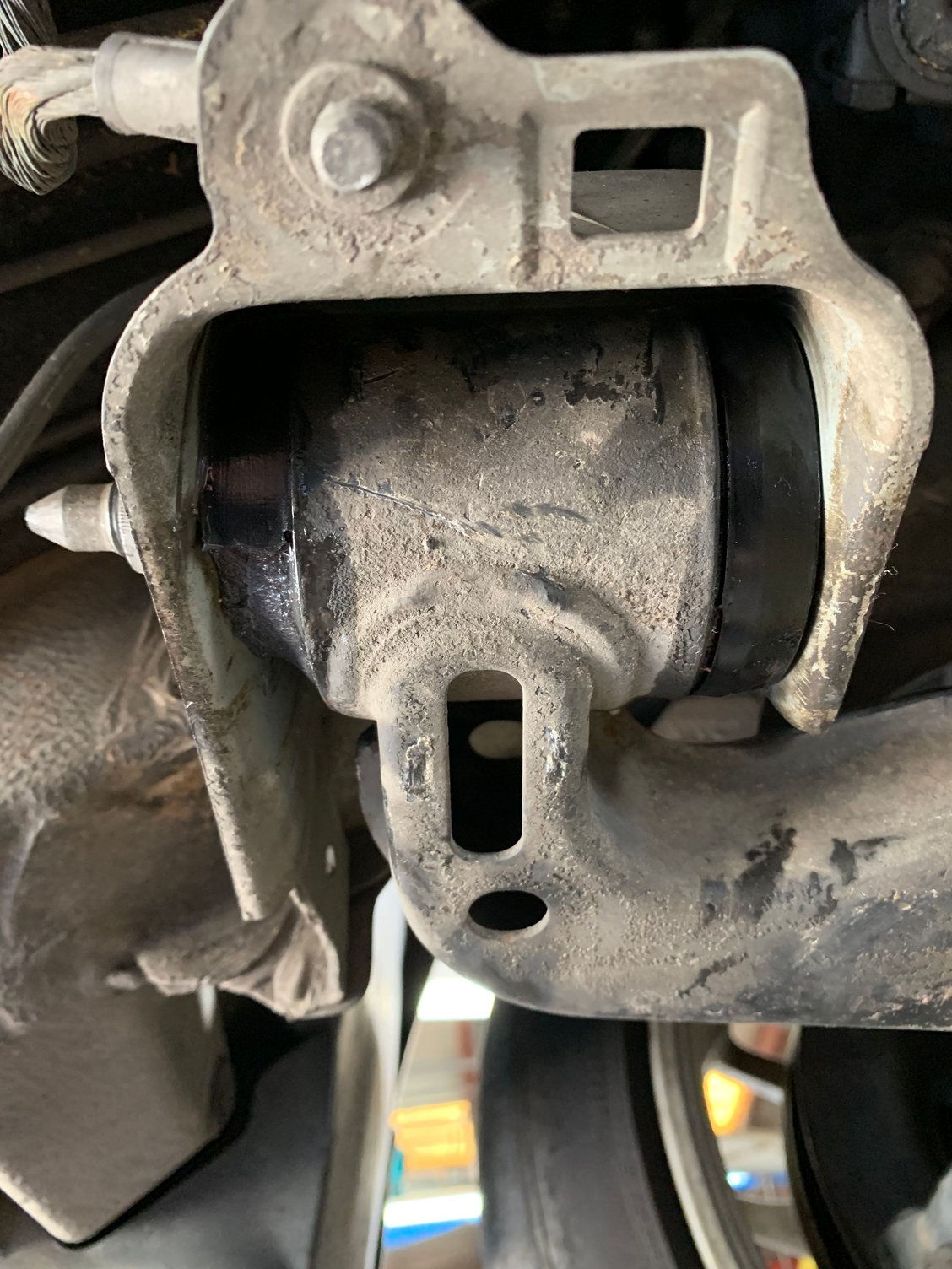

My car is low and has about -2 degrees of camber. My factory rubber bushings were torn and I looked for a poly replacement to help with feel and feedback. The options were Kmac, Powerflex, or Armstrong for what I was looking for. I decided to try the Armstrong and it has been a nightmare. I installed them on Sunday and by Tuesday the lip on the left side rear bushing had torn allowing the arm to move back and forth. So I send as message and the company is perfectly willing to send a new set and say they’ve never had a problem. Since we only have two cars at the moment I had to take it to work today and the front bushing on the left side had completely split and the metal sleeve had cracked when I braked for a stop! I was almost to work and just limped it in (I work at an import specialty shop). I would never recommend these to anyone ever. The material is way too soft and the lip does not hold the car. I installed them the correct way and lubricated them. I made sure there were no burrs anywhere to tear the bushing also. I told them I want a refund and nothing more. They were fine with that and paying shipping. I want to believe they’re just defective but I don’t think that’s the case. They’re customer service has been good but the product is not.

Looks like they are low quality poly bushings?
If they wore out within 2 - 3 days they are weak parts with inferior materials

I looked the brand up and couldn’t find much on them but no one said anything bad so I gave them a shot. They were by far the cheapest option out there for poly and now I see why. I have seen the strong flex stuff and it all looks good too but I didn’t know anyone using them. They make some sway bar bushings and upper control arm bushings I’ve been eying. I ended up going with the Powerflex ones since I need the car back ASAP. I went with their race spec front and rear so we will see how these go. As I said I push the car regularly so I want the more solid feedback and feel

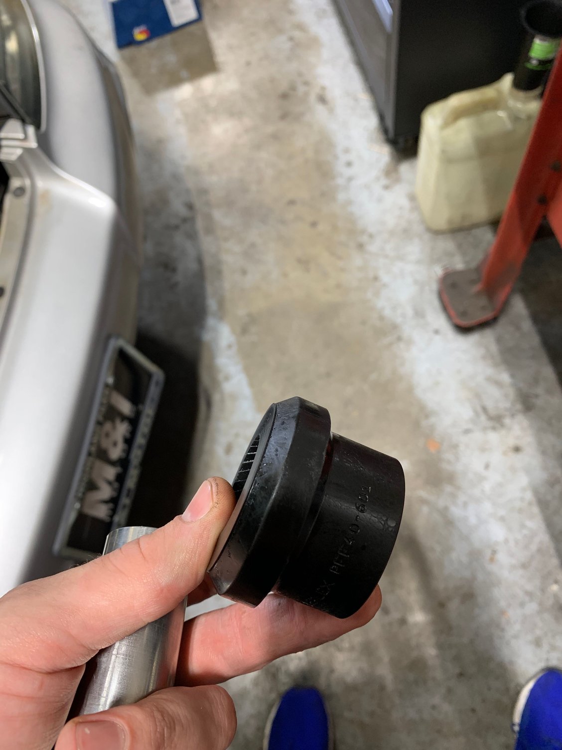

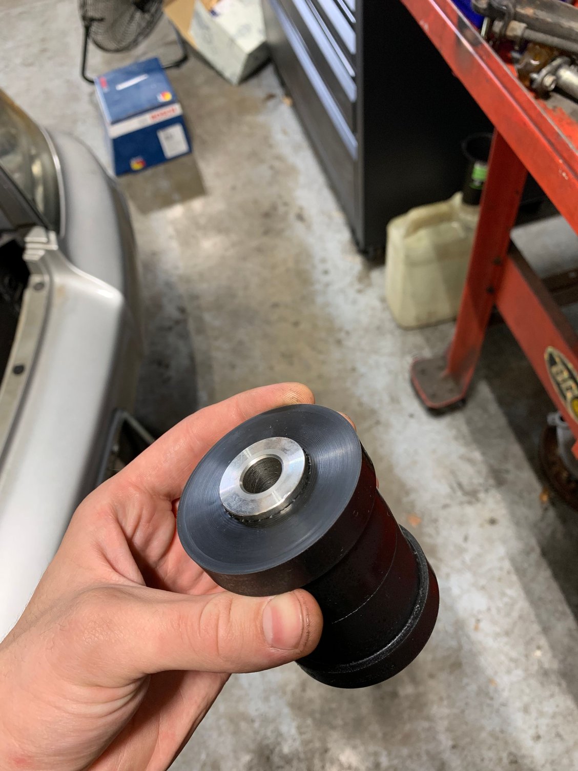

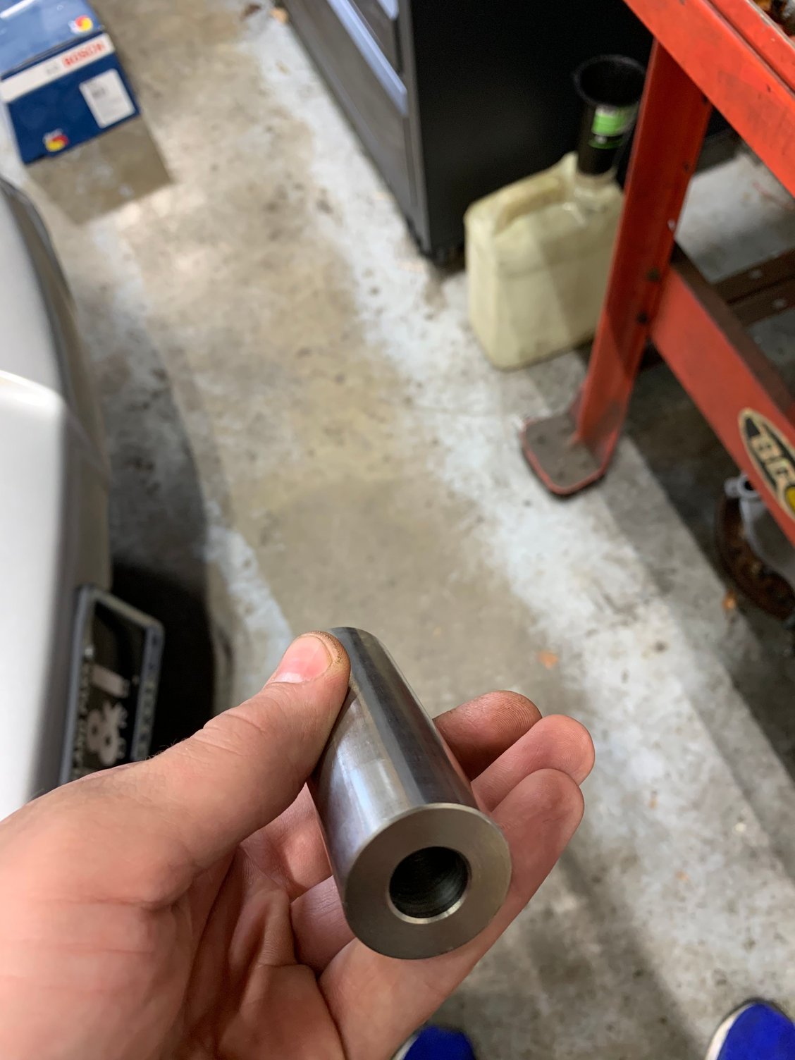

Got the Powerflex ones today. I’ll be putting them in later. They are massively more beefy. The sleeve is close to a pound if not a pound. The poly itself is much harder as well. Should have done this the first time 😂

Indeed looks beefy. BTW are they greased? If not, I recommend you doing so when installing with special grease (silicone?). That should keep the squeaks away

They came with two little tubes of it so they are definitely lubed. The inside where the sleeves sit is webbed so it catches the lube it looks like. I love how the car feels with them. I can’t believe people thought the Armstrong’s were too rough based off the very few reviews I could find. Those were much much softer
