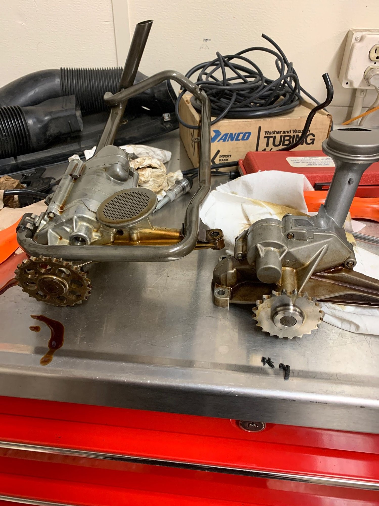

I'm having an issue doing a 5 liter swap on a 4.3 L car the oil pump is run on the timing chain and the timing chain sprocket on the 4.3 L seems to be smaller

When I did a test fit with the 4.3 L oil pump I seem to have excess slack in the chain on the 5 L block please let me know if there's a way to work around this I was informed that if I installed the 4.3 L oil pump that the tensioner would take up the extra slack on the 5 L block

My oil pump picked up some rubber substance from the oil pan and clogged the entire oil feed system

the oil pump pickup also has a crack in it which necessitated the swap to move to a 5.0 engine and the 5 liter engine has .7 more displacement so the torque figure should be higher than the 4.3 liter

It looks like someone used an extreme amount of RTV re-sealing the oil pans or timing cover. Ended up clogging the oil pump I still have the C43 oil pump from my swap if needed. Don't know anything about the gears though. Would a C43 oil pump and chain solve the problem? Or remove a link? If my memory is correct the chain for the oil pump is ONLY for the oil pump so it wouldn't impact the valve timing. It would be a C500 not a C50. 2 digits are for AMG engines.
