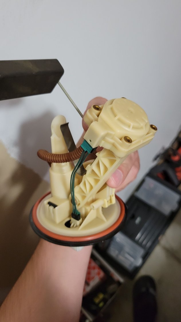

So i got a spare fuel sending unit from the passanger side and it does say Pressure Sens on it.
Im trying to figure out if that means that thebpressure sensor is inside it or that thebconnectore there leads to a sensor somewhere else
Old Apr 12, 2021 | 03:55 AM
DRBC43AMG's Avatar
Joined: Mar 2010
Posts: 5,892
Likes: 324
Never seen this unit in my vehicle, but looking at the pic, I imagine the sensor must be inside, but not sure. It looks like a floater attached to the unit. You say passenger side, but where does it mount to, or does it live inside the fuel tank? It does have two separate connectors so must have a dual purpose
Old Apr 12, 2021 | 10:17 AM
PJmak's Avatar
Joined: Sep 2007
Posts: 4,566
Likes: 421
There are two sending units like this ^^ on the bottom of the tank. You'll find small plastic covers roughly in front of the rear wheels one on each side held by three screws.
This above is the passenger side which apparently has a fuel pressure sensor built into it. Yes there are two connectors and I agree. The other side of the part has a small circuit board with two small wires going to the other connector so thats for sure the float level sensor.
This side above must be the pressure sensor, I don't know what else it could be.
The brown tube going out of it comes out to the bottom of the sending unit(see pic above right above where I circled it).
Note: these are basically inside the tank at the bottom so when pulling them out the tanks must be drained.(The metal allen wrench part can be taken out and it reveals a valve sort of drain). When you push inside the valve it'll start draining fuel.
I also read that this is just on the USA models but not sure.
Heres a pic of the other side.

This is the Right side level sender unit, only with 96-01 "U.S & S.Africa" versions,
usually this pressure sensor not damaged or not common issue, with fuel system,
so weird if it went away..!!?,,
MB part #: "202 470 30 41", then replace it in (Nov/2009) with:-
*MB #: "208 470 06 41"
*Continental/VDO #: "2218 3900 2003Z"
-;-ZAYED-;-
