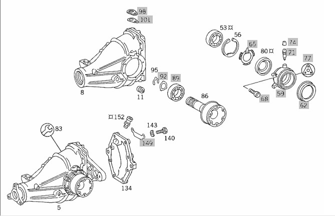

I would like to ask is what parts should I replace with it,I've read that the bearings are a must for sure, I would normally do something like this myself, but want to be honored with the warranty, so I plan on having all the parts available for when I take it to a reputable shop. I have attached the EPC components hoping the knowledgeable can pick some numbers for me.
If there is any other variable that I may be missing, please let me knw. My plan is to make this go by as smooth as possible.

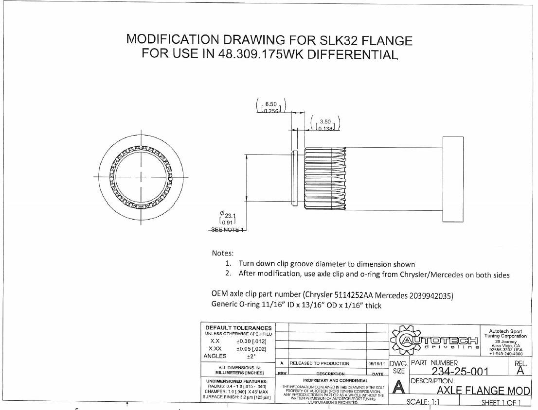

No - the 210 is bigger and won't fit. You need the one that is more typically advertised for a Chrysler Crossfire or SLK. It's part # 48.309.175WK.
FYI - there is a slight modification to the flanges required.
See here:
https://autotech.com/images/F198644058
See here:
hi, can you please provide more info on this modification.
