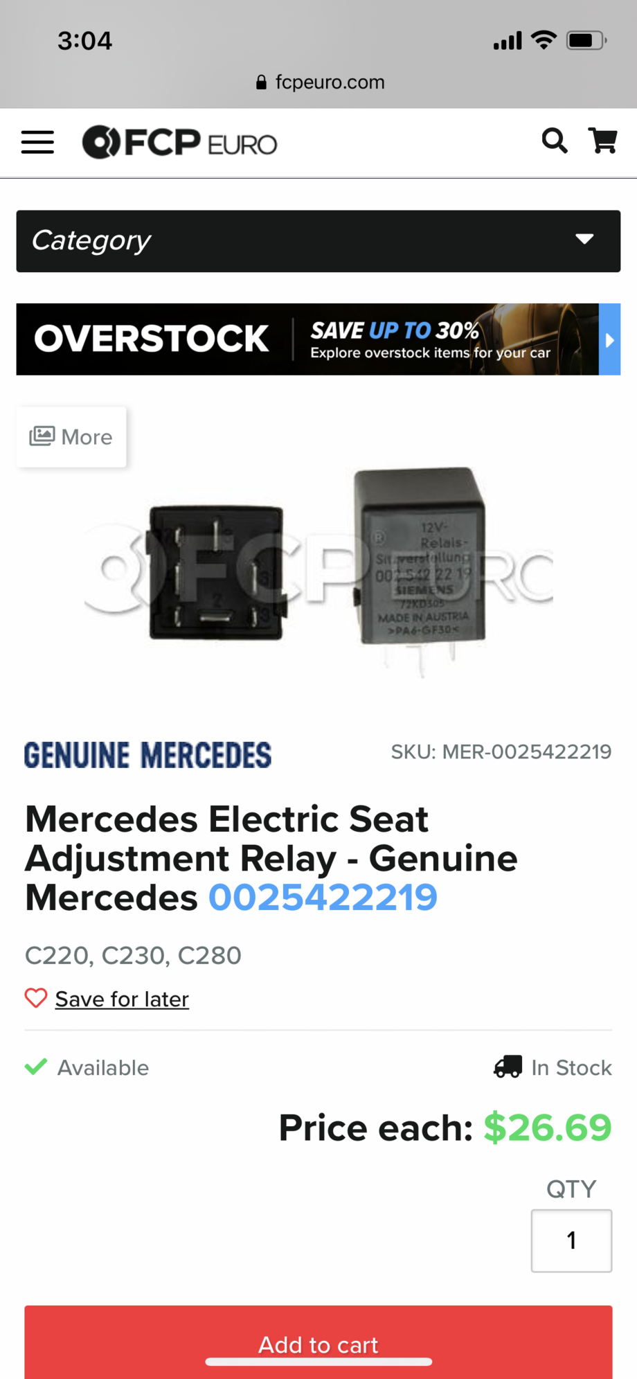

Did the power seat work intermittently before it failed completely? Could be the power seat relay in the trunk. My mom’s 2000 C230K had that issue.
DRBC43AMG’s thread

Someone mentioned the seat relay above. It could easily be that but also check nothing is jamming he seat.
DRBC43AMG’s thread
Thanks for the reply. Seat was working fine. Than one day it would not go up. It goes forward, back tilts etc.. just not UP. I have another c43 so I will swap that relay and see what happens. Thanks.
Old Oct 19, 2021 | 04:34 PM

Originally Posted by PJmak
I can say roughly they are at least 14mm wrenches or you can use sockets.
Ok I will have sockets and wrenches from 14mm and up.
Seat is not stuck for sure. Going to try relay and see what happens. Thanks.

P.s I swapped the relay and still didn't raise the seat.
