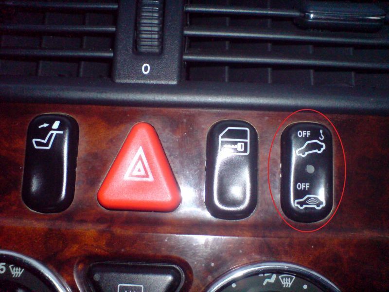

Had this issue on mine when the car is in the garage: for a few months at a time without starting.Ate a few batteries when i learned that if you turn off the anti theft ie switch on dash with tow hook icon,it solved my issue.

This guy?
Just start the car, flick it to off and turn the car off and thats it?

This guy?
Correct

I dont have that button
Was it an option then? Didn't think so but seems it was. Perhaps in N. America only?

This shows on the my VIN data card
551 ANTI-THEFT/ANTI-BREAK-IN WARNING SYSTEM
I heard 98 models alarm system is completely different vs the one in the 99

On 98 NA cars don't have this option from factory only 99 cars have it stock.

This anti-theft & towing system can be found "as optional" with these following models:-
*97-00 "W202", with code: (552/882)
*98-02 "W208", with code: (F882)
*96-02 "W210", with code: (K552/882)
*98-04 "R170", with code: (551/882D)
