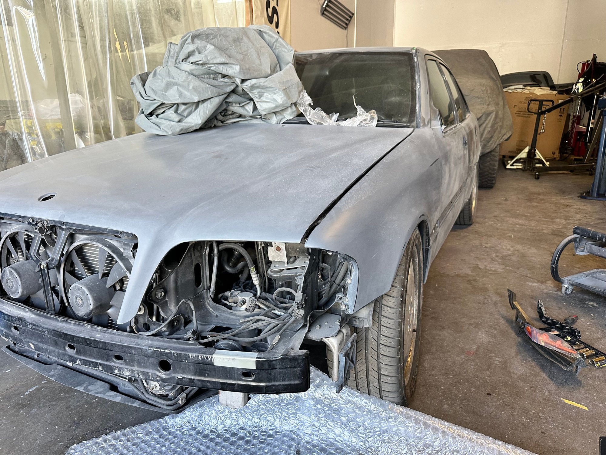

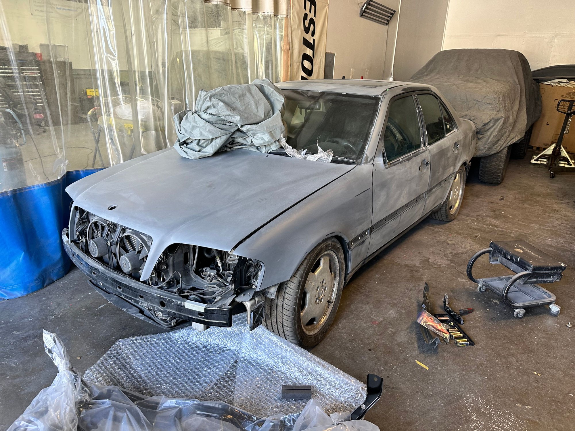

Old Apr 27, 2025 | 12:55 AM
  #64
mbdreamr's Avatar
Joined: May 2006
Posts: 184
Likes: 38
From: Bay Area, Ca
1987 190e 2.3-16 sold and missed, 1966 220s, 2016 GL550, 1999 C43, 2006 CLS 55
Update
So the car has been at the body shop now a month. They’ve sanded are working on it slowly, a bit at a time but it’s coming along.
the car was sanded, now primered and will be blocked and then paint and color sand.
I decided to have it resprayed in Obsidian black. I’m not planning to sell the car and it’s going from black to obsidian black.
I snapped a pic today as I stopped by to see progress.
I also bought all the clips for the side skirts including the small rubber molding at each end of the side skirt.
In the mean while, I also acquired a 1999 SL 500 that I got for a steal. I got suspension for it. Waiting for the wheels to come in to lower it, change the lower control arms because the ball joints have failed. The replacement control arms came with bushings and ball joint.

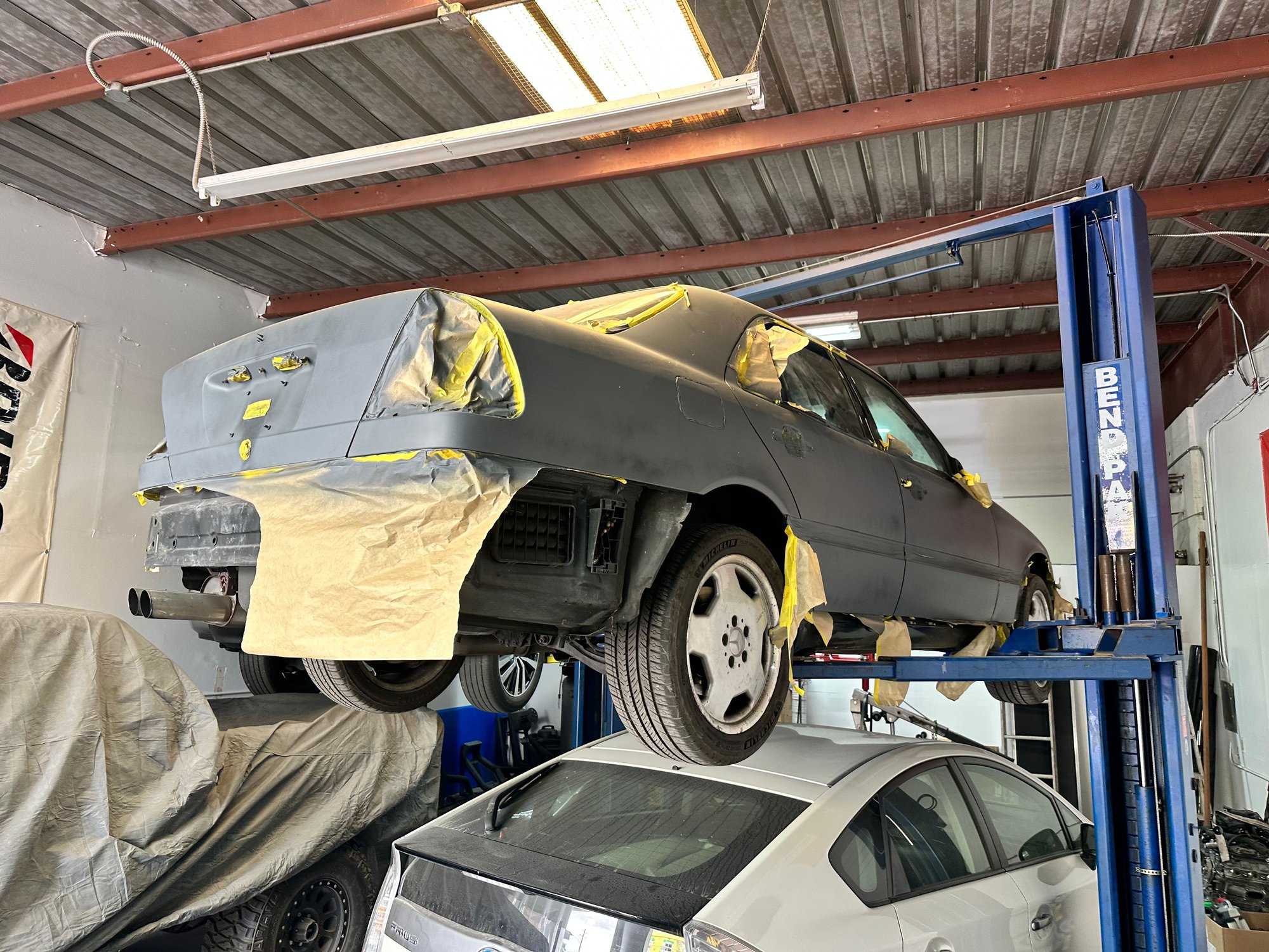

Old May 24, 2025 | 07:44 PM
  #71
mbdreamr's Avatar
Joined: May 2006
Posts: 184
Likes: 38
From: Bay Area, Ca
UPDATE
Car has now been primered twice and sand blocked. It is almost ready for paint.
