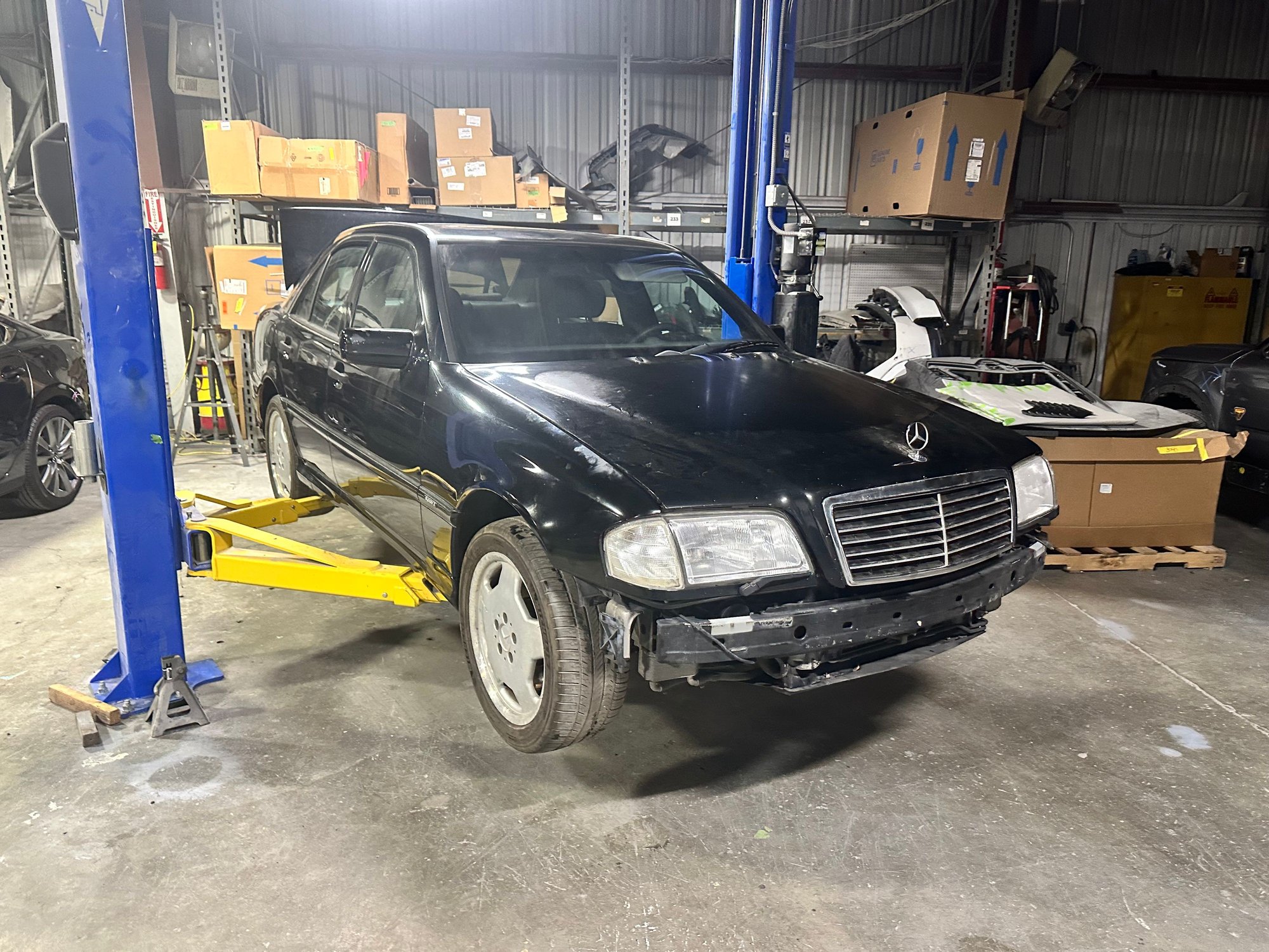

I had arranged to have the car picked up by a tow company at 4pm and they flaked on me. Didn’t bother to call or text. Luckily someone else we knew was able to come tow it at 7pm for a short 2 mile distance.
So the the car is finally at a buddy’s shop on the hoist. Tomorrow the work will begin and the engine will be removed.
I’ll have to swap over some parts like the intake, harness, engine mounts then back into the car.
had to remove the front bumper for the tow.
