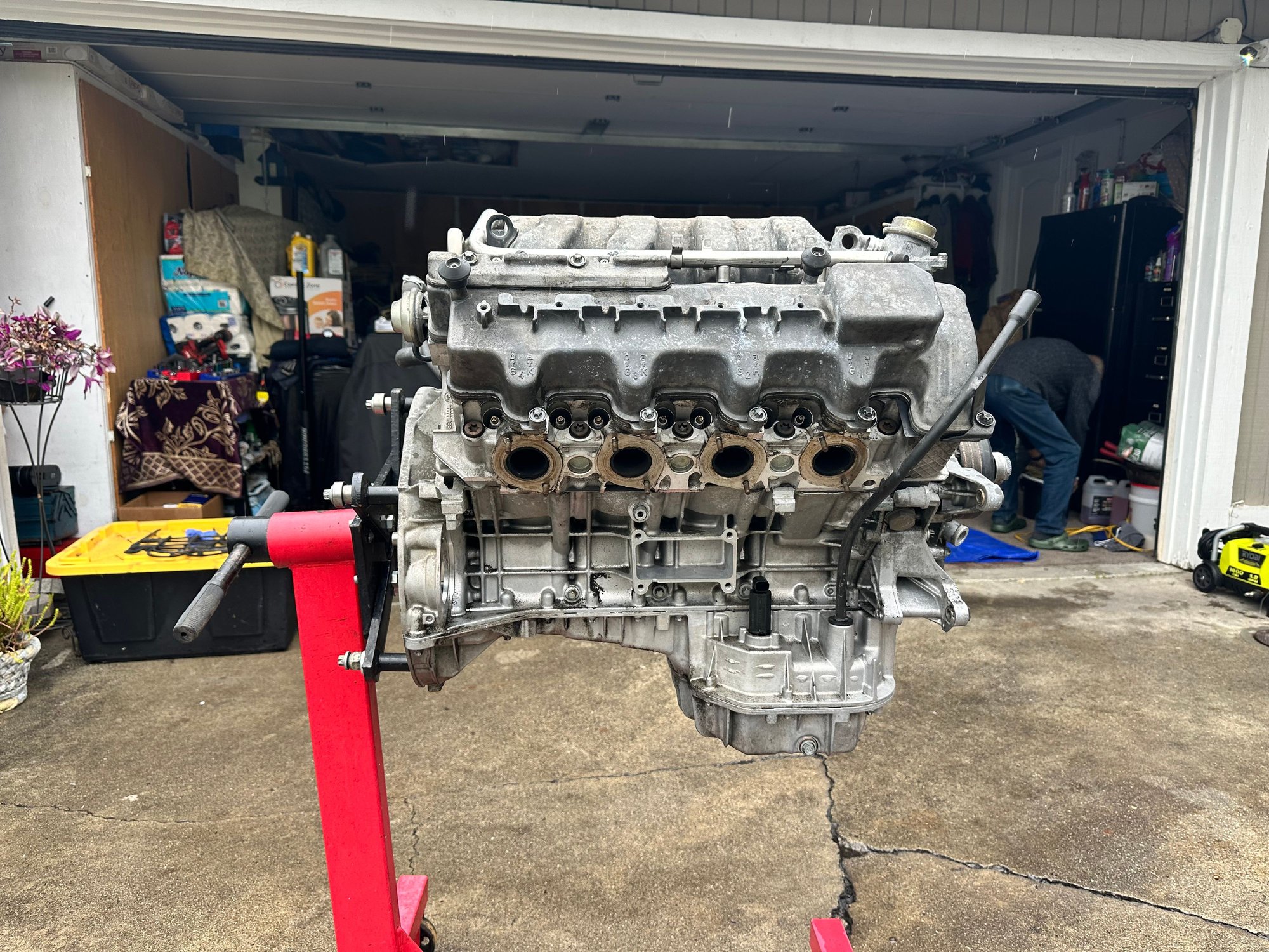

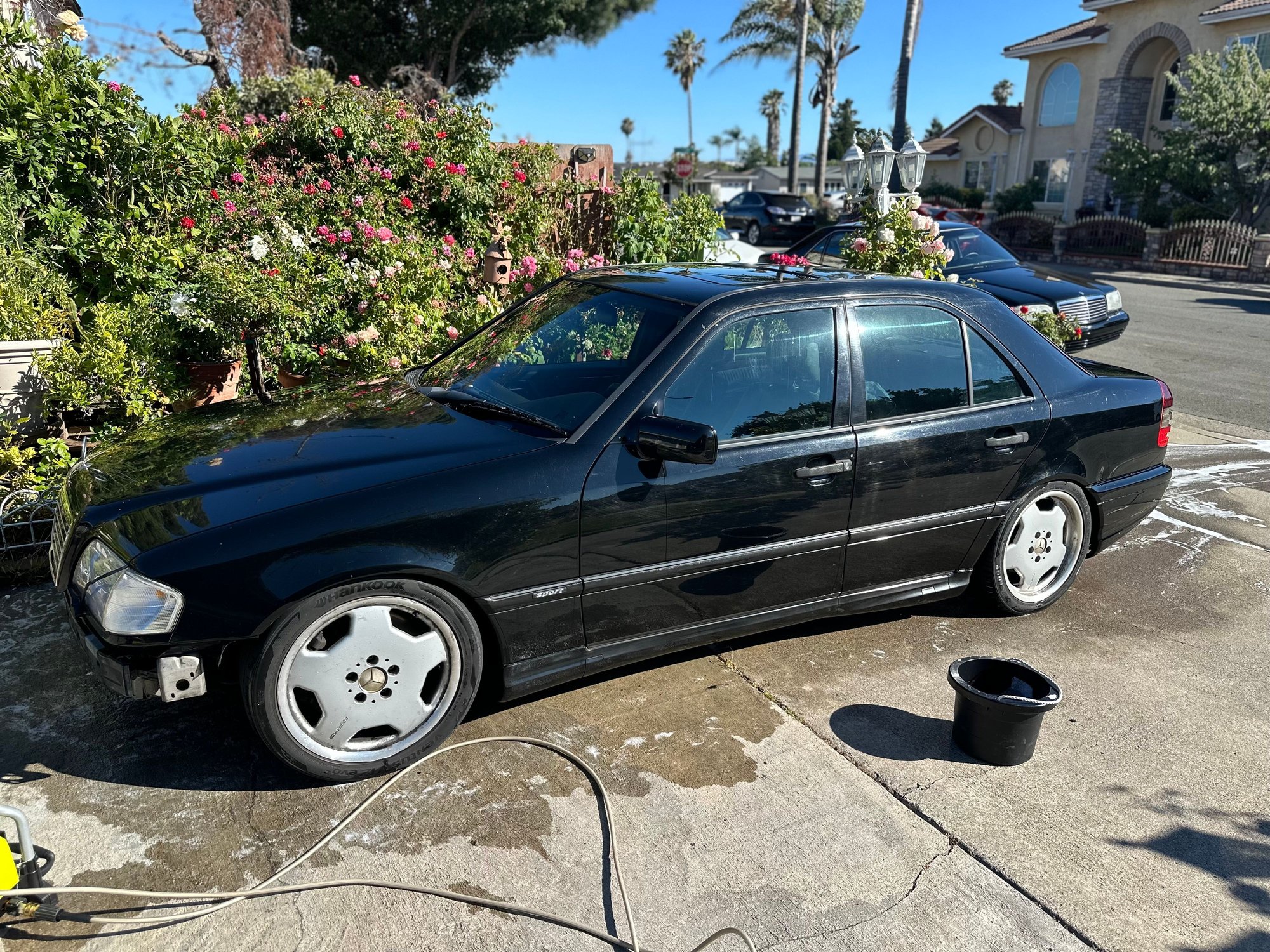

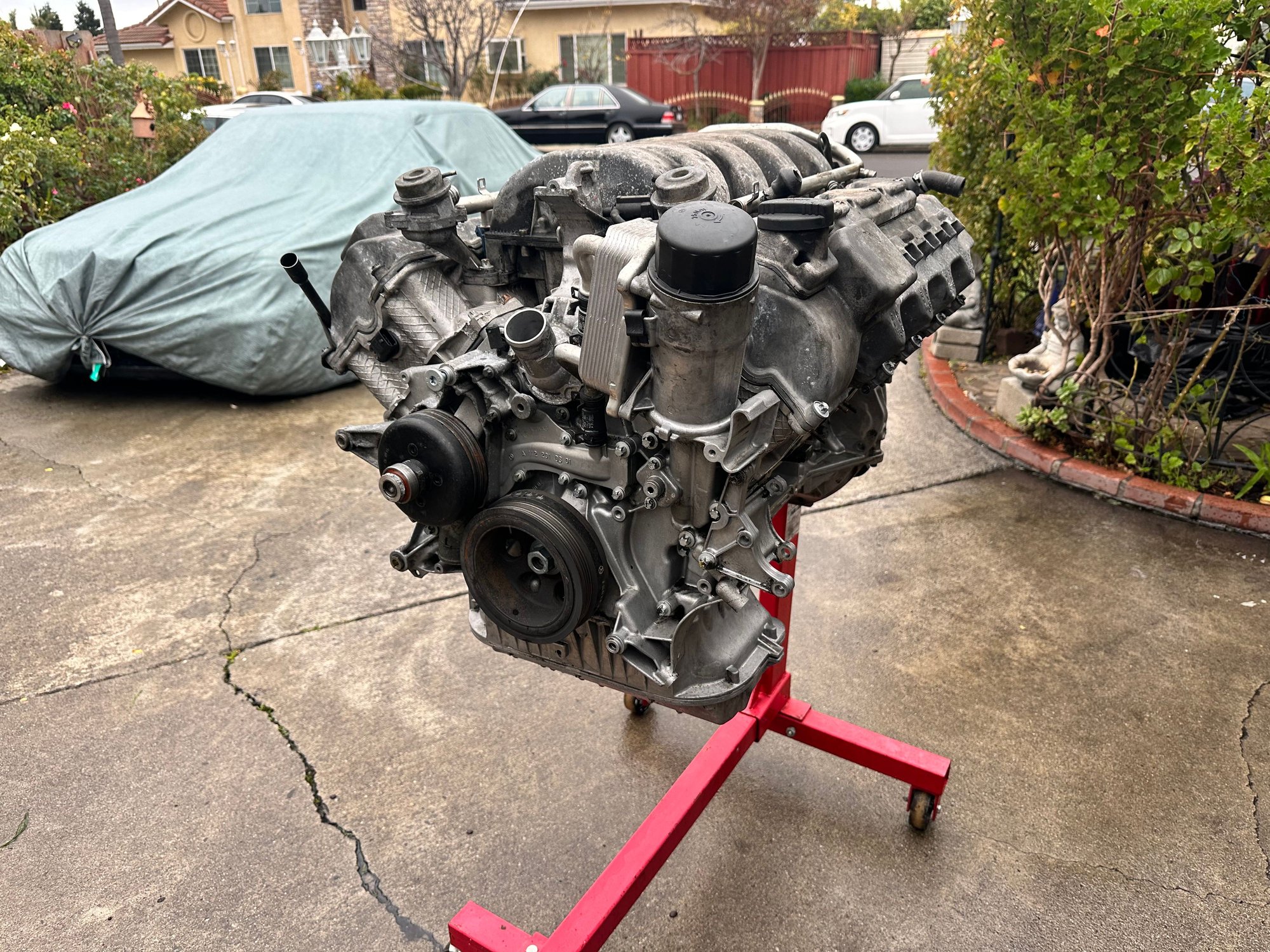

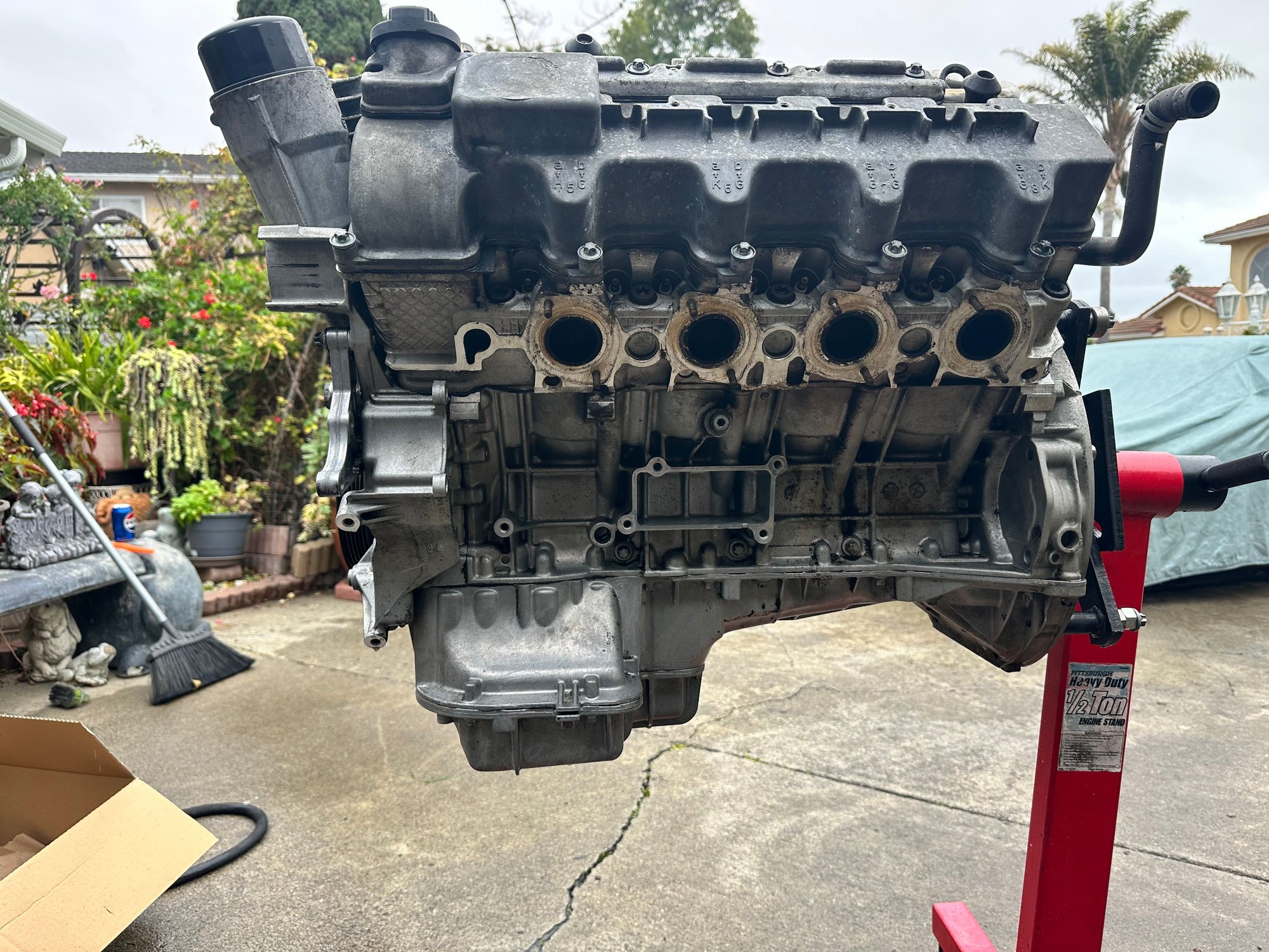

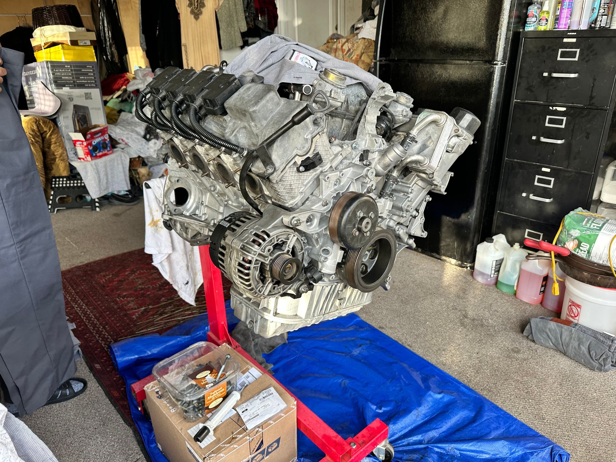

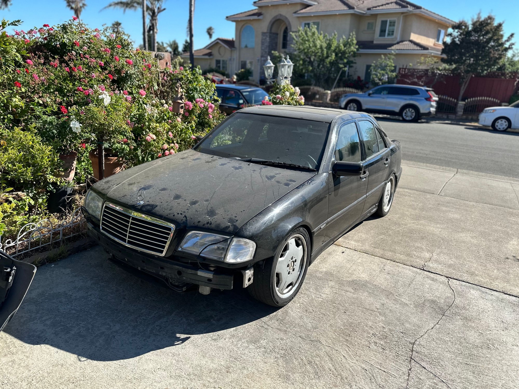

Back in the C43 202 game. Purchased this 1999 C43 while I was visiting Disneyland with the family. I had the car transported to the Bay Area. Car had a blown motor, so I sourced a 5.4 from a 02 E55. Changed all the seals, waterpump, thermostat, etc. also purchased the Speed43 airbox which I’ve used on my last C43 along with black series engine mounts to handle the 5.4.
Suspension is on some coil overs that has the adjustment caps removed so the car is slammed. I will be installing H&R with Bilstein sport shocks. For wheels I’ve always liked the look of the SL55 22 spoke wheels. I will be having them refinished and wrapped in Yokohama Advan Sport A/S tires.
I’ve got the motor done on the engine stand and plan to swap it out this next weekend.
I’m also debating on painting the whole car obsidian black. But for now I’m just taking it one step at a time and need to get her running and height fixed.
Will keep posting as it progresses.

That’s a great question on how the motor blew because it blew a rod on the drivers side. I’ve never seen catastrophic damage like that to the m113.
The previous owner had the car for about a decade or so. He said he was driving home and then out of no where it occurred.
For me, I was going to swap anyways so it wasn’t a factor, but interesting.
Running with too low oil in the sump, overheated, oil starvation and then threw a rod to get some cool air

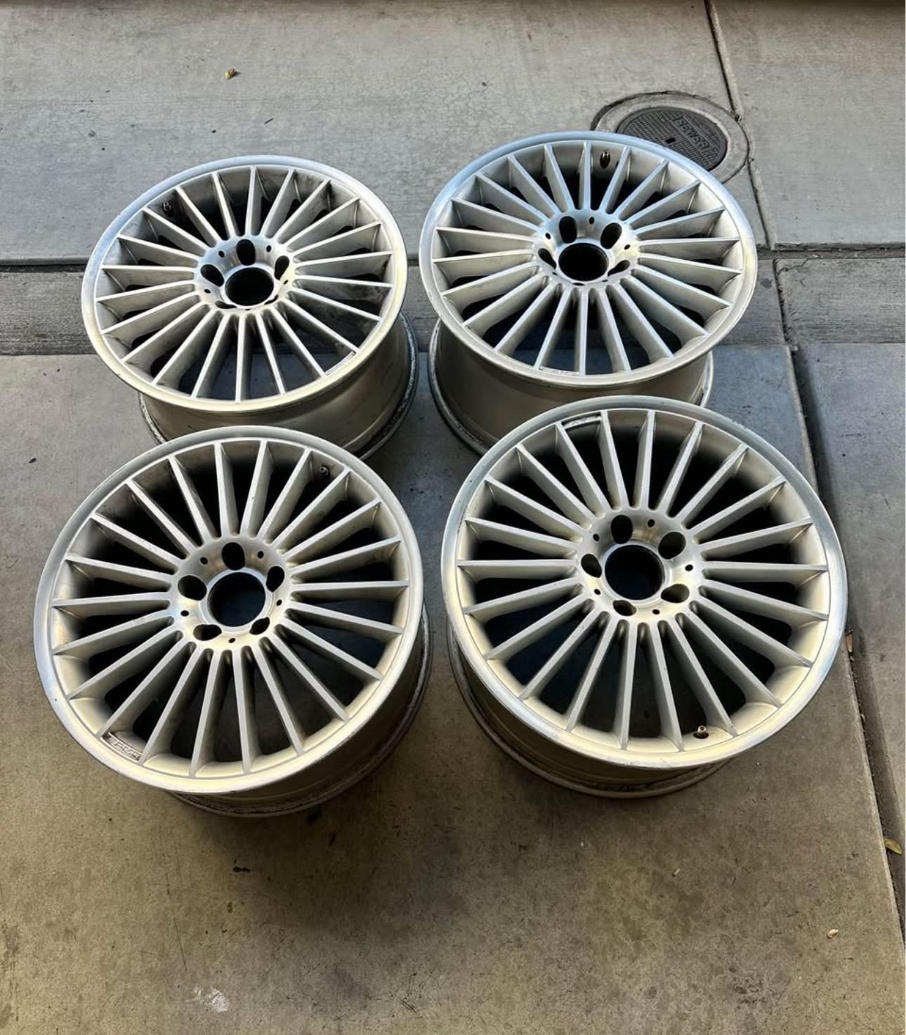

Here are my wheels pre-refinish
OEM SL55 22 spoke
18x8.5 30 offset front
18x9.5 33 offset rear
