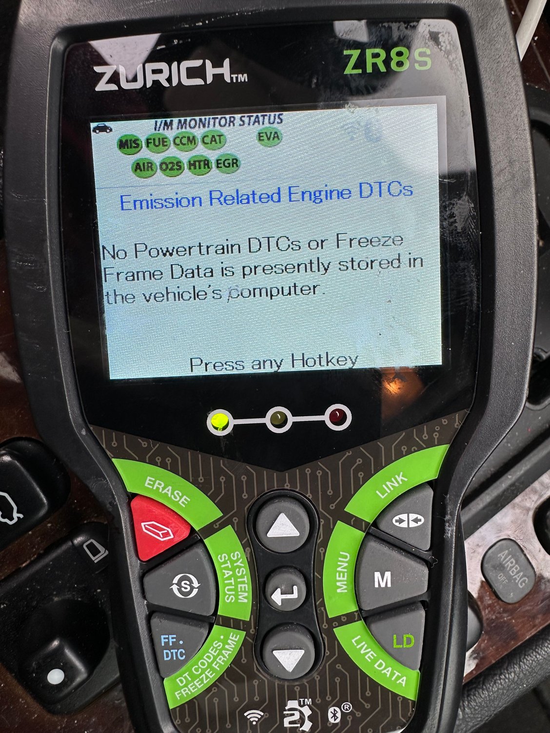

The weird thing is there is no check engine light and I borrowed a friends OBD2, plugged it into the reader under the steering wheel and there are zero error codes showing. No error codes and no CEL.
