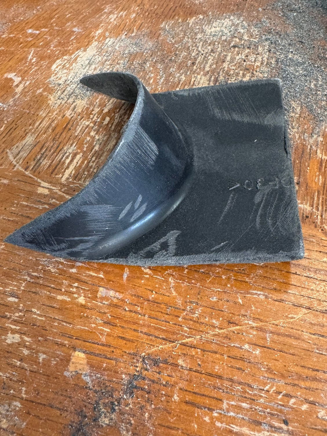

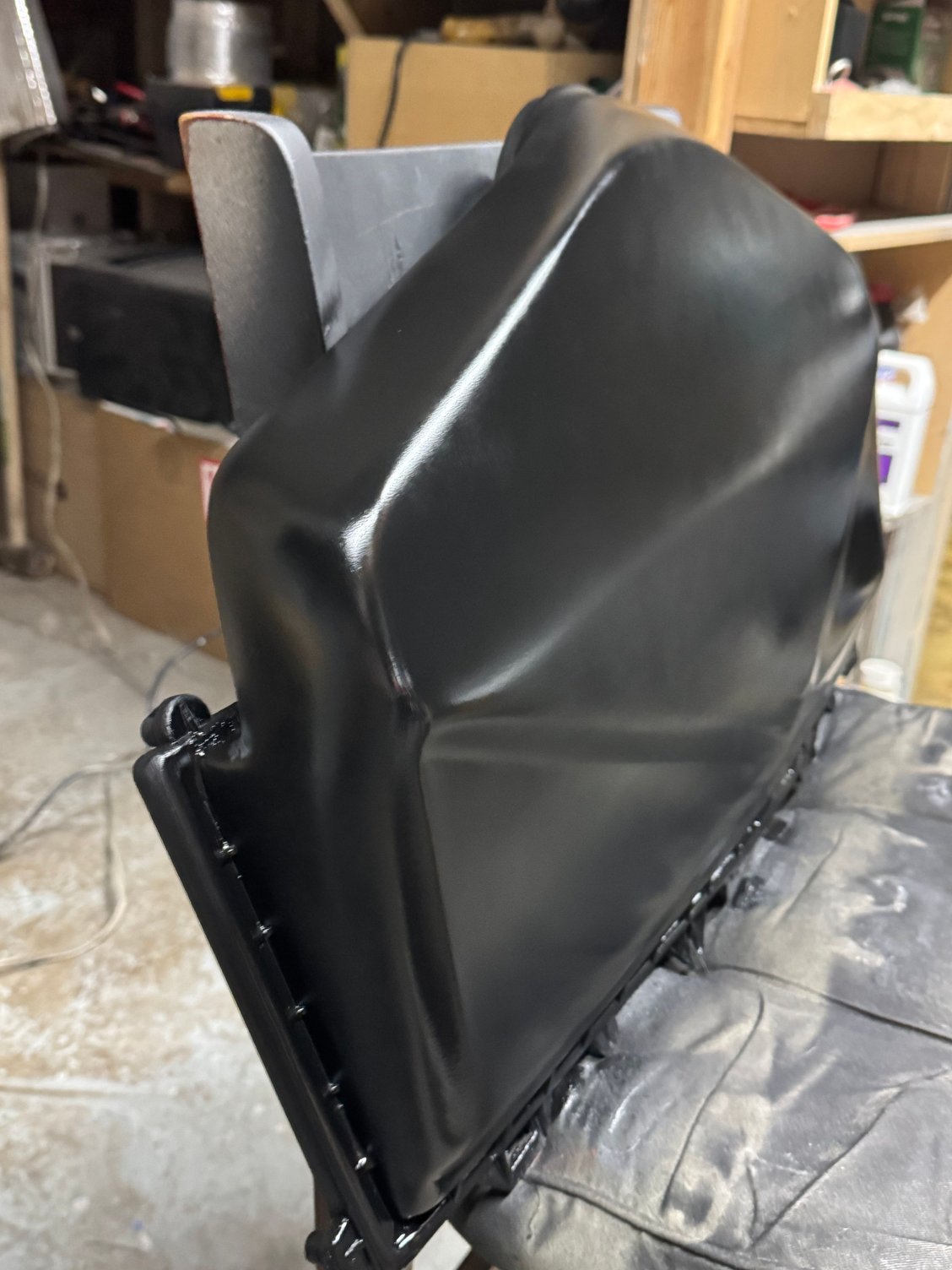

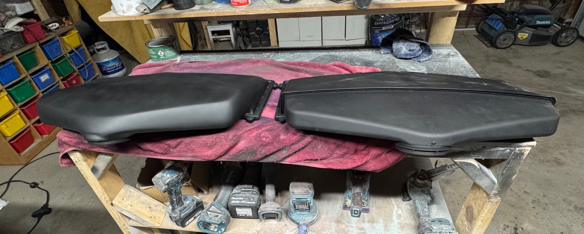

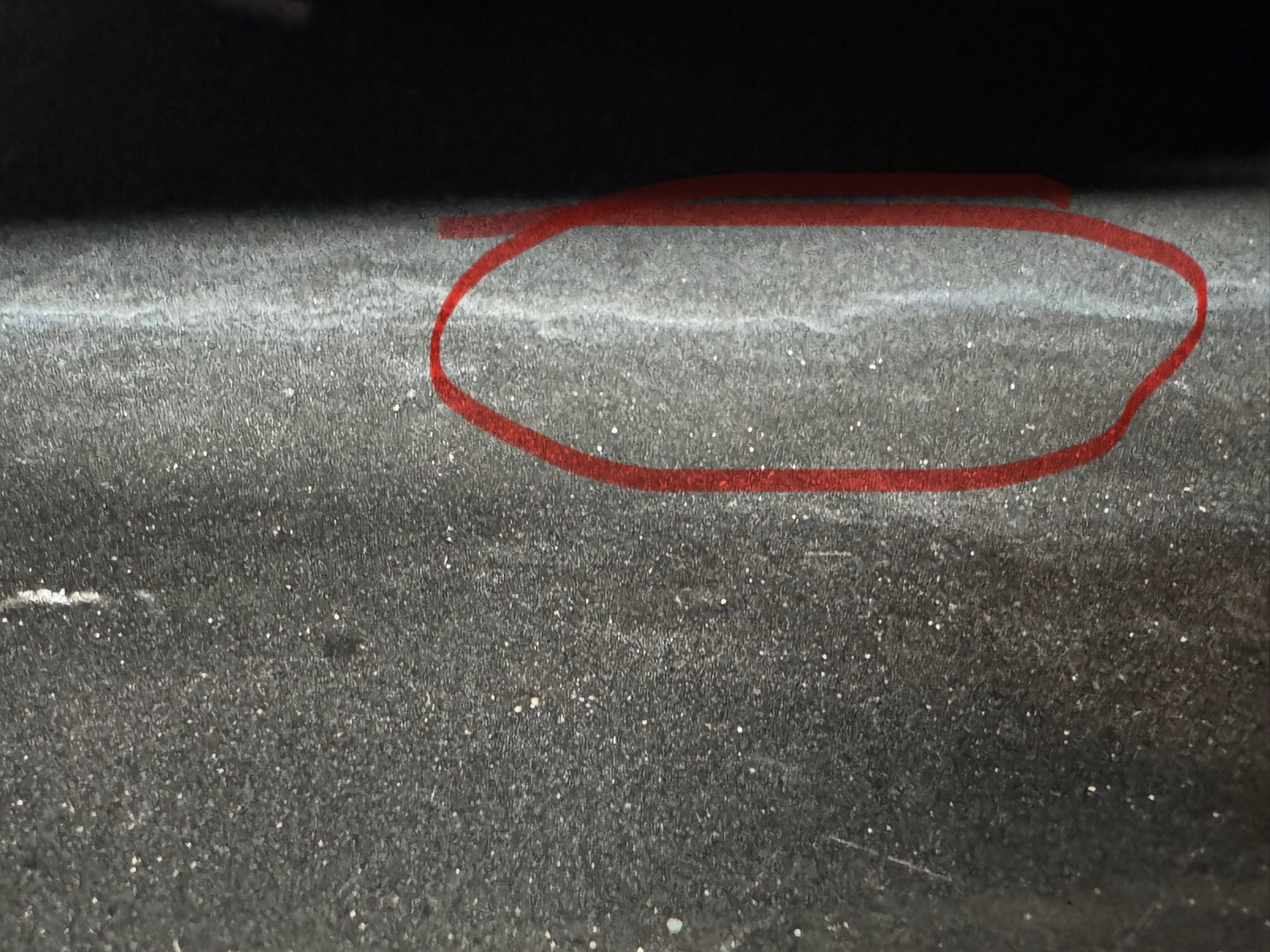

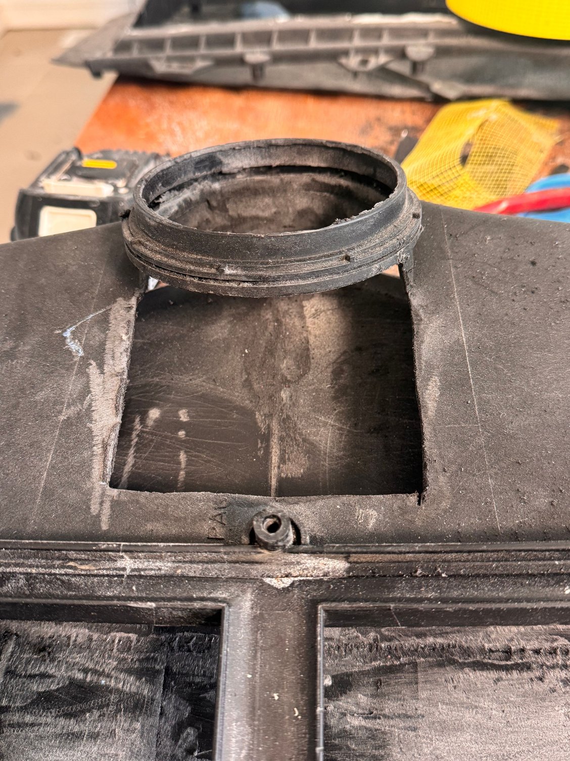

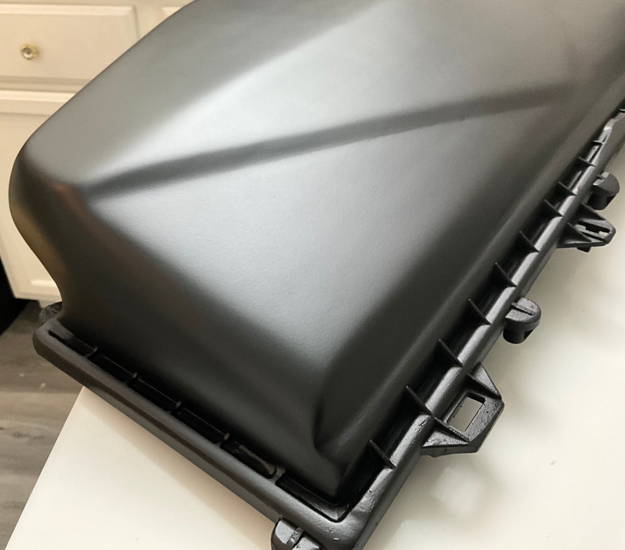

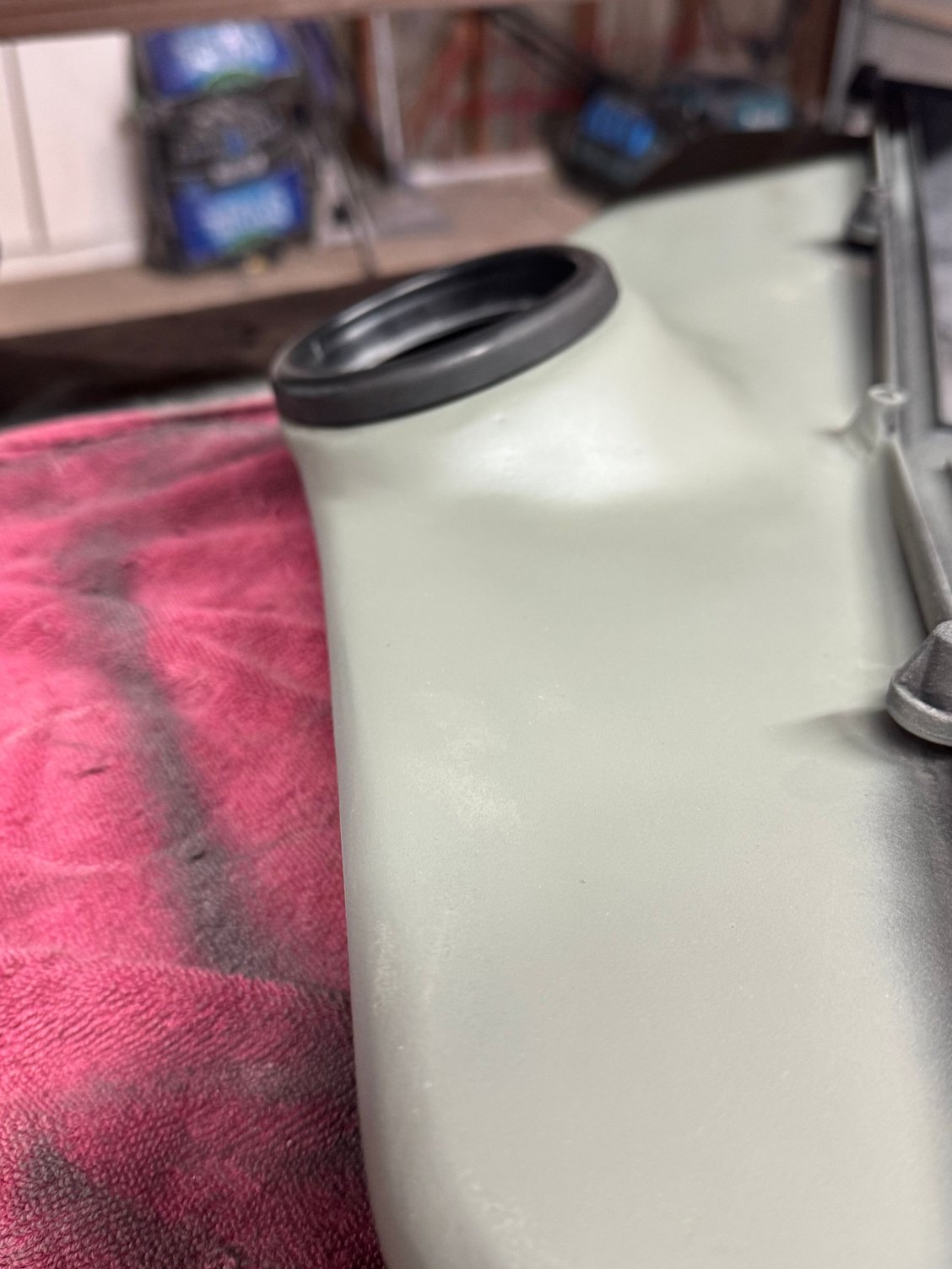

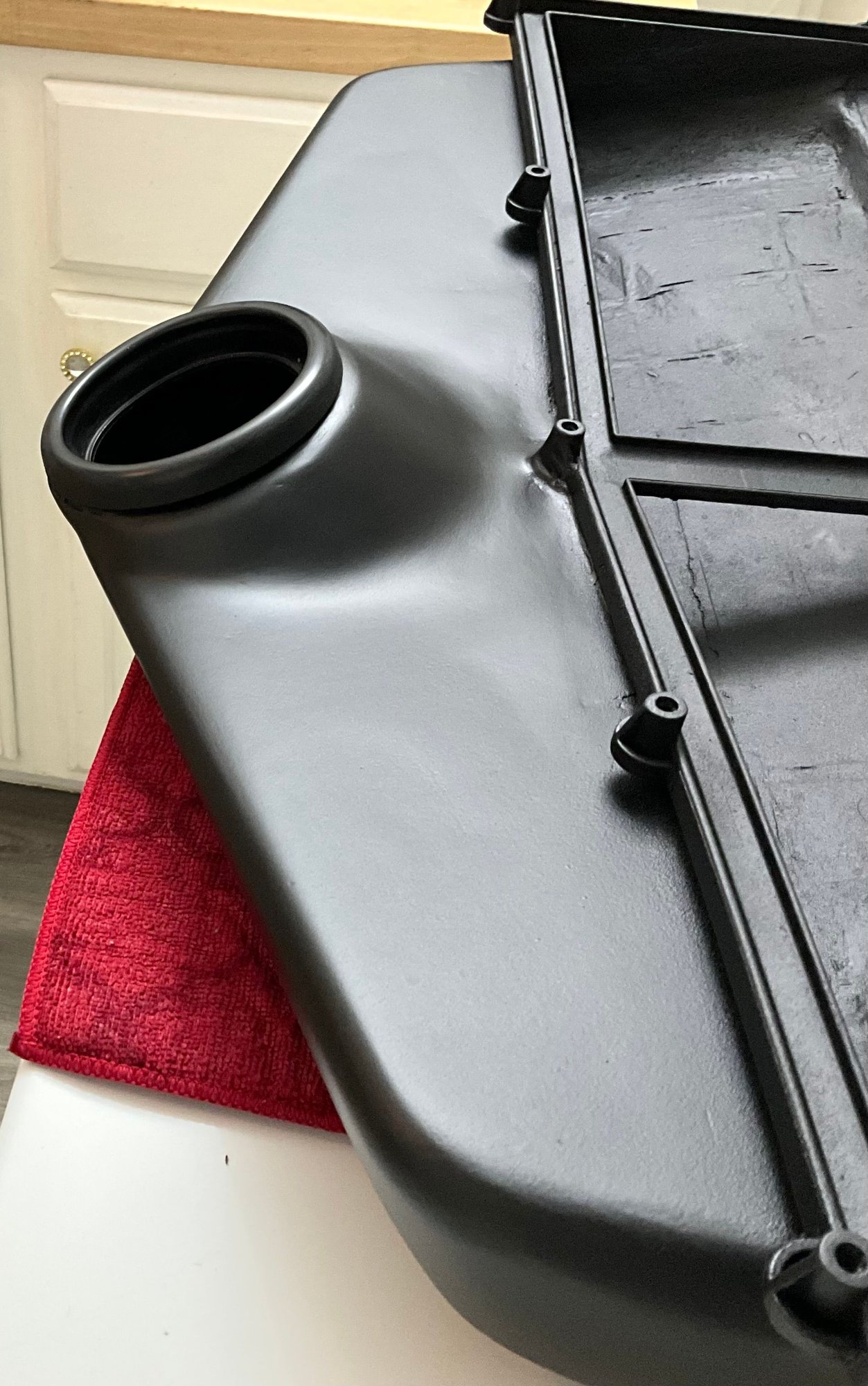

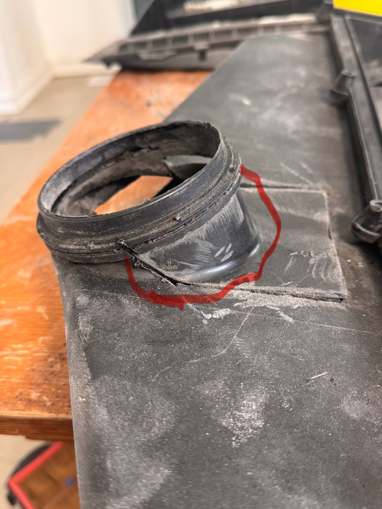

With some time on my hands (recovering from surgery) I came up with a way to stop the bottleneck our oem air boxes. The picture with the red circle shows where the bottleneck is. (Side note the pictures of the air box shows in primer and the other paint still drying…)
In the past I just raised the air box by splitting it in half. I’m still doing that but now I’m cutting off what I’m calling the THROAT. After cutting that off I raise that section so there will be a huge area for the engine to breathe.
Not an easy job for sure but it makes a great difference at half or wide open throttle. I’m also modding the middle top portion of the air box. This has that step like between the front and back of the box. Inside the box it’s like a step so I cut it off so it will connect with the back and front part. This makes the air inside travel smoother and faster as now there’s no interference in air flow.
I’m also modifying the front sides, making it more round for a little more air space/volume inside, and it looks nice out side the box..
Making the air boxes I’m still using oem plastic to weld and for structure. But now I’m also using fiberglass, I don’t like working with fiberglass but it makes the air boxes super strong all around, so it’s worth it.

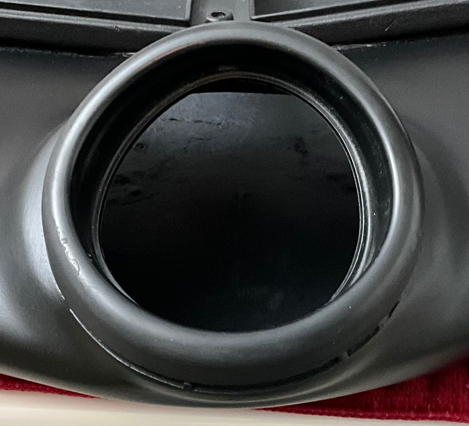

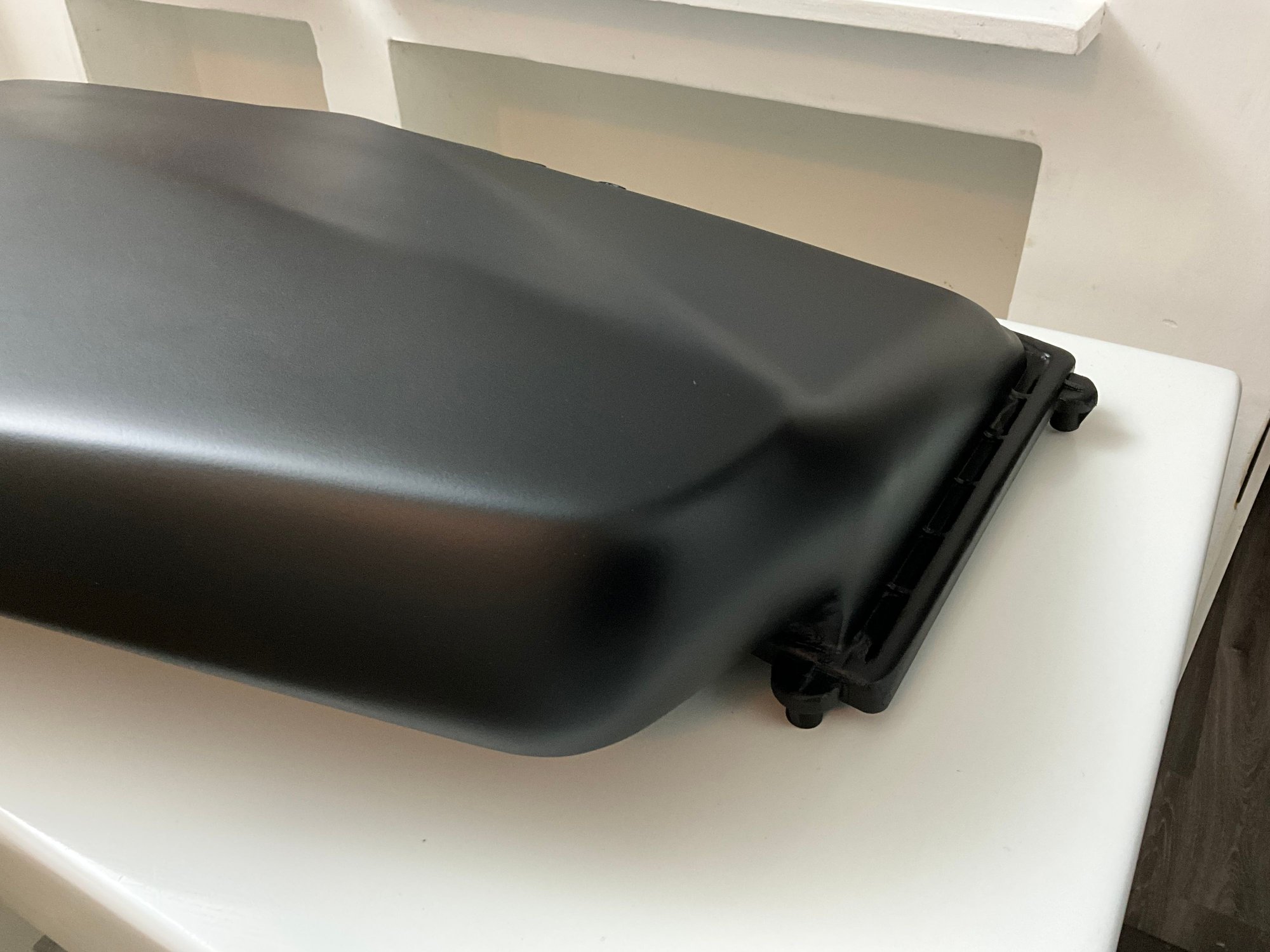

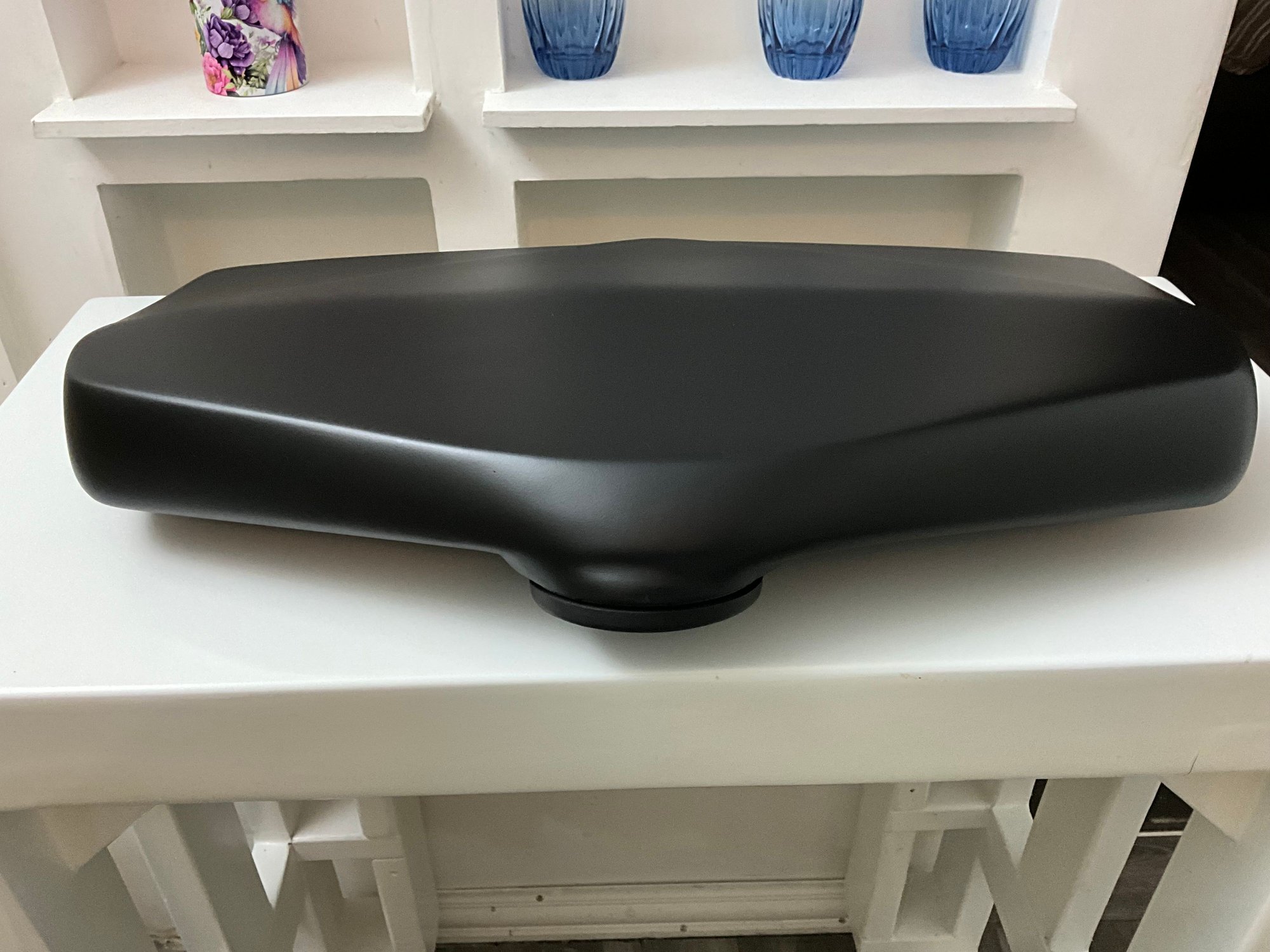

Here’s the finish product. My goal was to make it a bit different and to make the throat of the box bigger to remove the bottleneck the oem air boxes have. Try sticking your hand in your unmodified air boxes, even your child’s hand will not fit in there. So good amount of air will flow into the engine.

Interesting modification. I like the smooth almost seamless appearance of the finished product. Besides increased airflow, are there any other benefits? Like weight, or rigidity?

Thank you. Airflow and more air space inside is what I like about this box. Also it is more stronger because I use oem plastic to weld and not abs like I use to years ago. And now that I’m using fiberglass it’s much stronger than before. You won’t notice much difference in weight compared to the oem box. You will notice better throttle response at any RPM. And more torque at the low end and more HP at the high end.
