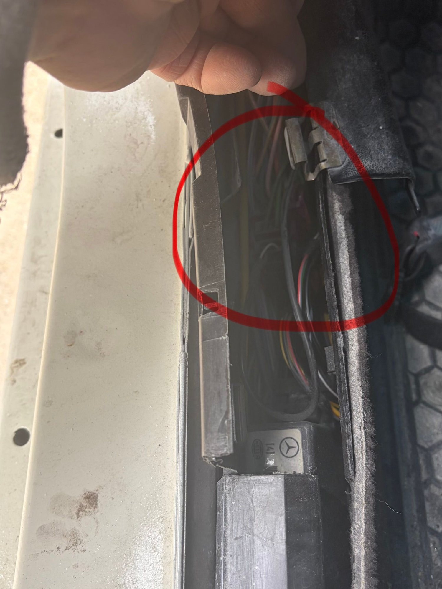

Old Mar 4, 2026 | 10:40 AM
speed43's Avatar
Joined: Feb 2010
Posts: 1,506
Likes: 130
From: Bolingbrook Illinois
1999 C43 Amg
I found the wire connectors that you just pull apart. It’s at the bottom side panel, remove that and pull aside the carpet some and unplug.
