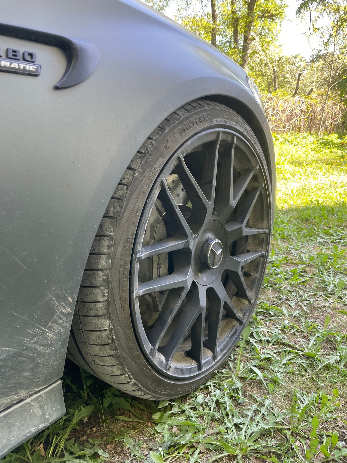

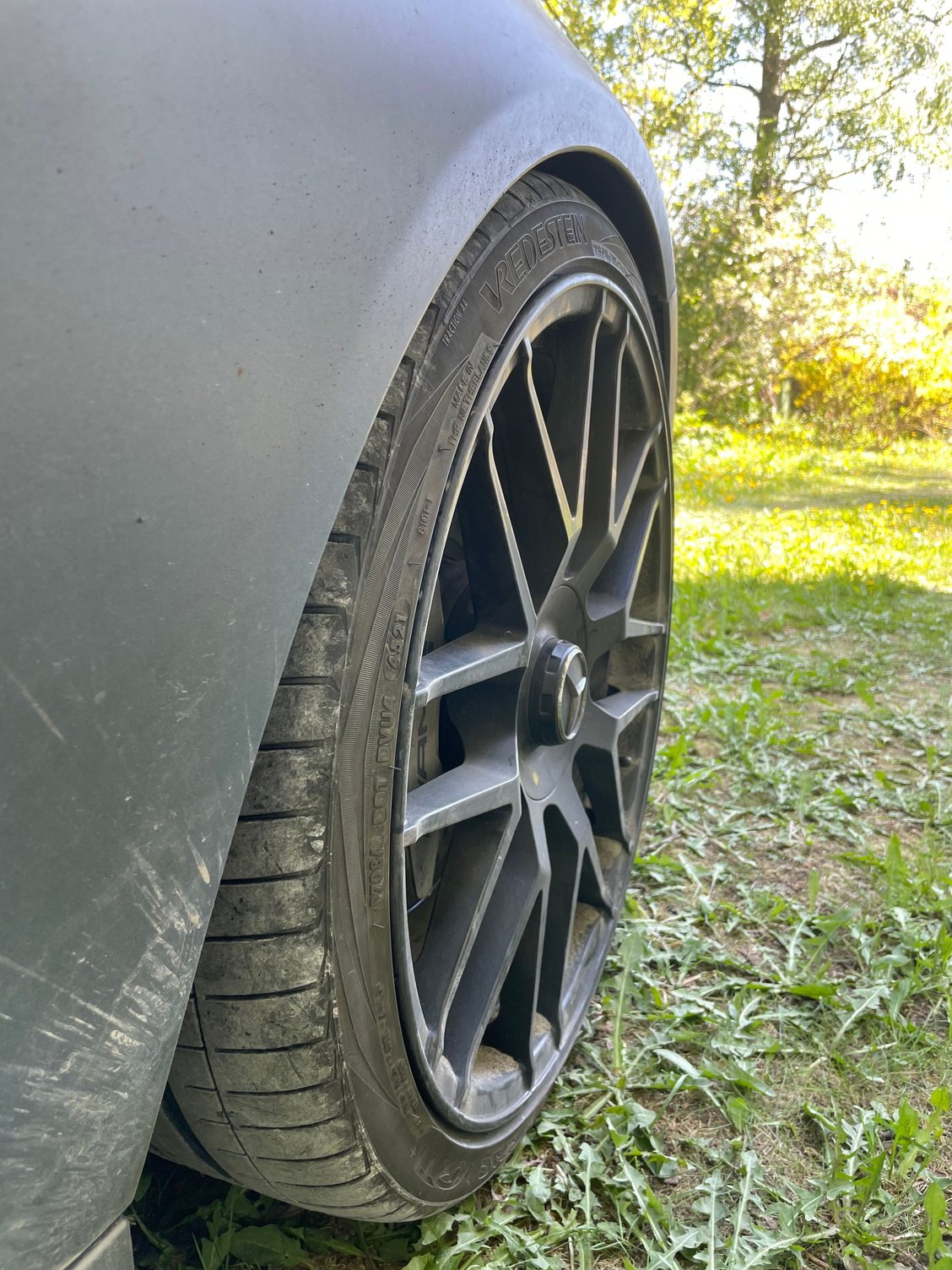

I have a bit of an issue, last time I invested time into this thread and learned all this stuff was a while ago and now I forgot and maybe someone can help me quicker than I can learn again myself.
I bought my C43 coupe with 4x8.5J R20 MAM1 GT wheels - all the same size (offset numbers on rims were hard to read, but i think they were ET45).
If I recall correctly, it had 235/35 and 255/30 tyres on them. And all wheels had 10cm spacers.
But then I noticed that all tyres were badly worn on the inside and eventually one had wires out and fully broke down and then I had to buy a new set.
I bought new Vredensteins and it seemed that for 235/35 in the front, wider 265/30 in the back would result in better geometry. So I went with those.
I was worried about the first tyres being worn, but as rims and tyres were cheap, painted horribly etc, I just presumed that seller put on already worn tyres because my R18 winter tyres didn't have any wear on the inside after 2 seasons.
Now after 2 summers with Vredensteins, I noticed extreme wear on the inside of the front tyres.
So now I now I have to get the axle aligned properly, but I also need new front tyres.
It seems that 235 is still quite stretched on those rims. I want to know if I can put wider tyres on it? With 20 inch rims, the wheels already seem very tightly fit in the fenders.
I've seen people put 245's, but I wonder if they work on my rims and offset and spacers.
And if I pick 245s, should it be 245/35 or 245/30?
Or does it even matter at all?
In terms of wear, if 235s are worn already, then with current setup I think 245 would be worse, no?
I also have shock absorbers leaking oil, which might affect the geometry. If I replace those, get axles aligned, maybe the issue is solved and I can get new tyres also 235s?

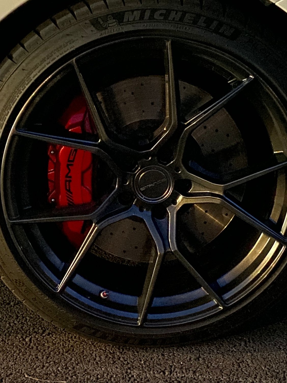

Sorry for the mega bump, are there other spacers that fit for the front for the same fitment without your modification? I didn't really follow why you landed on 12mm 24556659 front and 12mm 2455665 rear? I'm trying to get some W204 C63 multispoke rims, which are the same size as your setup, F 19x8 et 45 R 19x9 et54. So from your post, the rear is good to go with no spacer, but in order to use 40mm bolts and have one size and set of bolts for both wheels, in addition to putting 12mm spacers on the front, you mirrored it in the rear? I just want to make sure I'm buying the right spacers as I don't have access to a lathe. I obviously don't have your technical knowledge either! But the W204 multispoke rims is the closest rim to give that CLK black series 16 spoke look. I'm not lowered and am looking for conservative and problem free fitment. Thanks again for all your research, incredible gift to the community.
Originally Posted by Star4life
update to the thread. i finally have my ideal fitment. No rubbing at all or even close to it, and it looks killer on the stock ride height. about 1.5-2 finger gap both front and rear.
I used machined 24556659 (12mm spacer) on the front which fit perfect. And I used the 2455665 on the rear which fit perfect with no modification
So final specs are:
Front:
235/40/ZR19 Michelin Pilot Sport 4s on W204 OEM Forged C63 Black Series wheels 19x8 et 45 with a 12mm 24556659 spacer modified per above lathe pics.
Rear:
265/35/ZR19 Michelin Pilot Sport 4s on W204 OEM Forged C63 Black Series wheels 19x9 et54 with a 12mm 2455665 spacer.

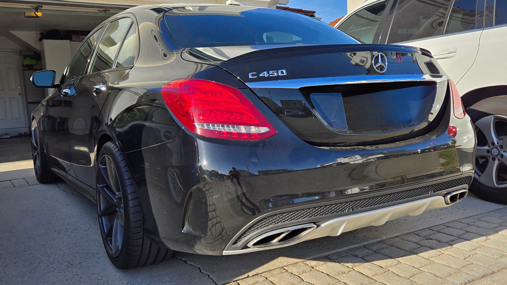

Originally Posted by c43PDX
dude thank you so much, I think i'm a bit lower than you so getting 4mm more with that stretch should be perfect. I think I'm going to pull the trigger on the Vertini RFS1.3 flow forged in silver on my car here
What suspension set up were you running here? Also, what model wheels are these? OEM? Thanks in advance!!

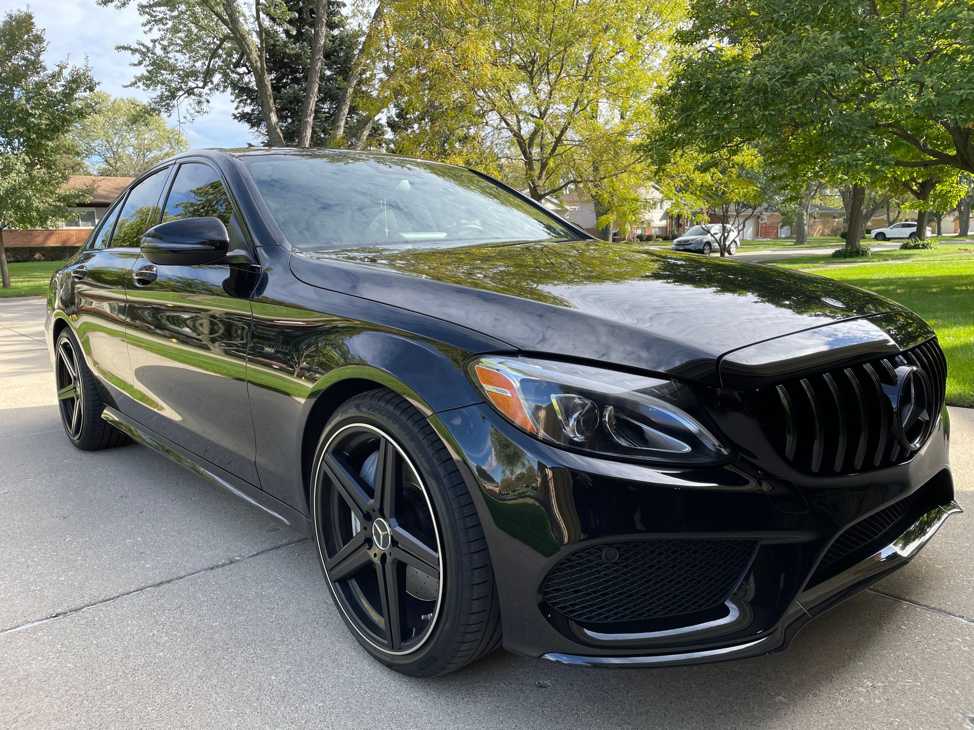

I am just a C43 driver - I have no affiliation with any seller.
I bent my OEM 19" wheels 3 times in the first year of ownership. I went through the same thing- trying to find wheels for my C43 Coupe. The C43 has a hard-to-find offset and lug pattern. Wheel Designers actually stocks blank wheels and they machine the offset, bore, and lug pattern to fit your vehicle. I ordered a set of wheels from them back in April and they have been great. Perfect fitment and no adapters needed. I did 19x8.5+32 front and 19x9.5+45 rear on OEM size tires, SF03, gloss black tinted face.
Old Oct 4, 2024 | 03:29 PM

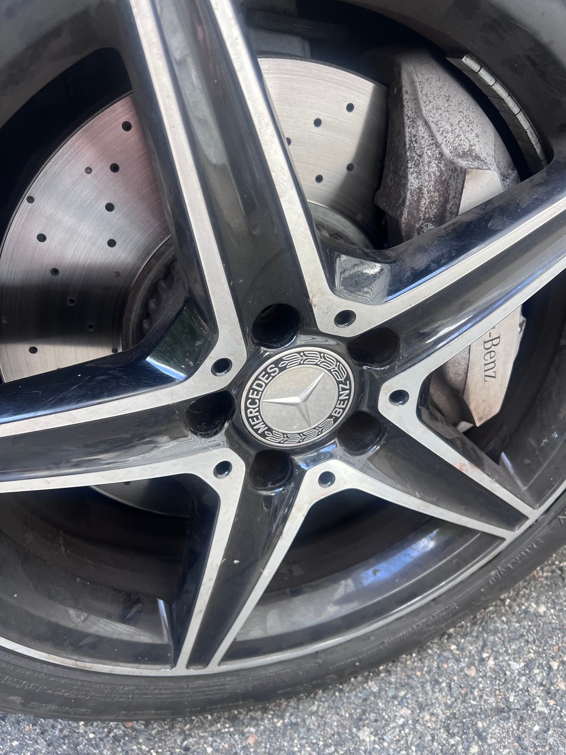

I need to replace a front driver’s side wheel on my 2016 C450.
Will the below fit 2016 C450 AMG front? Current rim has 7.5j18 marking. Also is this the correct color? I’m having trouble trying to see if it is.
https://www.ebay.com/itm/30570695476...mis&media=COPY
Thank you in advance for any help. I just don’t want to ship the wrong one.
Old Oct 17, 2024 | 05:56 AM
  #972
SweDlux's Avatar
Joined: Feb 2019
Posts: 14
From: Sweden
AMG C43 Wagon 2017
It has the wrong offset.
From the ad on ebay:
"Offset: Front: ET 44mm *vital spec for proper fitment"
This type of front wheel on a C450/C43 should have these specs:
7,5 Jx18 ET33
(Part Number: A2054014800 - if it's gloss black)

A long wheel journey
After having my 2016 Mercedes C450 AMG for nearly 10 years, I finally replaced all my wheels after having two very expensive AMG front wheels crack on me. This forum thread helped tremendously in making me decide on the right size wheels and tires to get. My goal was to have the least wheel well gap as possible and to have tires as flush to the fenders as possible. I wanted to keep the 19" diameter but widen both wheels and tires for better grip and handling. I used all the notes from the messages found here and calculated the different settings using an online wheel and tire sizer (https://www.wheel-size.com/) to analyze the best fit. I decided to go with Niche Misano staggered wheels with 19"x8.5" 34mm offset fronts and 19"x9.5" 50mm offset rears since I like the look of split spoke wheels commonly found on Porsches. I also decided on Michelin Pilot Sport 4 S (PS4S) tires with 235/40R19 fronts and 265/35R19 rears. I believe that Michelins perform better are more square at the corners than rounded Continental tires. Going with 20" wheels and wider lower profile tires would have looked nicer but I prefer comfort and performance over esthetics. Had I just went with the wheel and tire recommendations from companies like Fitment Industries or America's Tire, it would have been far from ideal. Using the website online wheel recommendations, it said I had to get a 25mm offset for fronts and 35mm offsets for rears which didn't make much sense since the offsets for the stock AMG wheels are 33mm for fronts and 52mm for rears. Based on my research, I concluded that 28mm offsets for the fronts and 38mm offsets for the rears were the maximum offsets one should use when using wider rims and tires on 19" wheels for a C450/C43 AMG. To come close to those ideal offsets, I used a 5mm wheel spacers on the front (34mm-5mm=29mm) and 12mm spacers on the rear (50mm-12mm=38mm). After using a leveling ruler to check how flush the wheels were to the fender, it showed both front/rear wheels being flush with fenders down to the middle of the sidewalls which means there should be plenty of clearance from top half of sidewall to the fender to avoid scrubbing. There should be more fender clearance once car is lowered in the future due to slight negative camber. See end results from pictures below (sorry for a dirty car, lol) and let me know what you think.

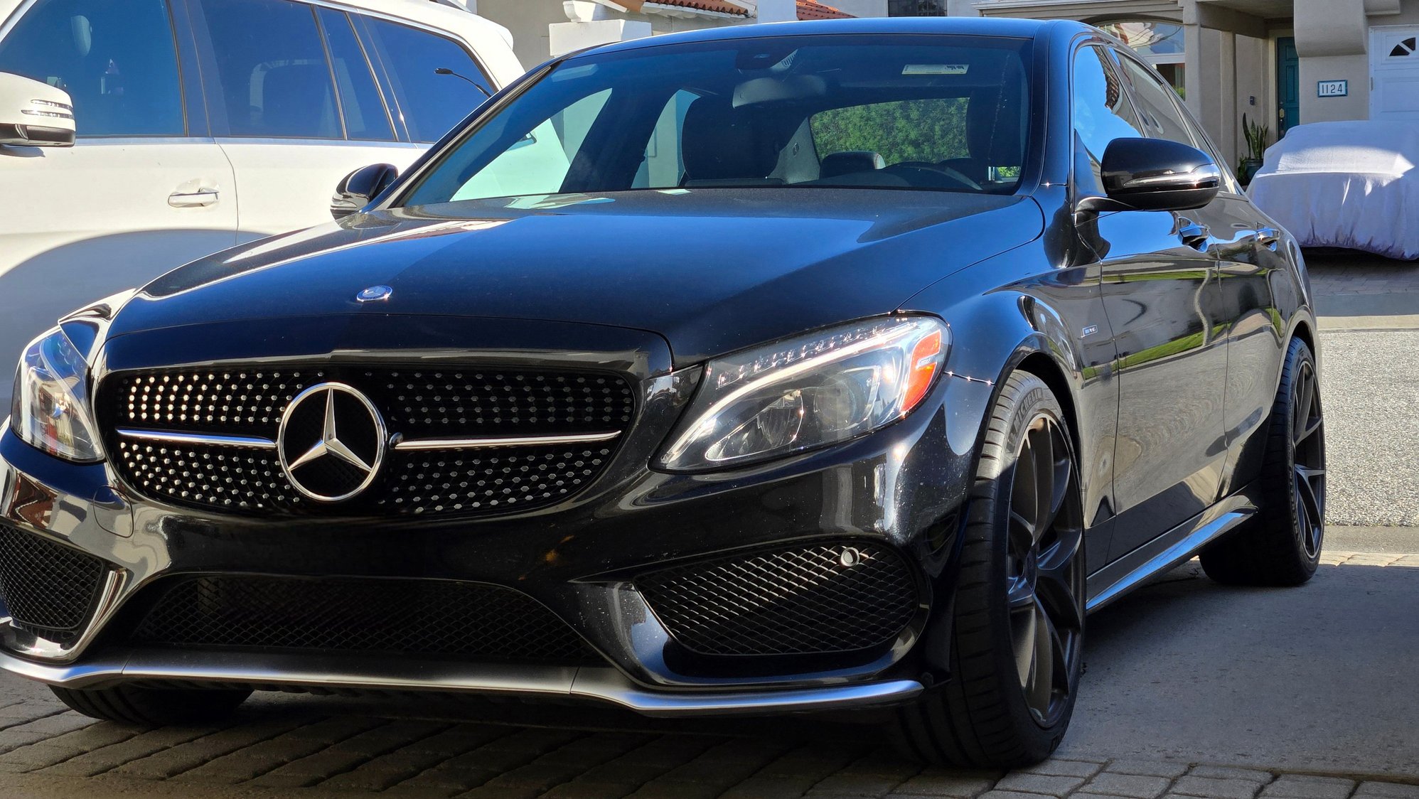

Fronts: Niche Misano 19
Fronts: Niche Misano 19"x8.5" 29mm effective offset with 5mm spacers, Michelin PS4S 235/40R19
Rears: Niche Misano 19
Rears: Niche Misano 19"x9.5" 38mm effective offset with 12mm spacers, Michelin PS4S 265/35R19
Leveling ruler showed both front/rear wheels were flush with fenders down to middle of sidewall. There should be more fender clearance once car is lowered in the future due to slight negative camber.

Do you have a shot of the side of the vehicle for more clear pictures of the wheels : )
