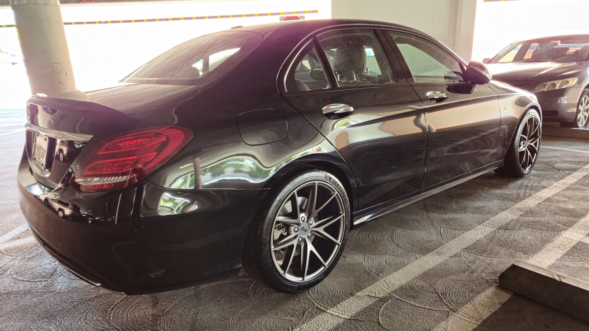

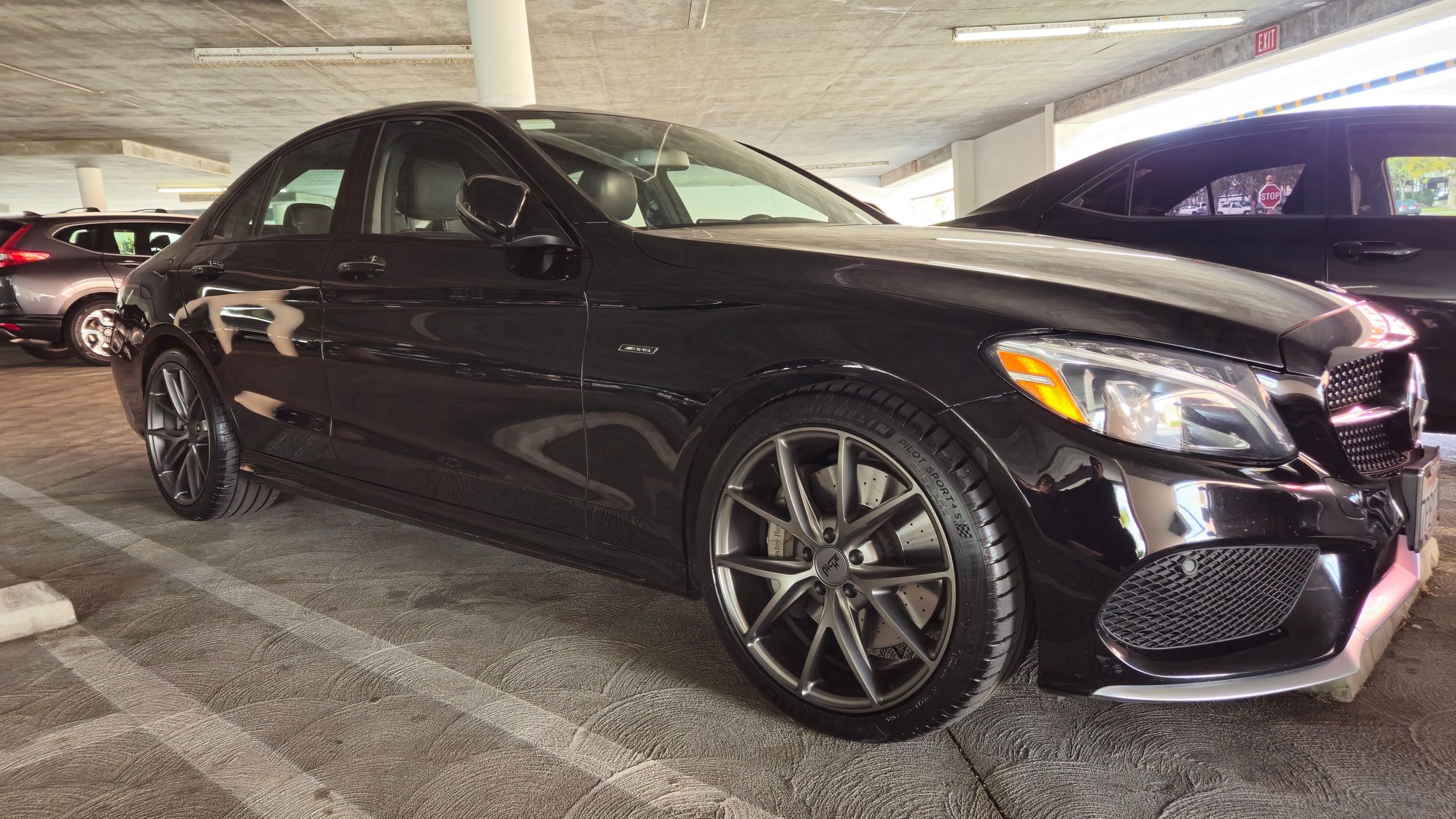

Do you have a shot of the side of the vehicle for more clear pictures of the wheels : )
This was before rear wheel spacers.

Although wheel preferences varies by each individual but I personally think these wheels look good.

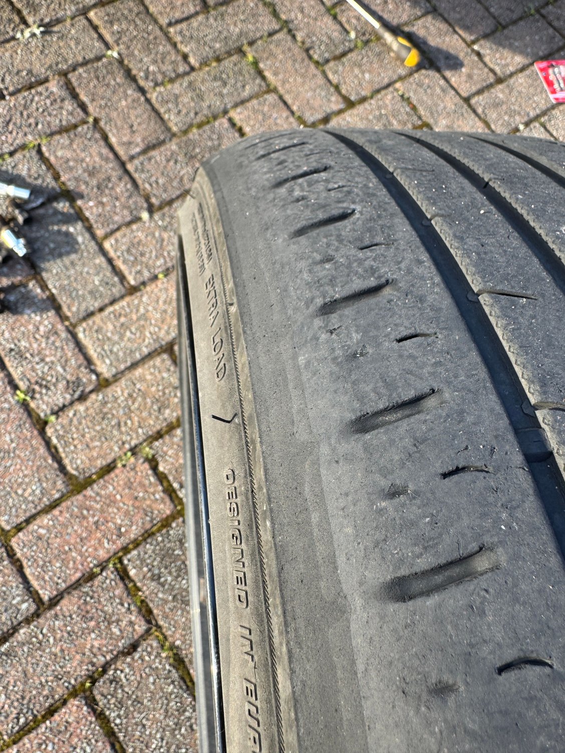

oe was 225/45 front and 245/40 rear and I cracked ? A rear rim early on
quite happy with it. 45 appears to be the minimum survivable sidewall in the nyc metro area. Car sticks well and of course no issue with equal sizes.
