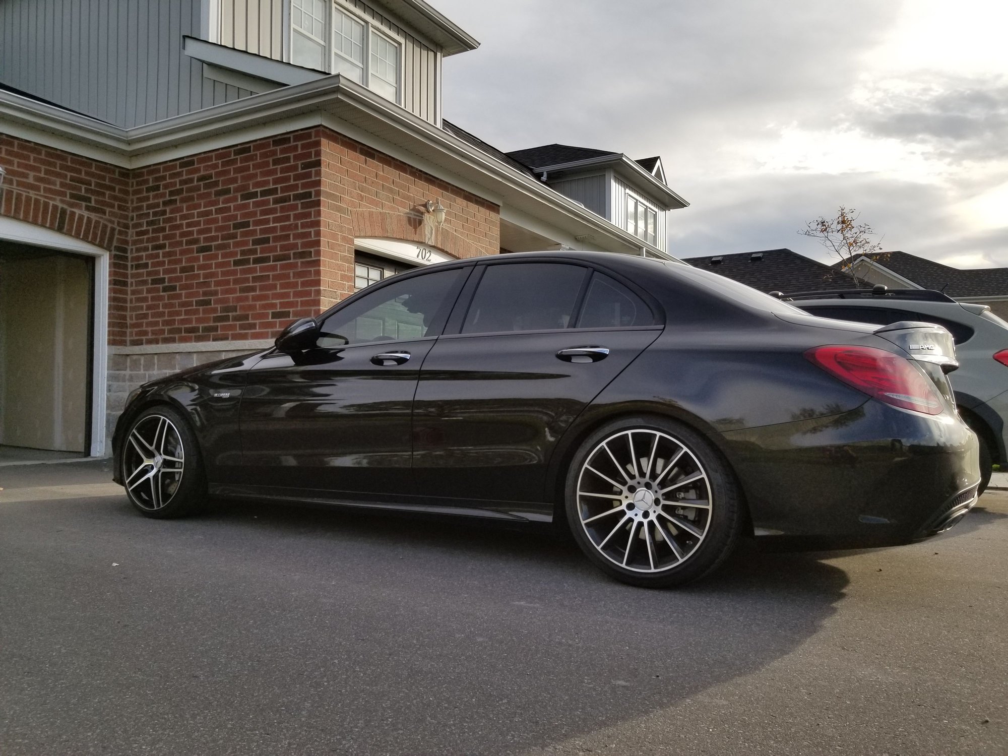

My wheels are Velos Designwerks S1s.

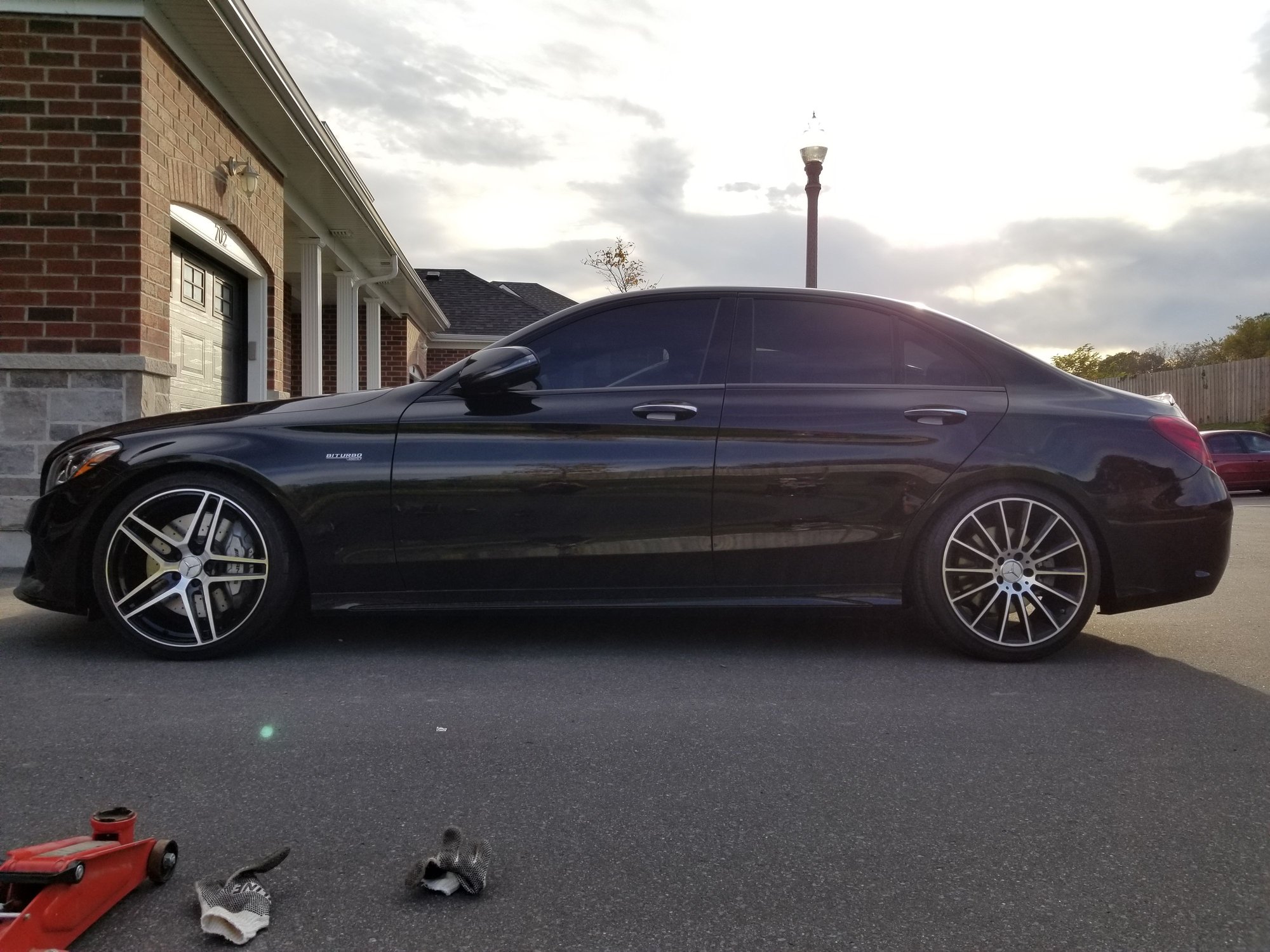

Halfway through the wheel swap 😊

Exceptional looking wheel, looks great on your car!

Very handsome wheel. It looks like the AMG split forged wheel.

Stock wheels you need 15mm up front, 20mm rear, lowered H&R to give the perfect fit.
These on the other hand are off my CLA which makes things a little more challenging. They are 19" x 8.5 +40 offset
which means I have 20mm less clearance on the inside and extend 6mm further out than stock in the front. 15mm spacer they
fit fine but poke out about 5mm further than ideal so I'm just waiting for a set of 10mm spacers to get here to test as I
think I will have room to clear as I believe there is about 12mm space from the control arm to play with. It's close but
will give a nice flush look if it works.
For the rear, I have the same size wheels so fits fine, just going to add a 20mm spacer which gives me 26mm further
out than stock which should be just about perfect with it lowered. If it's too much, I'll use my 15mm spacers instead.
