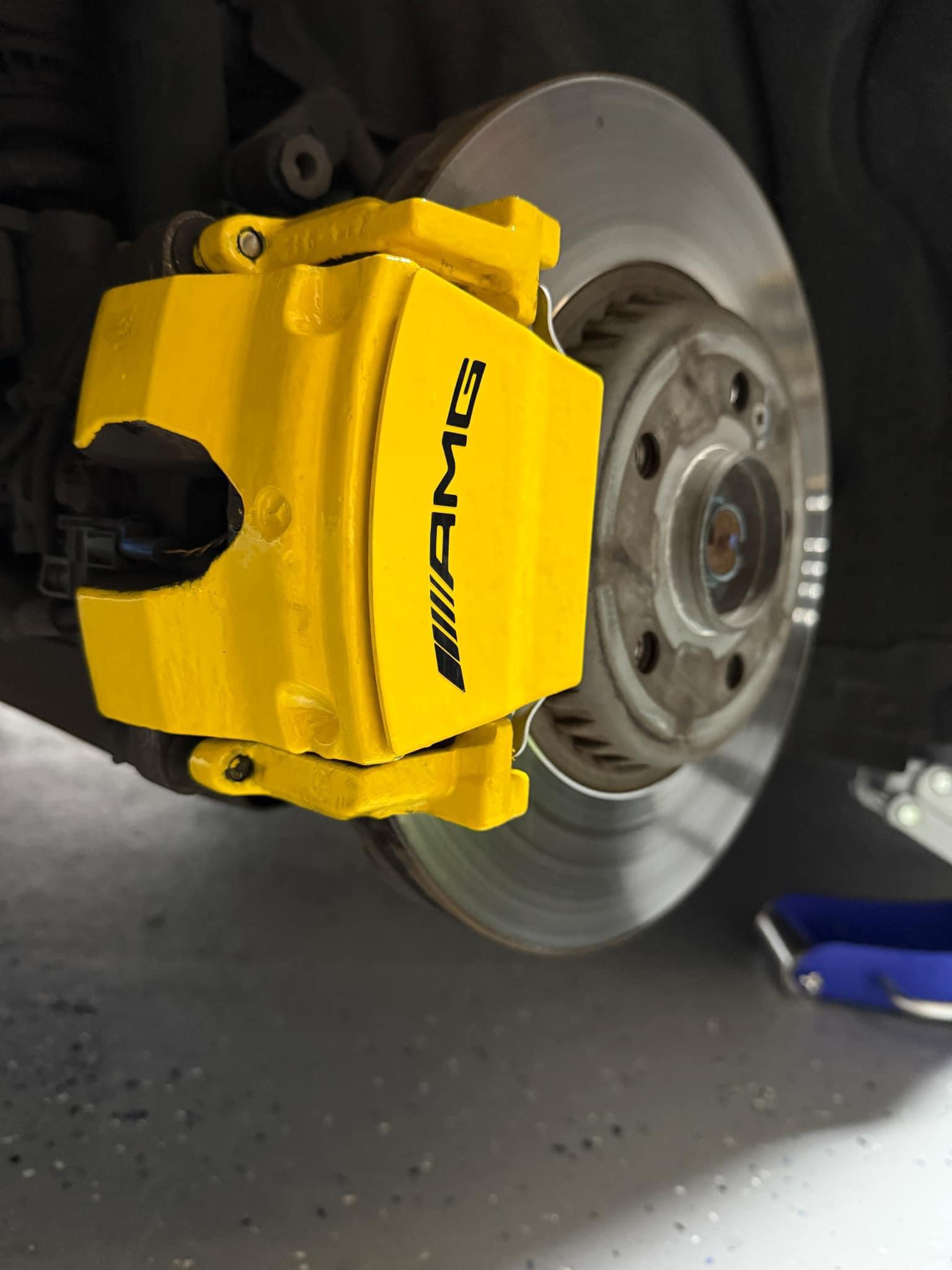

Hey guys. Just wanted to let you know new stock is currently available and ready to ship of the rear brake caliper covers. PM or email H3NRYH@gmail.com for discounted price.
Improve the look of the sad OEM rear brakes. Complete the look to match the front AMG calipers.
Also wanted to share a photo from another owner who's done a great job with the covers in yellow.
